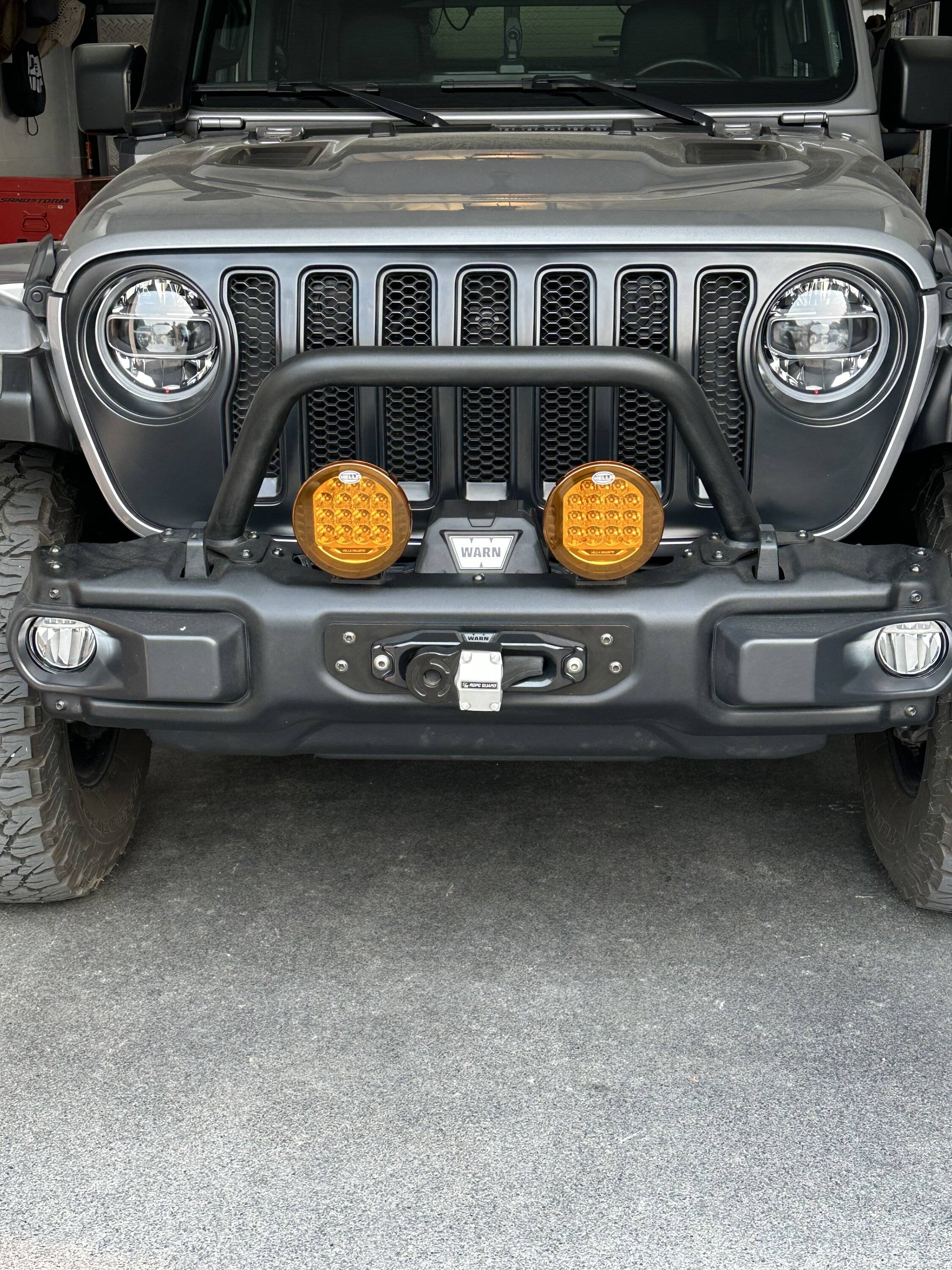

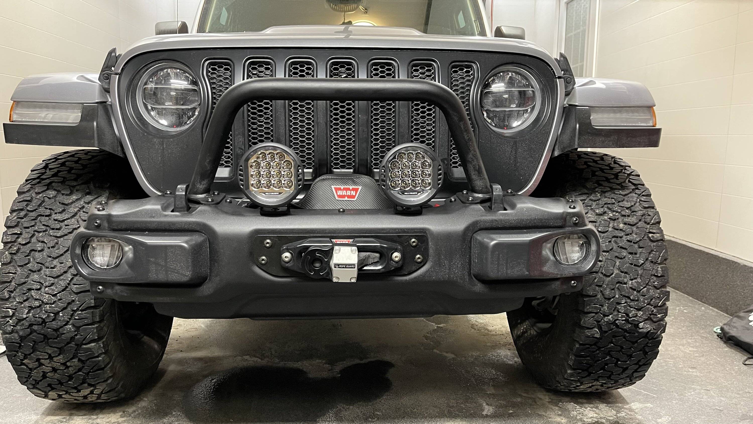

No cover, as it is already covered by the OEM steel bumper, AEV hook isolator and hook pulled to that, Fishbone flip-up license plate holder in front.
Edit: Flip-up holder because the original plate mount had it hanging below the bumper, and I have destroyed too many plates hanging there so wanted it higher. The Tuffy holder I first bought would not clear the hook with the isolator so I got a Fishbone and it does.

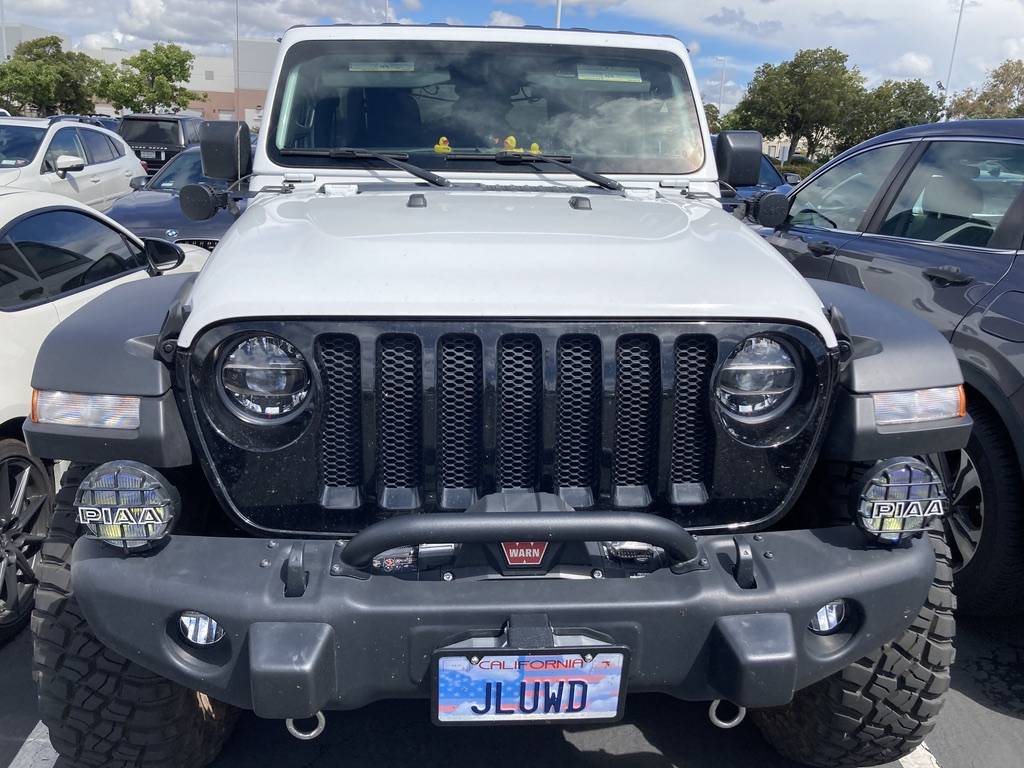

winch doesn't get covered; it fits in too tightly in the Mopar Performance Off-road Bumper to be able to get a cover in there. but where i live/play it's not exposed to a lot of road grime like it might see if we spent more time in other parts of the world.
that said, since the fit is so snug, the (synthetic) line is barely visible and not exposed to a lot of sun.
a Fishbone license plate holder covers the Factor 55 Ultrahook (which is kept snug as it has it's own rubber landing pads to prevent scratches to the fairlead) and protects the little bit of line that's exposed on the hook from sun and other damage.
side note; were i to do it all again, i'd likely skip the hook entirely and just use a loop on the end and a fairlead that had a 'parking' post on it, and stick with entirely soft-tech.
