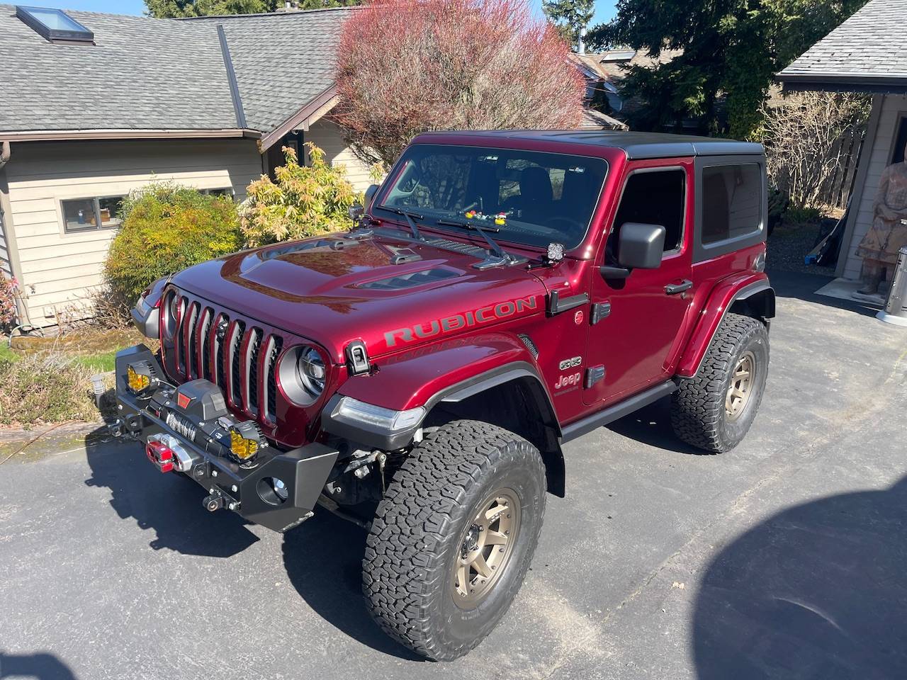

I replaced my plastic OEM bumper with Rh4x4 Aluminum Patriot mid width and a Warn winch to keep the weight down. Also requested a bull bar delete so it didn’t block the trail cam.

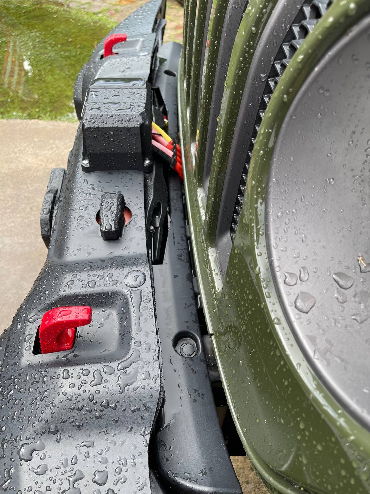

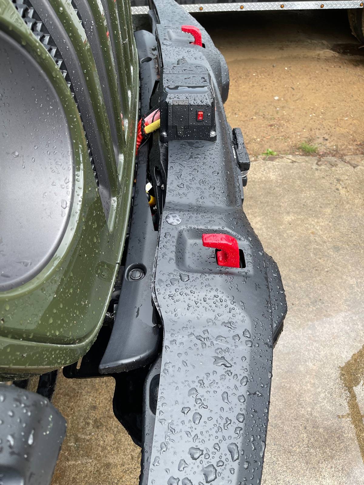

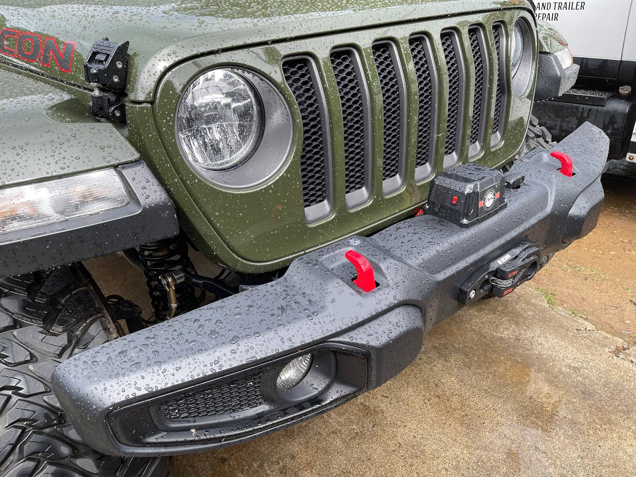

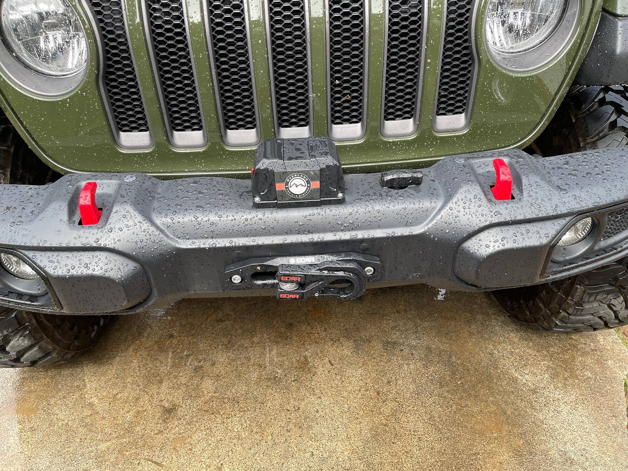

Not sure if you’re mechanically inclined or not so this may or may not be an option for you but you can install a heavy duty winch plate and modify that stock bumper to do what you need it to do and meet all the laws where you’re at. I’m in GA and we basically live in the land of the free when it comes to bumpers, tire protrusion, lift height, beadlocks, no doors, etc. LOL! I modified mine simply because I didn’t particularly want to spend money on that when I could spend it on other mods instead. Took a good day to mock it up and make all the little modifications it took to get it how I was happiest with it. Only thing I’ve yet to do is warm up the top plastic cover with my heat gun and get the slight hump out on the passenger side of my winch control box. I installed a 12K SKAR Overland Vehicle Systems winch which fit nicely and only part you really see is the fair lead and the winch control box.
Jeep Wrangler JL Bumper Questions IMG_4509
Jeep Wrangler JL Bumper Questions IMG_4510
Jeep Wrangler JL Bumper Questions IMG_4508
Jeep Wrangler JL Bumper Questions IMG_4511

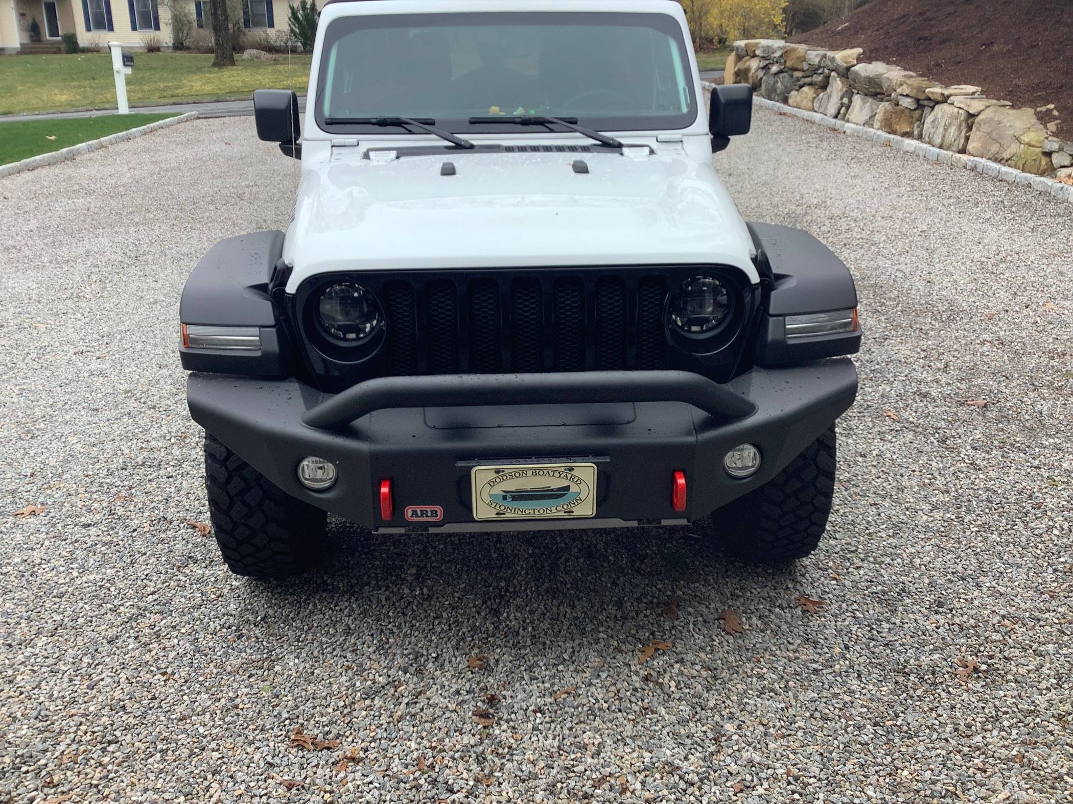

ARB. No sag in the front. But no winch either.
