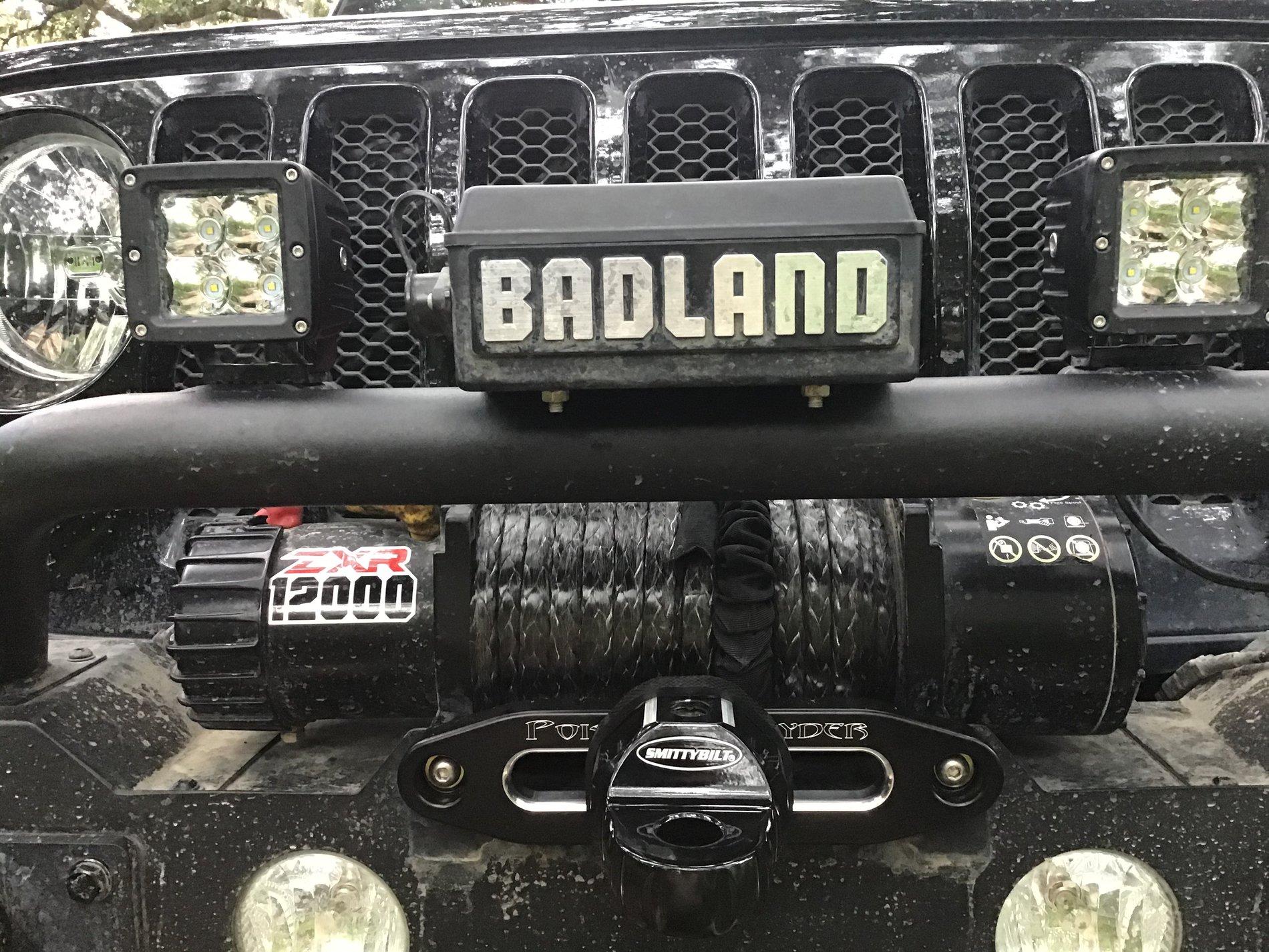

Good people, I reinstalled the two bars as strongly advised. I did not have to pull line to get them back on. Again, thanks!
Note to self: do more research first, and don’t drink Southern Comfort while wrenching on my Jeep ;)

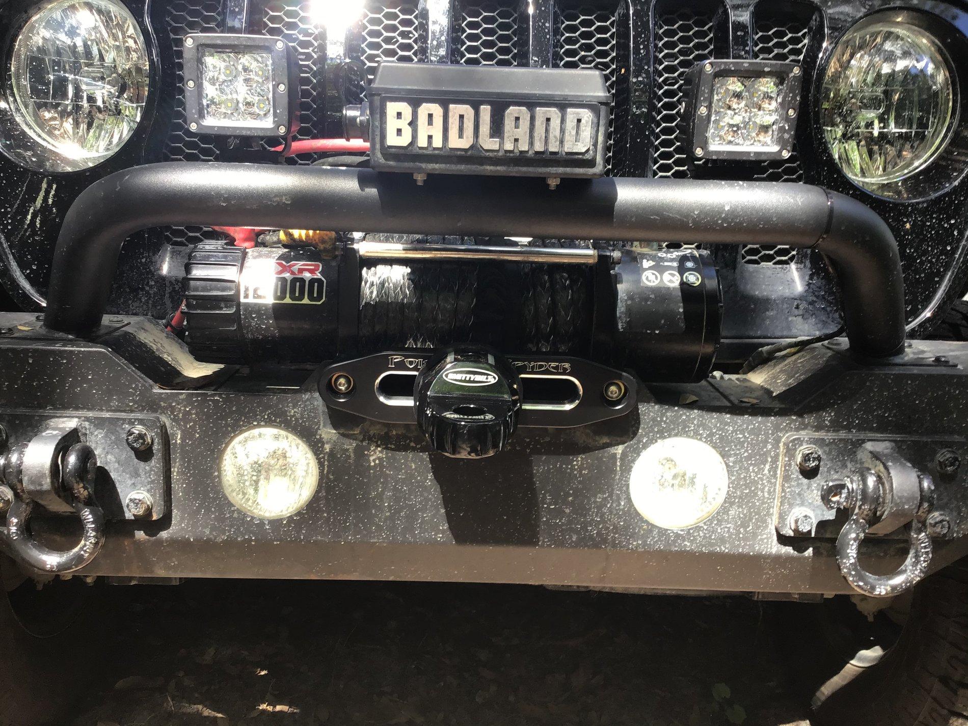

This should work for any winch. I have a Badland ZXR 12000 pound winch. I decided to replace the steel cable with synthetic - 20,000+-rated, half inch in diameter - WAY over-rated for capacity of this winch.
I easily removed all of the bars above the winch spindle, so there are no capacity limitations. I took the solenoid box from the mount on the winch and mounted it on the bully bar. This eliminated the restrictions to winch capacity. I simply opened up the solenoid box, drilled through it into the bully bar, and mounted it with larger diameter sheet metal screws. It is solid. I moisture-sealed all entries into the solenoid box.
I was able to increase winch line capacity dramatically. This should work for all winches. With too much SoCo in my veins, anyone should be able to do this ;)

Kluk, thank you brother. In case you didn’t read past my first post, it was gently pointed out to me that I was an idiot for removing the two top bars, which would cause the winch to fly apart in pieces under load. I reinstalled those two bars.

If anyone is interested, here is the link to the rope I purchased on Amazon. It comes in two colors, various lengths, and two diameters.
Clearly 82’ of 0.5” rope fits the Badland ZXR 12000 lb winch - barely. With the tensioner bar removed - which is useless in my opinion - the rope does not bind under the two structural bars.
The rope is rated at 25300 pounds. Assuming that is incorrect and it’s less in pragmatic applications, I feel it will probably still exceed the winch capacity for pull, and hopefully will last longer, safely.
If I screwed up this choice too, please hit me with it!

See pic below. Should I have any concerns with the solenoid box mounted on the bull bar? I always pick a line where I’m not blasting through heavy branches at that level.
