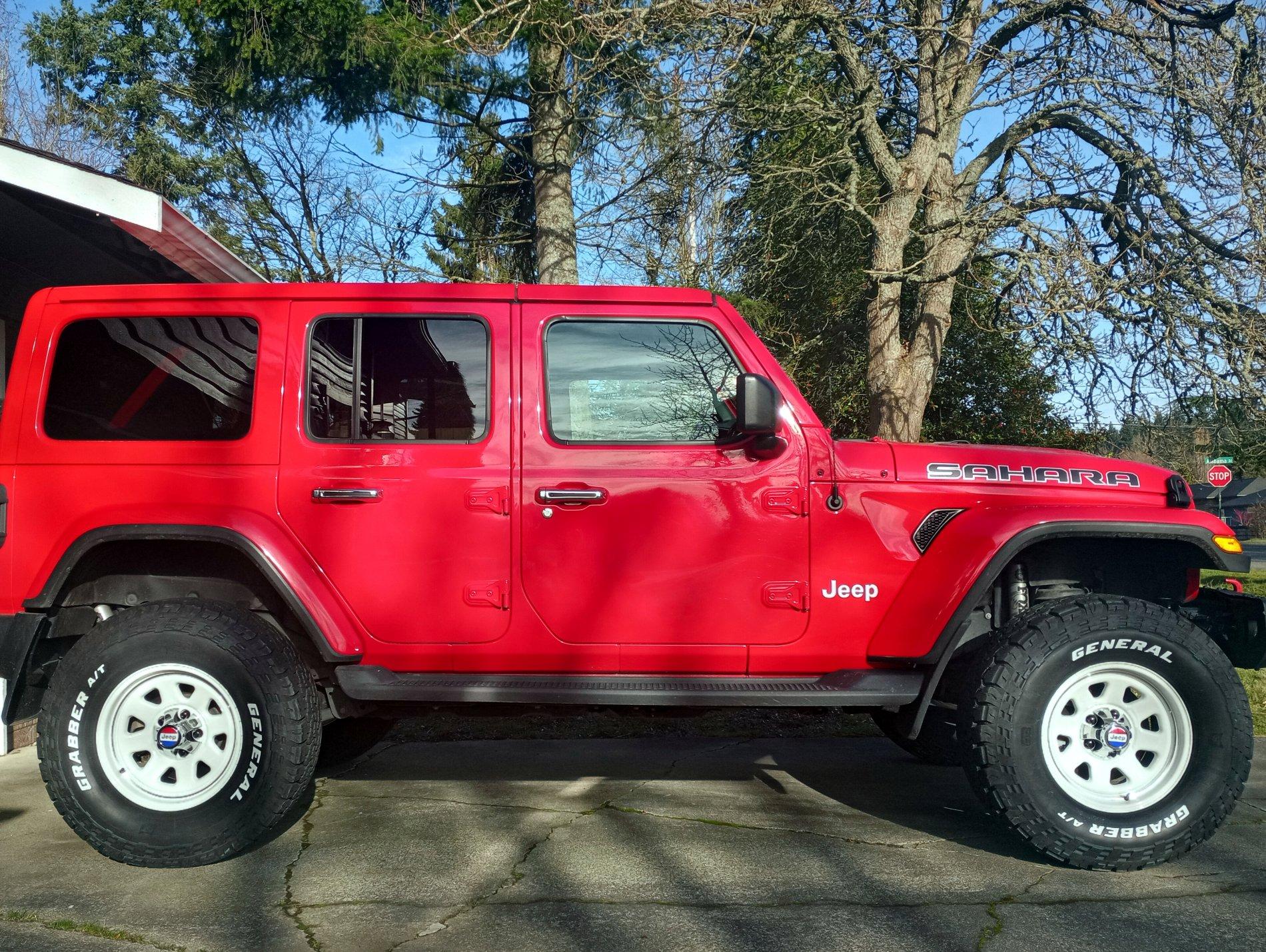

I took my sweet time modding my Sahara, too. And I’m glad I did. These Jeeps are so expensive now, I want to enjoy every minute of it. Even driving it in stock form.
Mine came with Selec-Trac and LSD. A year ago I added Katzkin leather seats and Mopar LEDs. Recently I added a Mopar steel bumper, Mopar front skid plate, Mopar 2-inch lift, tailgate reinforcement, Smittybilt oversized spare adapter, Quadratec CJ Retro alloy wheels and 35-inch Generals ATs.
I try to be deliberate with my mods; I am very happy with how it drives.
I’ll go looking for some snow this weekend to see how it does.
Jeep Wrangler JL Mod suggestions? 820C96A5-916D-47DA-8104-2F234C0DAAD1
If I were in your shoes, I’d consider a lift, shed the spacers, keep the OE wheels and mount some 285/75R18 ATs on it. I love the look of “pizza cutters” on a Jeep.
This is what 285/75R18 ATs look like

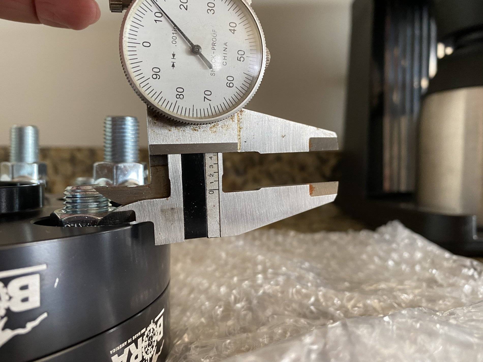

I’m reviving this to see if you can clarify something for me regarding your spacers. I got confused from something your posts. I am considering Bora spacers too and want to keep them as small as possible to have my wheels clear the suspension components yet minimize poke. I have OEM Mopar wheels that have the “pockets” on the mounting faces that will allow the wheel studs to extend past the face of the spacer without interference. So my question is, are your Bora spacers 3/4” or 1”, and is my thinking correct that the Mopar wheel pockets accommodate the amount of stud that pokes past the wheel spacer face? Thanks!
My spacers are 1” and the pockets in the back of the wheel hub area are roughly .750” deep for my Rubicon upgrade wheels. These are factory spec studs according to the salesman so stacking them like this should be an accurate representation with just over .400” protrusion.
Thank you. How do you asses the quality of the Bora spacers? I would like .75” spacers but I’m not sure I want to cut it so close, that would be about 5/8” protruding into a space of roughly 3/4”. I may have to opt for the same 1” ones you got to be safe. It’s only an extra 1/4”, right?
That’s what I would do. Go with the 1” version. I didn’t have my dial caliper handy so the wheel pocket measurement was done “precisely” with a tape measure. lol The pocket is a little concave so there may be a bit more room considering the tape measure end is flat. I don’t think it’s worth chasing though.
This is my first set of hubcentric wheel spacers. So with that in mind, from my machining experience, I think they look great and are quality pieces. I also like that they aren’t some loud color that won’t match anything.
Done. Thanks. Now I have to get rid of the set of 1.75” Synergy ones I just impulse purchased when I knew that’s not what I really wanted. :facepalm:

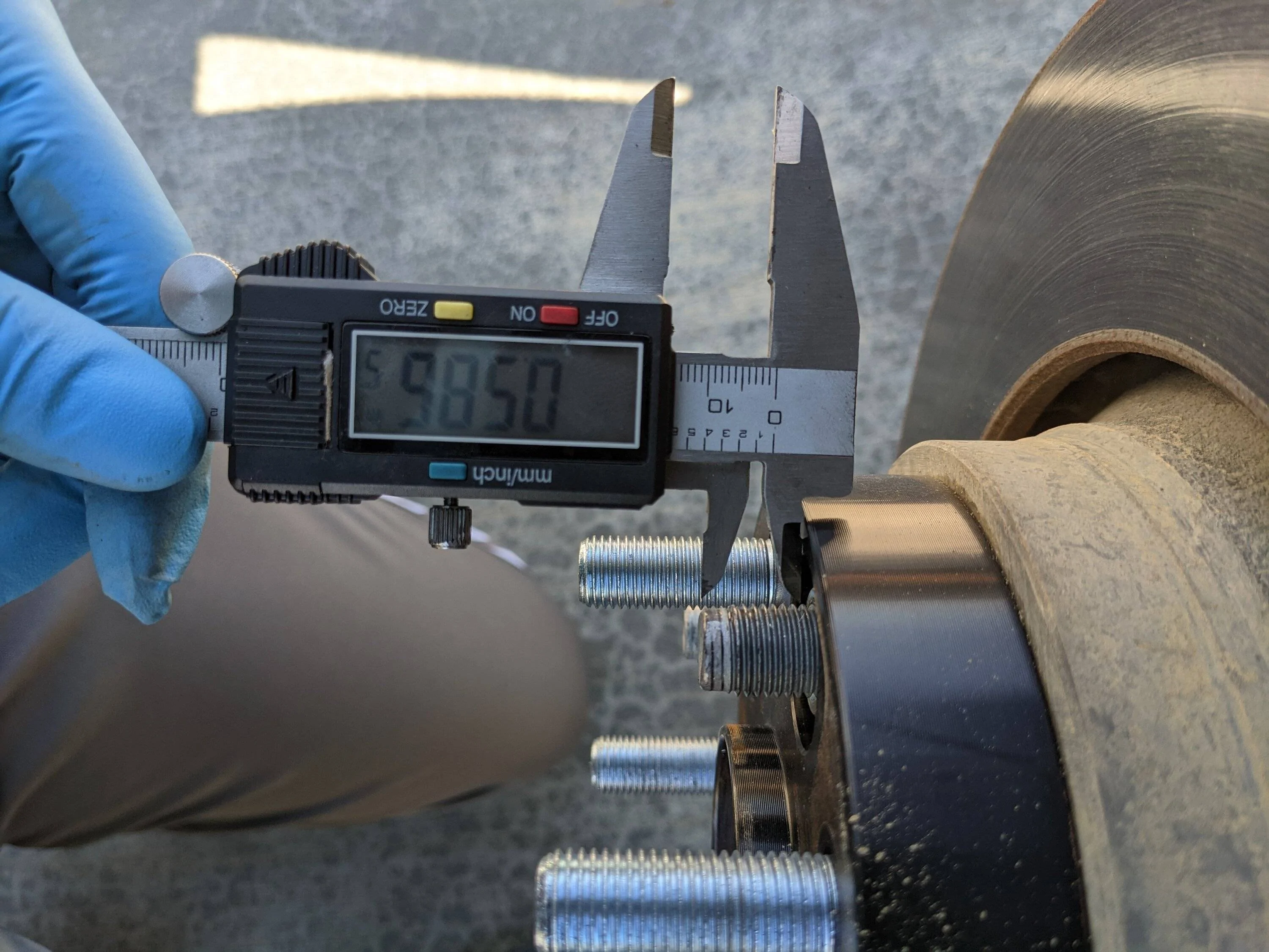

Thanks again for the info. The JLUR wheels fit perfectly on these. Stupid close for sure, but they clear. They seem to come out further than .4" though.
Jeep Wrangler JL Mod suggestions? PXL_20220827_183342029
Still no worries though because the po let's are about 3/4" like you said. Excusey crappy pic below ?
