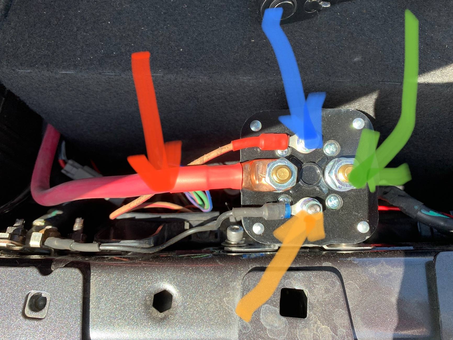

I used a Stinger solenoid powered by my factory Aux1 switch.
Jeep Wrangler JL Winch install: Project Overkill IMG_7729

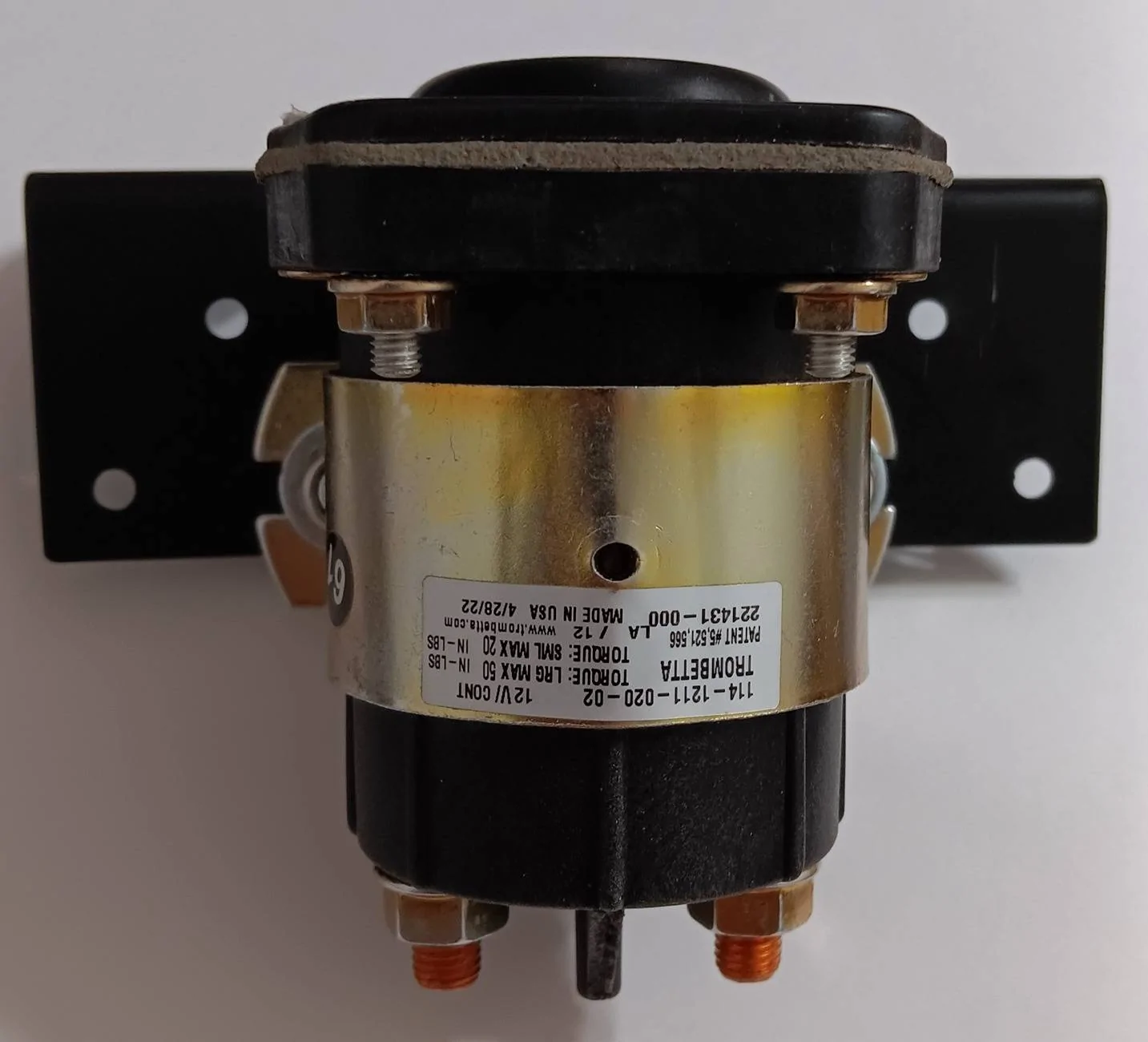

I just so happened to have a few angled brackets. Oversized the holes to mount the solenoid. I do believe the fasteners i used are 8mm thread size.
May need to trim off the top bracket depth... won't know until I mount. Looking at using existing holes on upper fender frame. Blind rivets should work.
Jeep Wrangler JL Winch install: Project Overkill 1000039500
