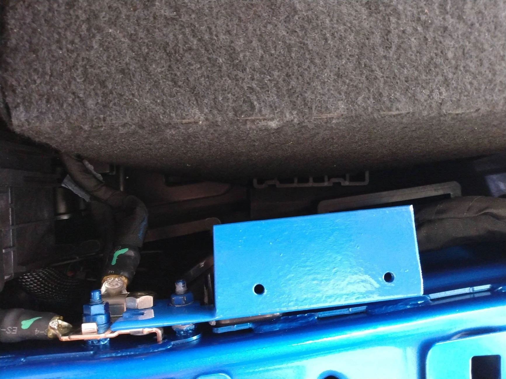

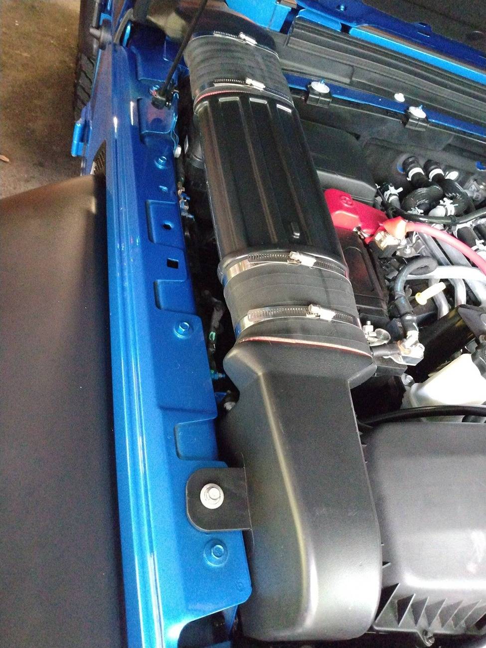

I originally had mine mounted on the side, I made a nice bracket for it and I definitely prefer that location but I added a low profile snorkel and had to move it. I'm a firm believer in keeping things simple, sometimes less is better. 👍
I have been contemplating, on removing my snorkel, I installed it as a means of cooler air. I have no intentions of going anywhere near water that deep. The way I set it up, I can go right back to stock. I'm on the fence.
