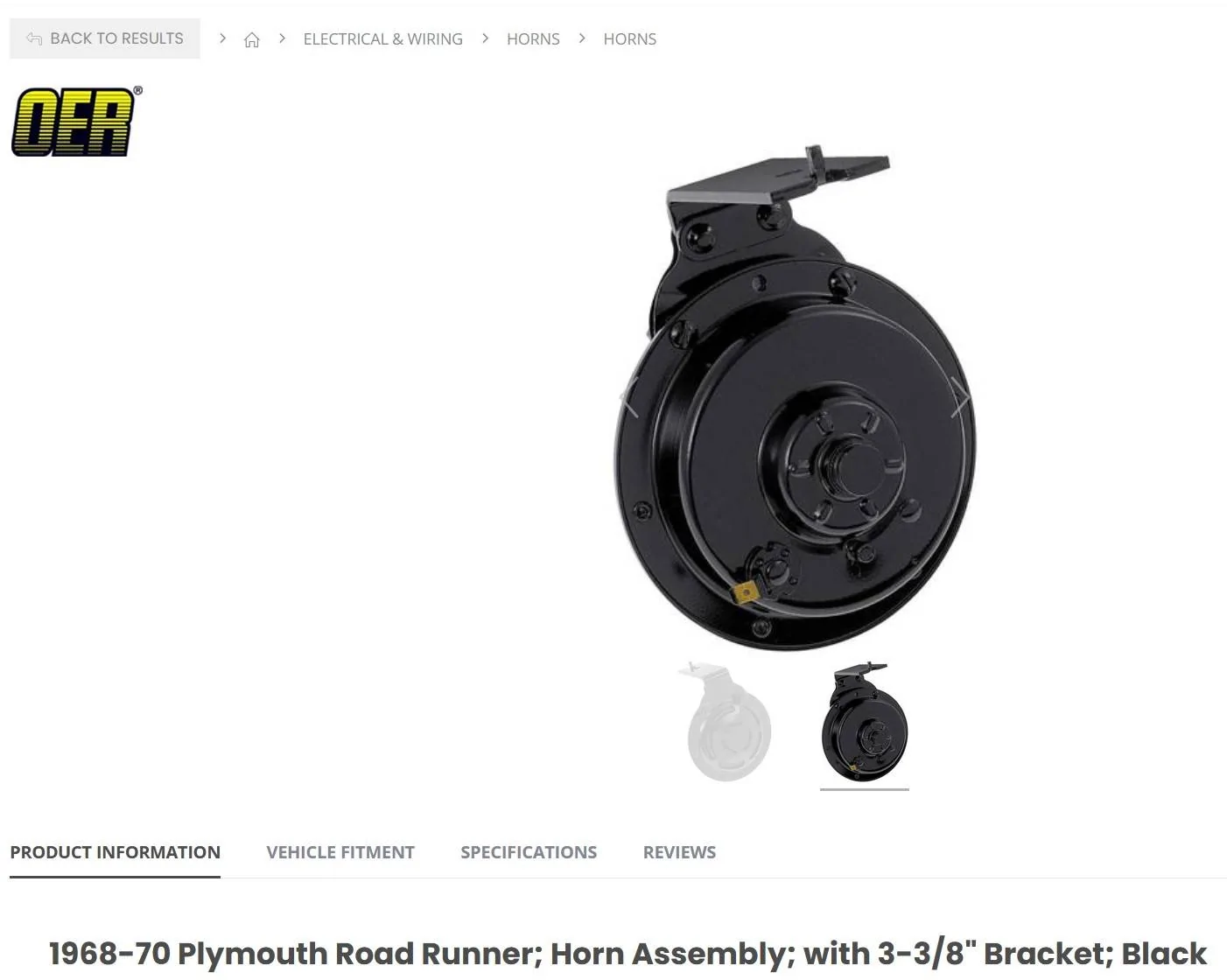

I want to replace the dual factory horns with a single road runner "beep-beep" horn used on the Plymouth B Bodies from the late 60's/early 70's.
When originally installed, the Road Runner horn ground through the chassis and had a single wire for power.

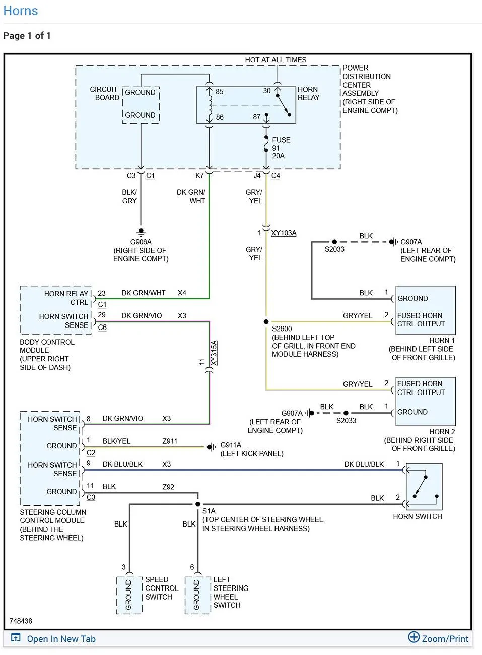

The factory JL horn uses a sealed two-wire connector and appears to have a wired ground.
Can anyone tell me what the best way to wire this up would be? The JL horn wiring diagram is below along with a photo of the Road Runner Horn

Not sure about the wiring. Maybe try just the JL green and ground wires?
