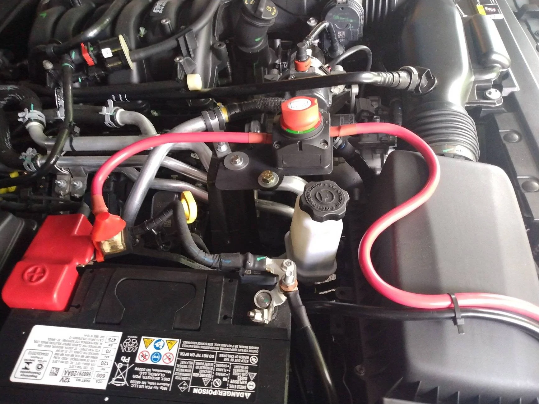

Here is my revised main power and secondary ground installation to fit factory and aftermarket air box. A wee bit more snug fit, but air box bolts in just as easy.
Jeep Wrangler JL Winch install: Project Overkill 1000042392
Need to obtain a 19" 2 awg ground cable to complete the installation.
Minor things to secure the WARN controller... a few 12" zip ties and a custom bracket to mount the 5 pin controller for a hard wired backup option, if wireless remote fails or my phone drops and breaks. My phone can control with the blue tooth addon for EVO winches.
