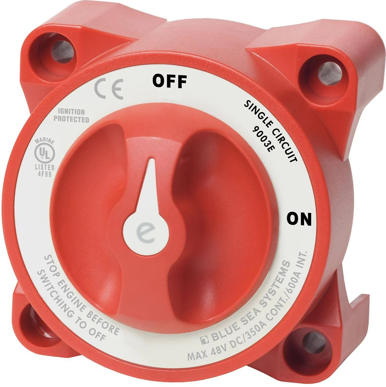

Correct me if I'm mistaken, but I think that solenoid is rated for 200A continuous. What is the amp rating of your winch? Mine (Warne Zeon 12) is listed as "469 Max Amp Draw" I'm not sure how long that may be sustained or what the typical sustained amp draw is (I don't see it published), but it may be pushing beyond the upper limit of your solenoid contactor duty rating...
I would think that a heavy-duty marine switch would be simpler and more "overkill" capacity-wise and rugged-wise.
Thats what I ended up using, returned the $16 Amazon switch, and purchased the Blue Sea Systems 6006. https://www.jlwranglerforums.com/fo...-battery-or-power-cut-off.107279/post-2638748

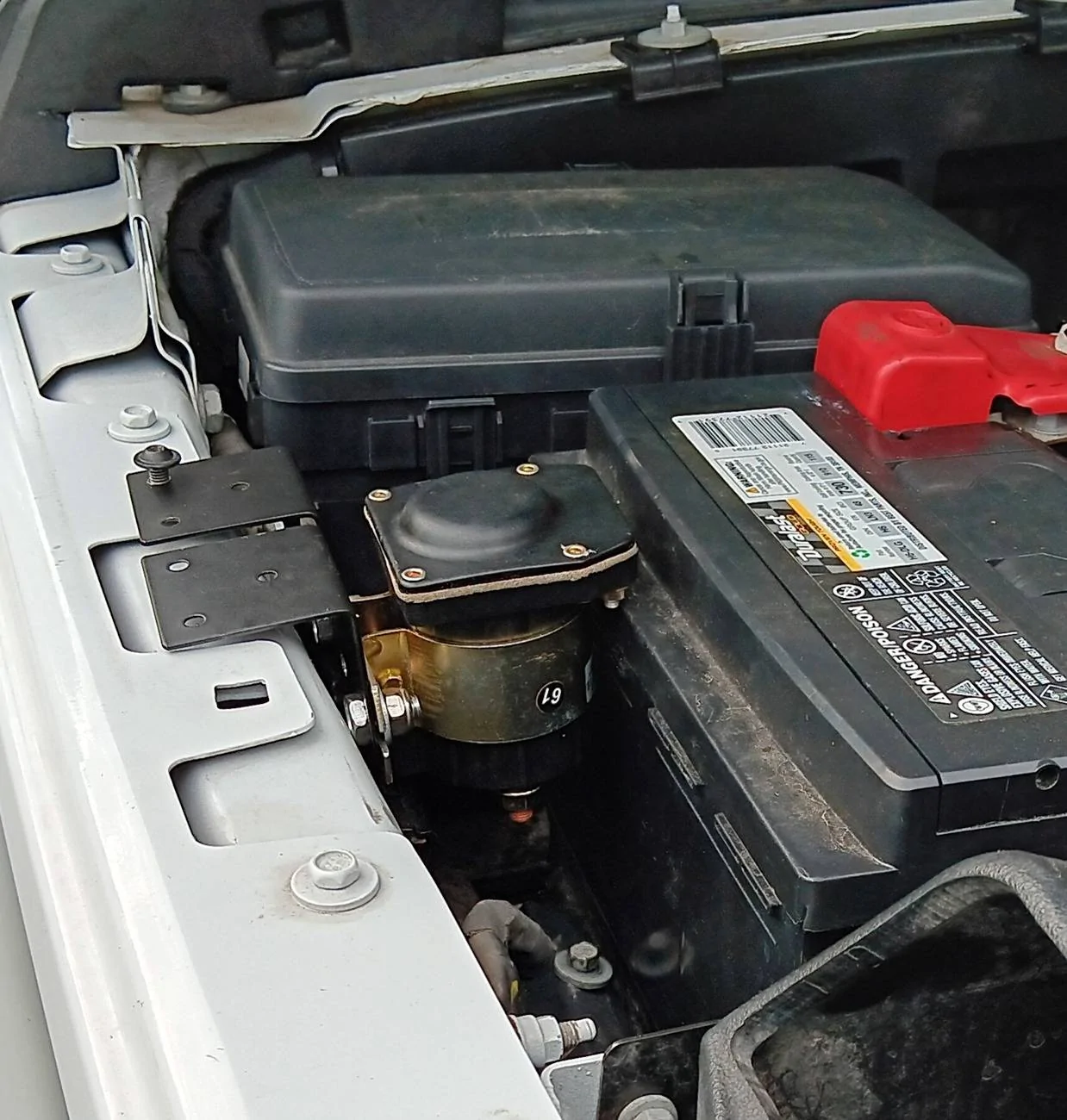

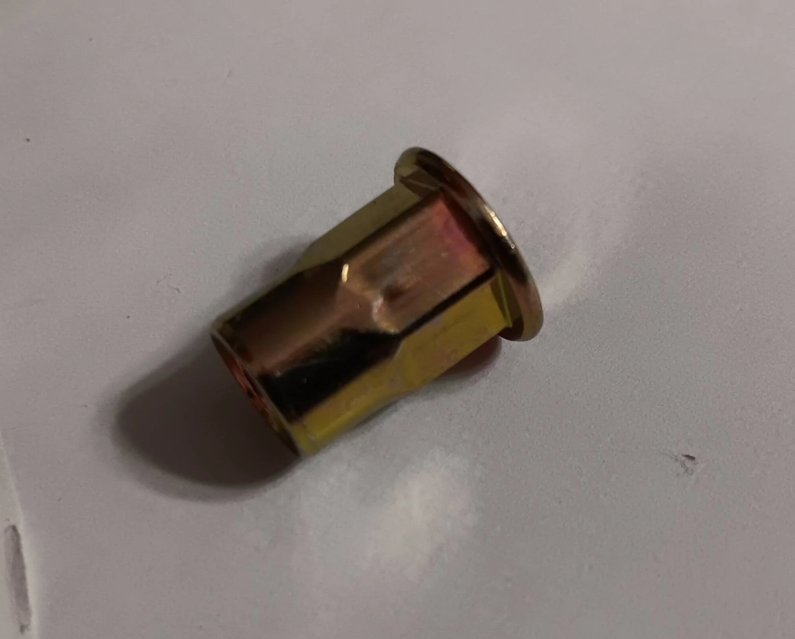

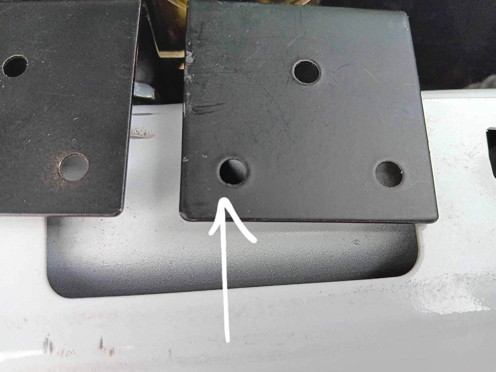

Made a small change to mounting the Bear contactor switch. All I need to do is install a blind metric threaded rivet. The arrow points to the hole I will oversize for the fastener. I will use a 8mm blind rivet. The JL has a hex punched out hole which I can use.
Jeep Wrangler JL Winch install: Project Overkill 1000039524
The contactor height can be adjusted by its clamp mount. I left it at stock height.

I am using an already threaded mounting hole and also added a locating hole for the bottom of the left bracket. See picture below.
Jeep Wrangler JL Winch install: Project Overkill 1000039523
The white rounded protrusion is an unused grounding stud. I may use it with an additional nut to assist the bracket's mounting.

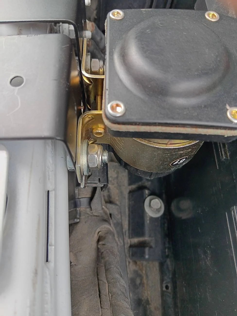

Also the biggest obstacle in mounting is not the battery. Even though it looks like the contactor is resting on the edge of the battery. The obstacle is the wiring harness of the heavy duty elecricals. I had to pry out the Christmas tree fastener to adjust clearance.
Jeep Wrangler JL Winch install: Project Overkill 1000039522

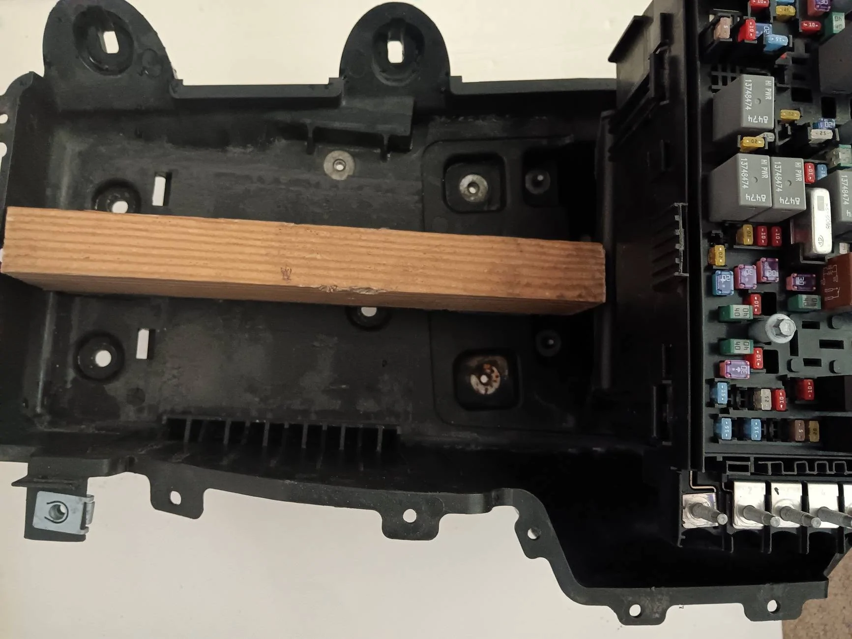

As I stated over kill is part of my plan... here is my new modded OEM battery box to fit a H8 battery.
Why re-invent the wheel when what you got will do just fine.
Jeep Wrangler JL Winch install: Project Overkill 1000039686
The block of wood is about 1/16" longer than 14".
A H8 has the same height and width dimensions as an OEM battery, but is longer. It's width is about 13-15/16". So I'll have 1/8" of play room.
As for end stop at fuse box I'll mount L brackets at the newly opened sides.
I also added a M8 threaded blind rivet in the hex hole near the ground posts, more like center of fender mounting . The new mounting location will be for my Bear contactor solenoid.
A M6 would be a direct fit, as I had to extend the sides for the larger blind rivet.

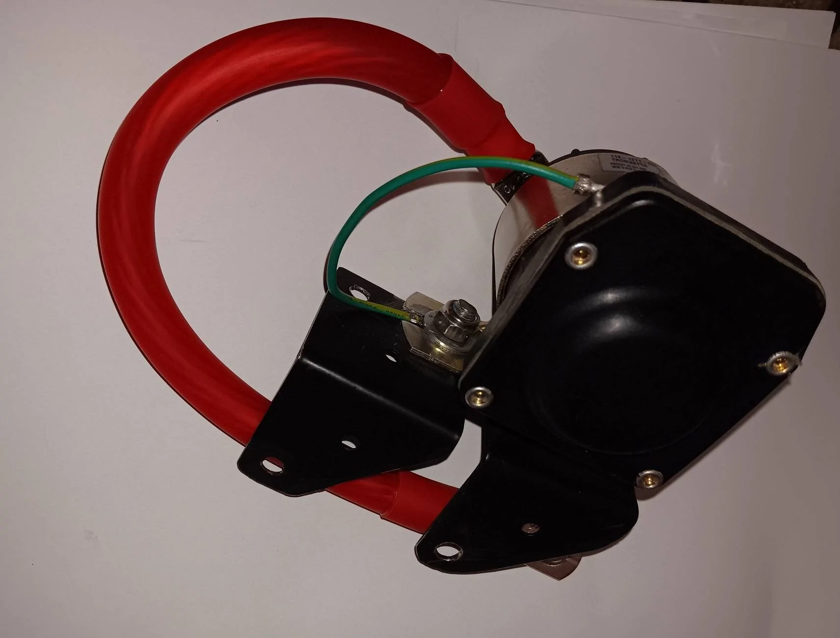

I completed the ESS removal clean up and got my custom 0/1 cable to connect the bear to my H8 positive battery terminal. I may order another custom length cable for the power to winch.
I also ran a switched power wire to trigger the Bear for winch function and charging circuit protection.
I poked through the nipple at the top of the wire harness going through the firewall at the right side. Battery, fuse box, and aux battery will need removed to make the wire pass through quick and easy.
I poked through the nipple with a small skinny driver and used a stainless sipping straw to guide the wire through into the cabin. It ends up at the upper side of the kick panel, so you will need to reach and feel around the top area of the rubber boot surround of the cabin side wire harness.
Jeep Wrangler JL Winch install: Project Overkill 1000039961
The key is keeping cables short and eliminate the long ground cable return to battery.
Here my Bear contacter solenoid with the custom cable and self ground wire. When mounted body ground will make the trigger circuit functional.
