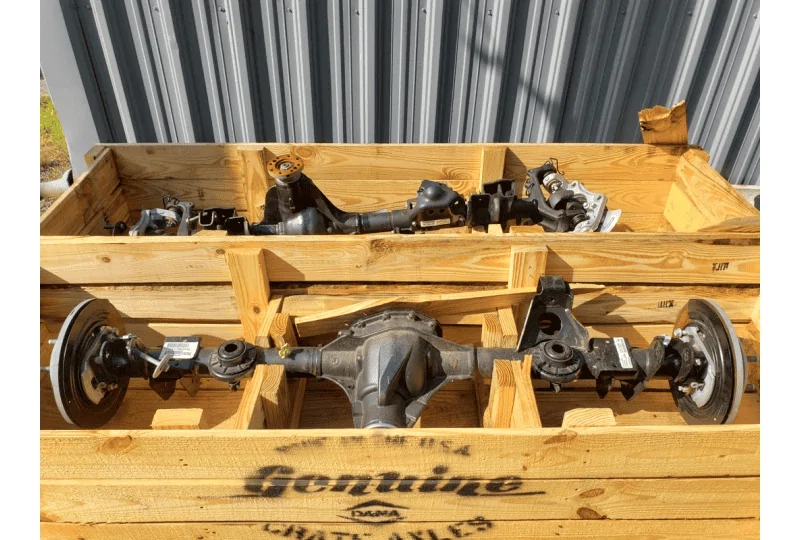

I feel your pain on the price jack of the Dana UD60's, they are pretty much in the same price point as everyone else now. The only saving grace is they are typically readily available with no wait.
For the semi-float, on the rear I would not worry "as" much as the front personally. Most of the big names offer the rear in a beefy package with 40 spline axles, and on 37-40's I think it would be ok.
I would do full float at any rate though personally.
Something else to factor in, if you swap in the new front to replace your bent one, now would be a good time to change your gear ratio too, and the rear would need to match.
