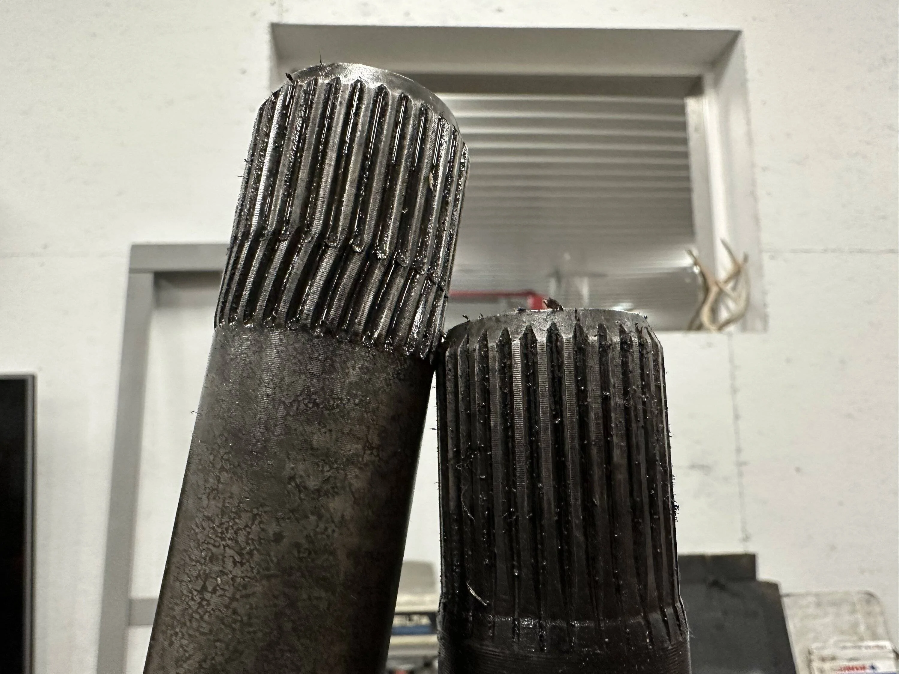

what do you guys think of the axles on a 392, think it would be safe for 40s?
Absolutely not. Here is my twisted upgraded chromoly shaft, courtesy of 470 horses… This was found when replacing the factory Elocker that also crapped the bed. And that’s all with 37”s.
Wow that sucks, I am on 37s km3’s currently. What made this happen? Was you on the skinny pedal hard ?
There was no dramatic bang, etc. The locker was clicking and wouldn’t engage. I even drove an hour home. As far as the twisted splines, I didn’t buy a 392 to only use half the throttle ??‍♂
That makes me feel better about running 38's on my 2.0L where I never bump it. I've got upgraded shafts but stock 4.10 diffs.
BTW, I bought a 2.0L to use 1/4th throttle, it's a nice crawler.
Air lockers would have engaged and you wouldn't know there was a problem. Air better :)
