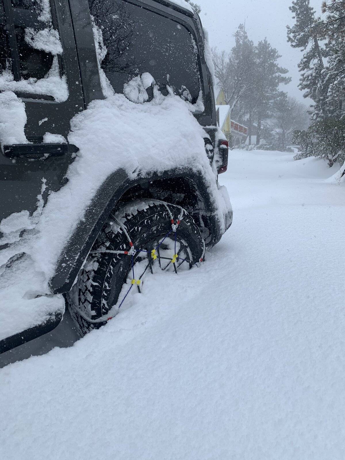

Anytime I see a decent storm on the radar here in SoCal I get my ass up to big bear and rent an Air BnB. This past January I drove up on a Sunday to 6-7 inches of snow. Typical winter day. Woke up to 18+ inches on top of the day prior.
CHP/CalTrans went R3 and required every vehicle to have traction devices. I bought these ones off Amazon and they worked just fine.

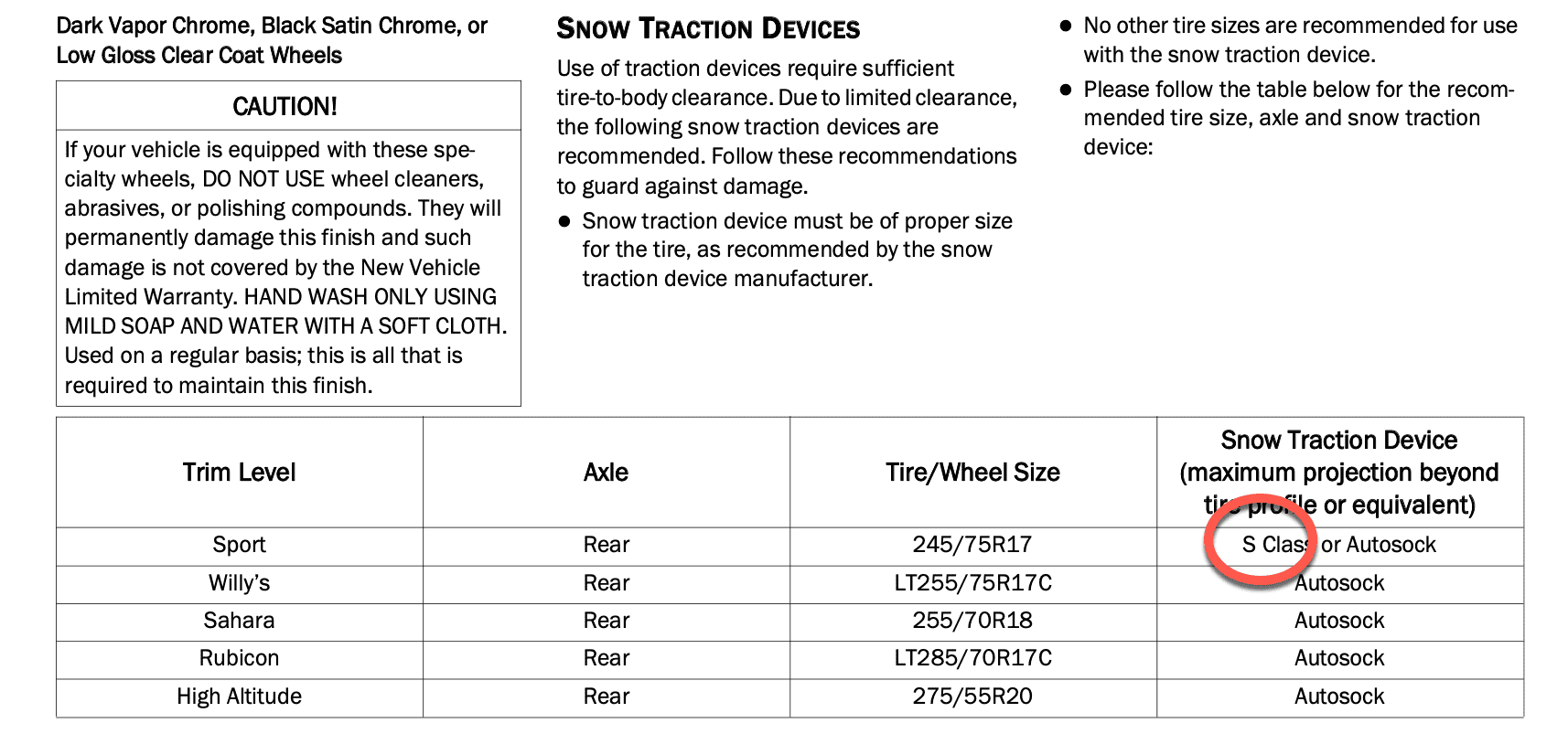

... The user's manual doesn't restrict the use of chains ...
I direct you to page 418 of the 2021 JL user manual, that talks about "snow traction devices"
SAE "S Class" is a classification for measuring clearance of tire chains (and other "snow traction devices.") At the "S Class" level, there's enough room that some actual literal tire chains meet this clearance classification. As you see in column 3, it is recommended for use only on Sport with the 245/75R17 Tire. For all other configurations and tire sizes, the Owners Manual is recommending against tire chains, and instead the use of "Autosock."
"Autosock" meets the California requirement for "tire chains" when installed whenever chains are required.
Based on these facts, you were given a disclosure telling not to use actual literal tire chains, and instead use the "snow traction devices" recommended in the owners manual.
Despite all the other nonsense in this thread, there's nothing in CA vehicle code preventing the use of actual literal tire chains, and I saw more of them than I can count on the road just this evening. All of which had to drive through a Caltrans inspection checkpoint.
