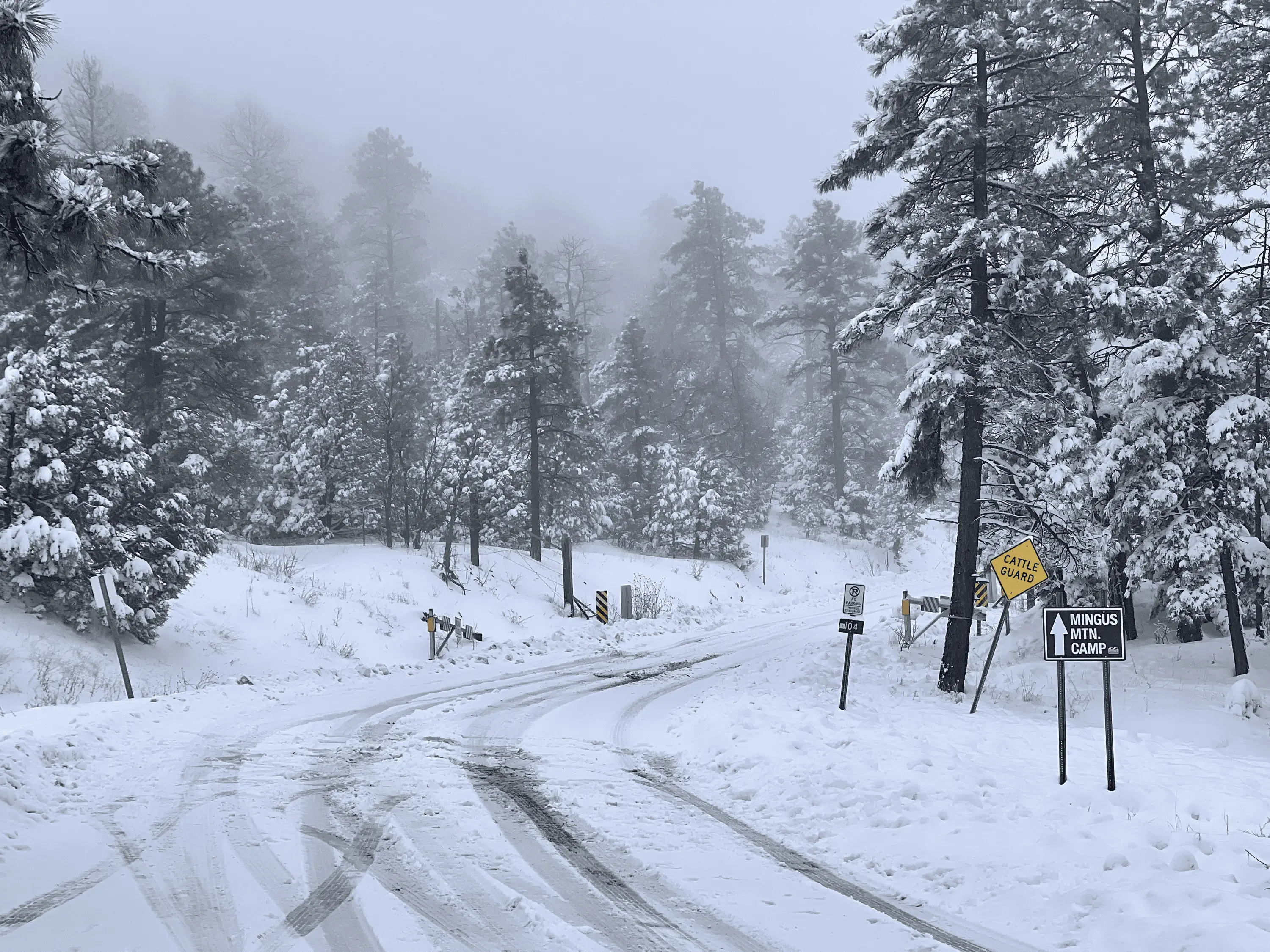

Did a Google search looking for snow chains on a Rubicon X and this was one of the top hits. Any thoughts on chains for a Rubicon X with the 35" tires? In Mid-January there is a likely hood I may need chains to get my kids to and from church camp at 7,000 ft elevation. The road starts off as asphalt and the further up you go it turns into a dirt road with a significant drop off on one side. The camp tries to keep it plowed but they had a hard time keeping up with the amount of snowfall this past January.
Attached is a photo I took in January 2023 when picking up the kids from that same camp.
Honestly, if your Jeep 4x4 needs chains, that camp is going to close. Think about it. They have staffers, and parents, driving in and out. The food supply truck drives in at least once a week.
Ordinary cars may need chains. But a Jeep with M+S tires, or especially 3PMSF (3 Peak Mountain Snowflake) isn't going to have any trouble. Just take it slow.
Tire chains for oversized tires, 35" and up, aren't typically available at typical auto parts stores. You have to order them off of outfitters like "tirechainsonline.com" that sell chains for trucks and heavy equipment.
But again, you won't need 'em for that road you showed us in the photo.
EDIT -- PS: Last January was an epic unusual winter for the record books, especially a couple of those storms. I'm not surprised they had trouble keeping the road open.

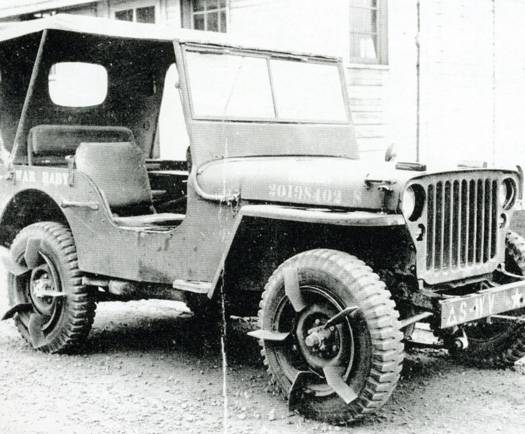

Stay on top snow
Jeep Wrangler JL Snow chains 83101CAE-8E3B-470C-BC6D-1EAC26CC01A7

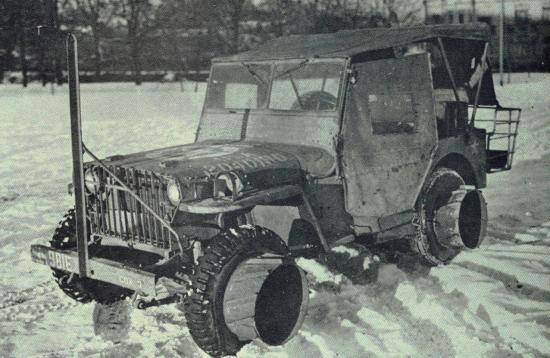

or dig through snow
Jeep Wrangler JL Snow chains 282D962C-20D9-4447-B56B-4C3AD4DF6D1D
these do work but are tough on wheel lugs ….. don’t know about the flotation type.?
