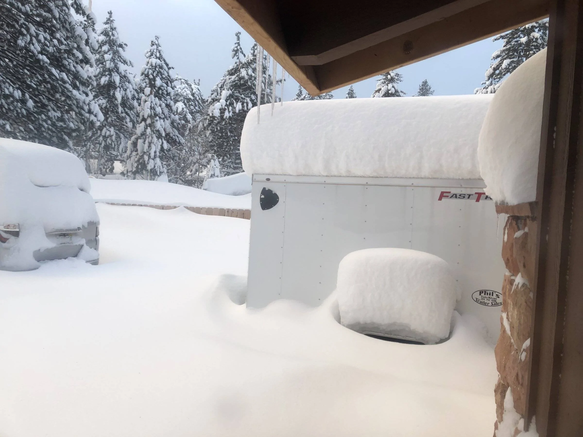

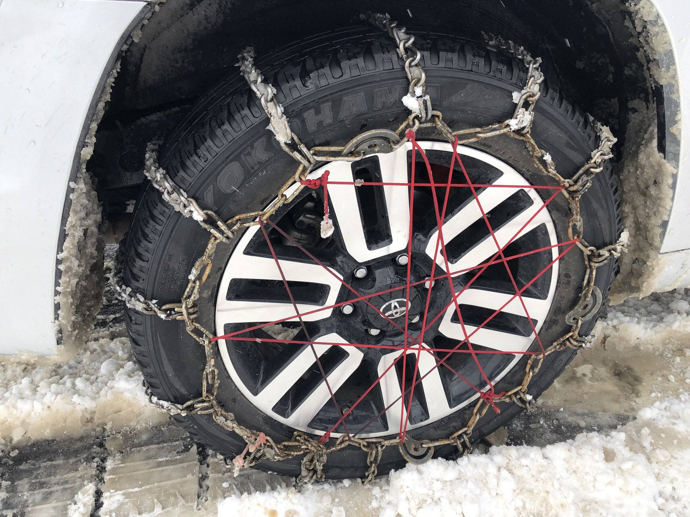

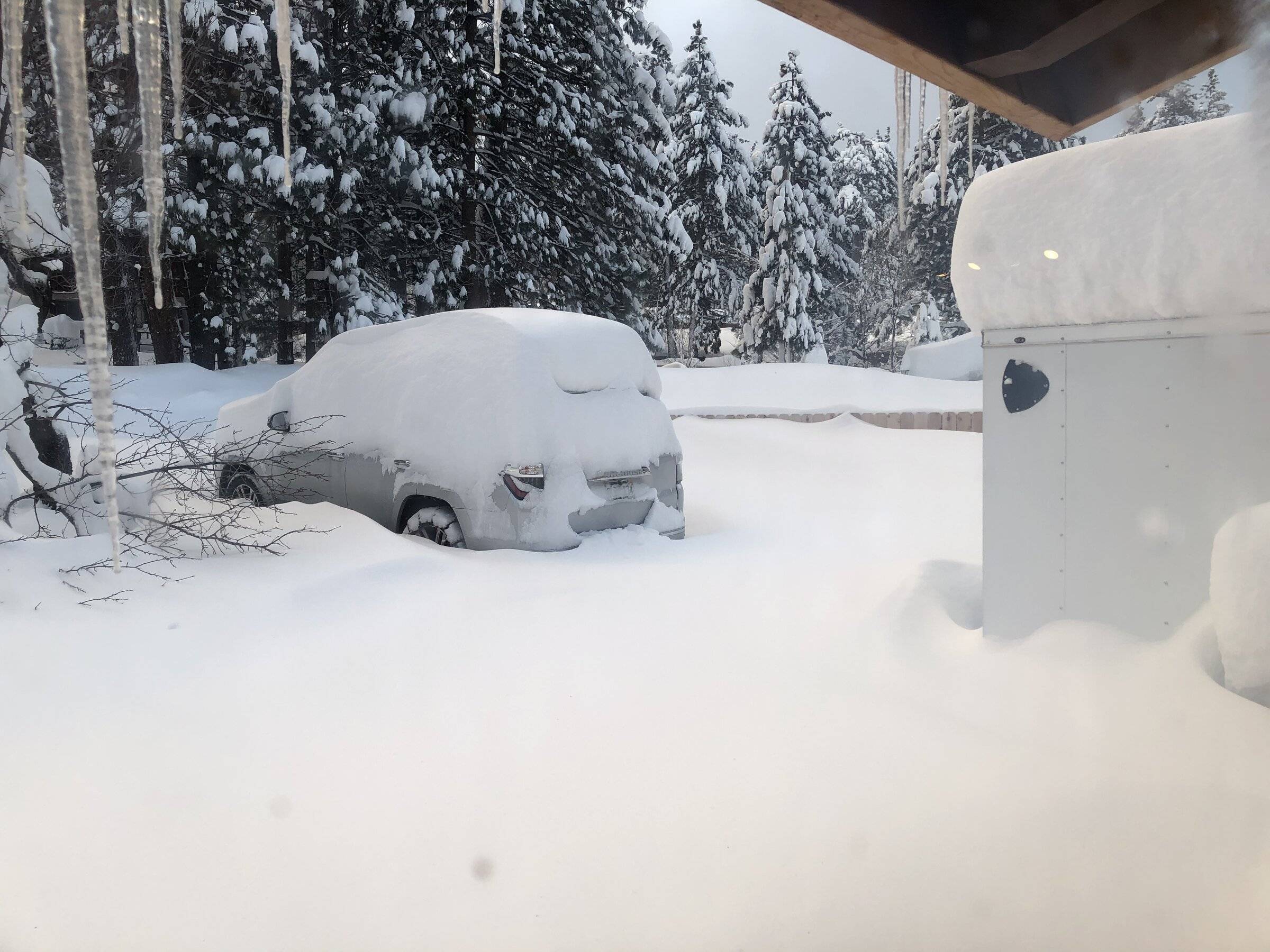

Good luck! I bet you could find what you need on the Internet but you’d have to expedite shipping. Doubt you could get them quickly enough. Only thing to do is keep trying to find what you need.
Maybe if you can find a set of cam-tightening ones like the ones in the pic below (my wife’s 4Runner) you can install them and just not tighten the cams. Then use cables to tighten them down.
I had the opposite problem- I couldn’t get the chains tight enough even with the cams so I had to use 550 cord that I happened to have in my trailer.
(We were at South Lake Tahoe and got like 5’ of snow; it was insane. My wife’s 4Runner with 2WD, chains and a limited slip rear diff was able to pull our trailer out and across the mountain pass. Talk about white-knuckling it.)

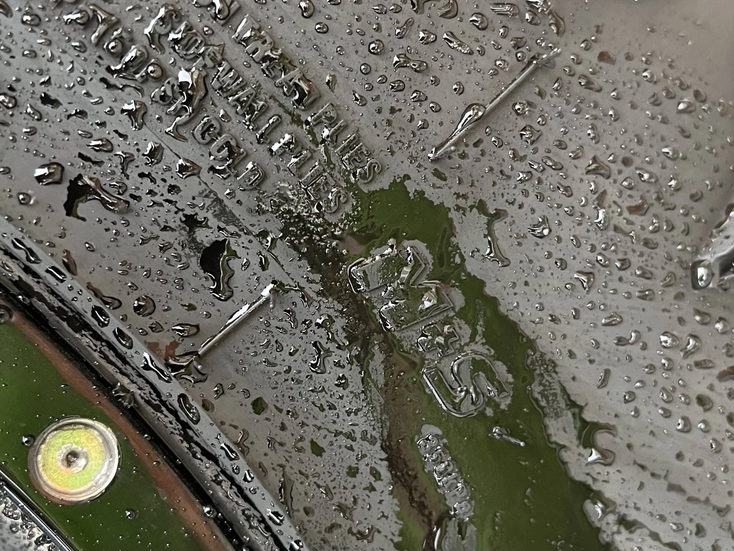

Are you sure there is no ā€œMSā€, ā€œM-Sā€ or ā€œM/Sā€ marked anywhere on your tires? If there isn’t, you don’t even meet the R1 requirements to not have to chain up.
Actually, you're right, there is a M/S. It was written pretty small down there but I did just see it right now, so at least I'm good there now.

1 Snow-tread Tires: The California Vehicle Code, Section 558 defines a snow-tread tire as follows, "A 'Snow-tread tire' is a tire which has a relatively deep and aggressive tread pattern compared with conventional passenger tread pattern". Snow-tread tires can be identified by examining the sidewall of the tire where the letters MS, M/S, M+S or the words MUD AND SNOW have been stamped into the sidewall.

In California, ā€œSnow Tiresā€ include tires with the M-S, M+S, and M/S markings on the sidewall. They also have to have at least 3/16th tread depth.

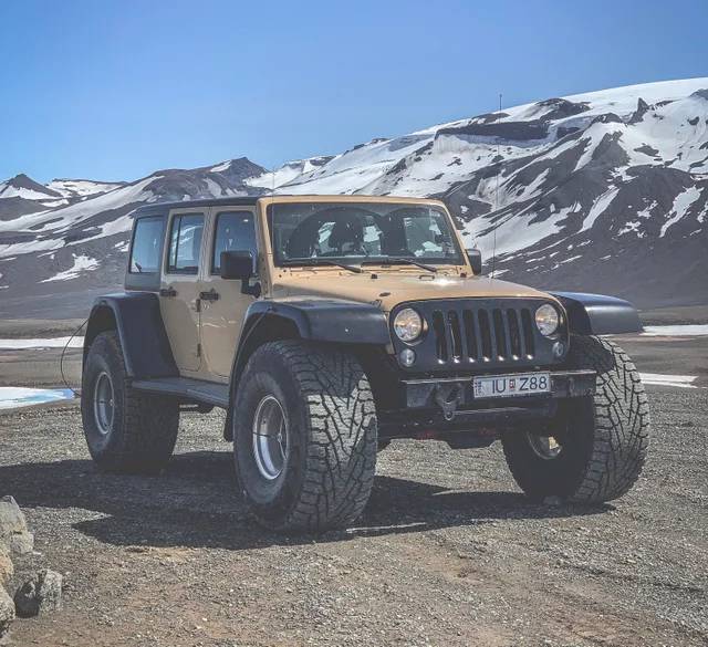

Traction devices are very good until you start trying to push snow with the axles and bumpers and stiff hanging low. Trail riding the same thing and when it gets deeper you want flotation just like in sand, stay on top. Think Iceland offroaders don't know what they are doing, haha
Jeep Wrangler JL Snow chains for 37 tires in CA? iceland 4x4
