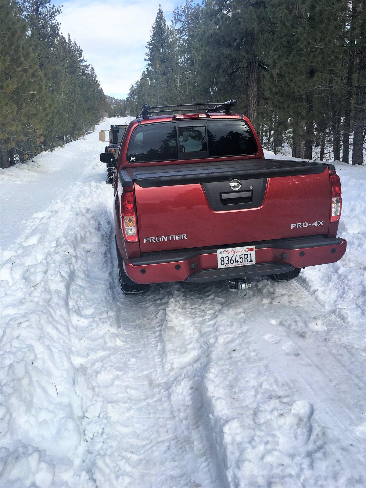

I purchased Security Chain Company SZ462 Super Z8 8mm Commercial and Light Truck Tire Traction Chain on Amazon for $148.00
https://www.amazon.com/Security-Cha...ommercial+and+Light+Truck+Tire+Traction+Chain
I have NOT test fit them yet. As others have mentioned the KO2 might require a larger size due to the thick tread. Will do so before my next snow trip but keep them mostly to get past the chain inspectors. I have used the same chains offroad on a Frontier Pro-4X with success. (Yes, that's a mil-spec hummer with chains in front of me... conditions were that crappy).
Double check sizing on the Security Chain website.
