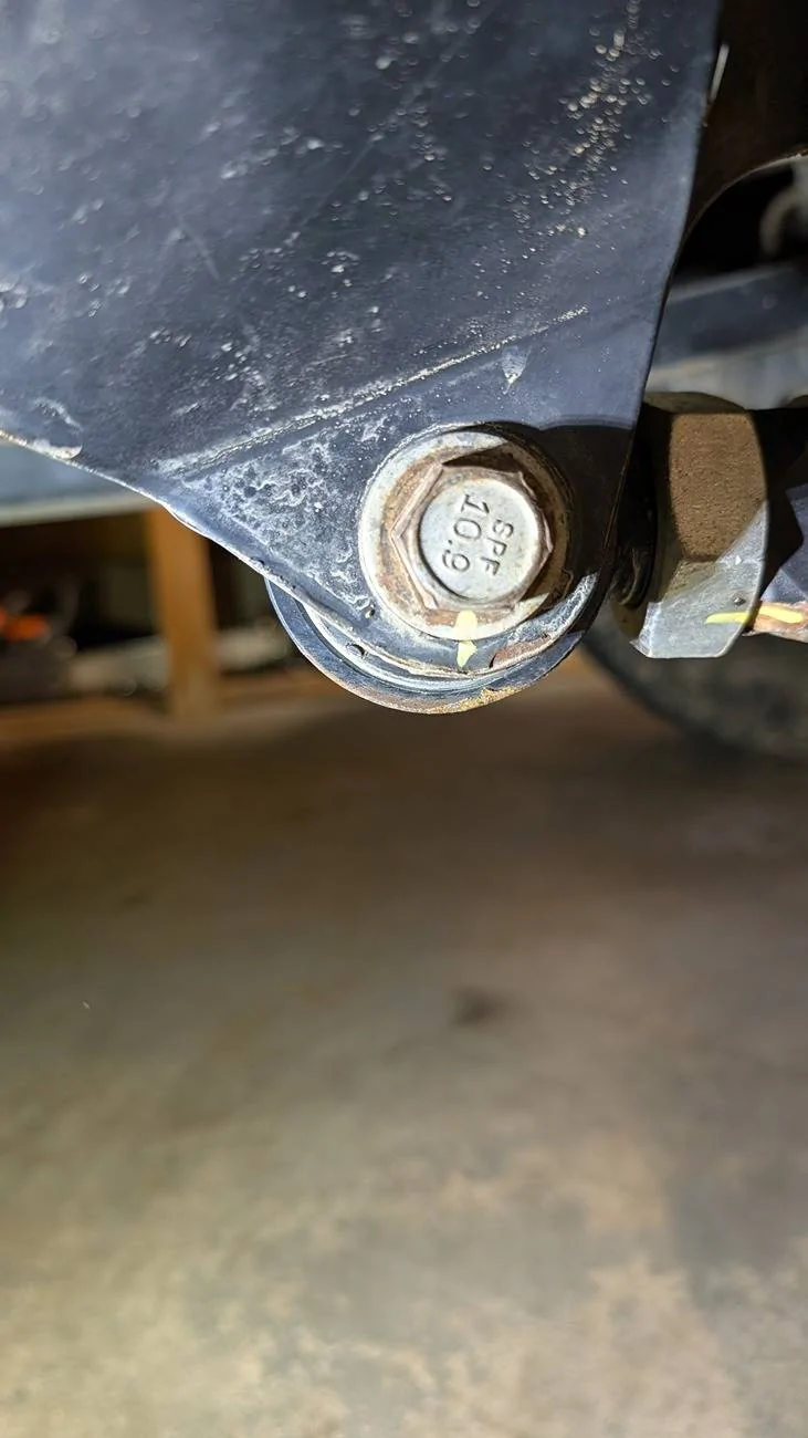

Teraflex and metalcloak are 3/16 steel welded together. EVO and rancho look like 3/16 as well but I can't confirm. Only AEV is thin stamped steel sheet metal. But like I said earlier, if you have after market control arms, the control arm bushing housings are the lowest point (at least in my case.. teraflex brackets + Clayton arms).
When I was in the market for a set, I narrowed it down to Teraflex and metalcloak. Metalcloak has 3 upper arm hole locations for small adjustments, which is a plus. But personally the color is an eye sore that I couldn't get past.
As shown below, the damages on the brackets were done before I upgraded the control arms. The control are is about 1/4 lower.
