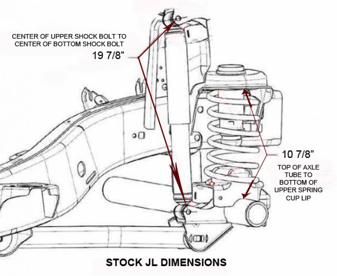

Did you use the brackets with factory arms or the 1/4" extended arms? I tried it with the extended arms but my caster got pushed too far to 7 degrees and steering is pretty heavy. Now going to try factory arms but maybe I should mount the uppers to the 2nd hole, not the first? What did you do in the end?
how much actual lift do you have? using this...use the stock oem arms and use the hole that Rancho recommends....if that is not enough super easy to move down a hole...but start with where they suggest...
