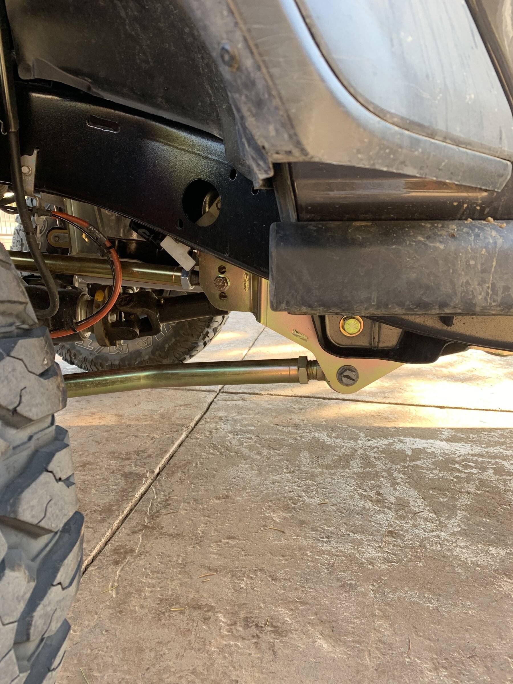

Wondering which of the three holes to choose from on the brackets? I got a little less than 2.5" of lift on the front of my JLU Rubicon and I am running the Mopar lift LCA's.
I see some folks running the Mopar lift (with the same longer LCA's) chose the center hole.
Anyone have any experience with these brackets?

I don't have the Rancho brackets but I do have the Metalcloak Geometry Correction brackets. The bracket holes are designed to set caster on a vehicle that has stock arms (non-adjustable). Each hole will slightly increase caster settings as you move down. If you have adjustable control arms it's not as important because you can set caster by adjusting the arms. You want your caster to be about 6 degrees. I run mine in the middle hole with 6 degrees and it drives great. I would start in the middle and check your caster. Then make any further adjustments from there.

Thanks for the info, unfortunately I don't have adjustable control arms - but am using the longer arms that come in the Mopar 2" lift. I am pretty sure the answer lies with either the middle of top hole.
