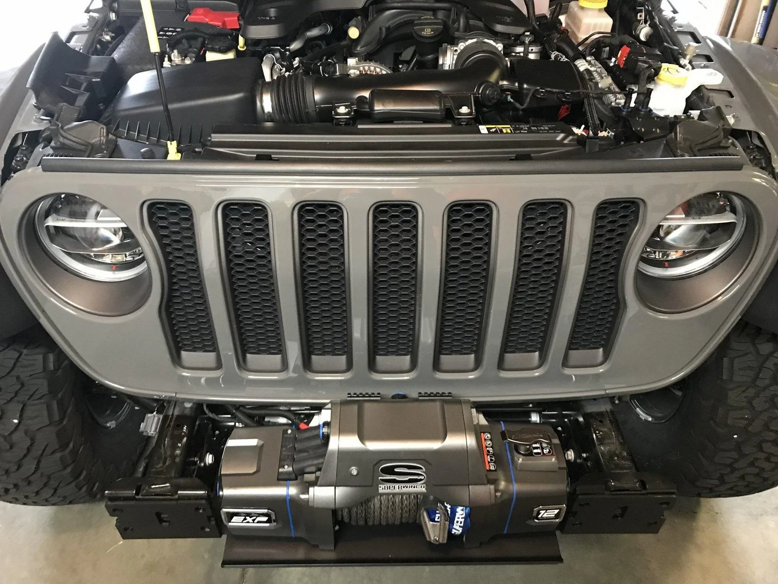

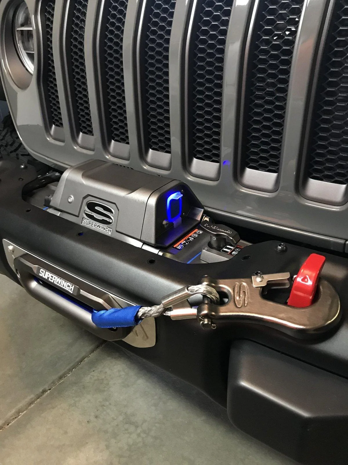

THIS.
I've had Warn winches (M8000 and 16.5Ti). Warn makes good winches and I still like them but the Superwinch EXP is the best thing on the market now, period.
An often overlooked feature is the BRAKE on whatever winch you buy - most are a cone brake which is not the strongest design. The EXP has a gearbox end disc brake - way better for holding power in an emergency.
Another thing I like is the automatic clutch - if you do a bunch of winching you'll learn it's hard work, that clutch really makes things easier. After freespooling your winchline out, there’s no need for another trip back to the winch. So nice.
For me, I don't trust anything made by Harbor Freight, Smittybilt etc. Comeup is OK, but I don't like made in China if I can avoid it. Why would I choose a Chinese brand over an American one? At least Warn and Superwinch have made in USA models still.
Bill Burke uses Superwinch so for me the choice was easy. I chose the EXP 12si on my JLUR.

Me too I went with the 10 k superwinch. Waht plate did you use? any tips on the installation? I am doing mine in the next few days?
