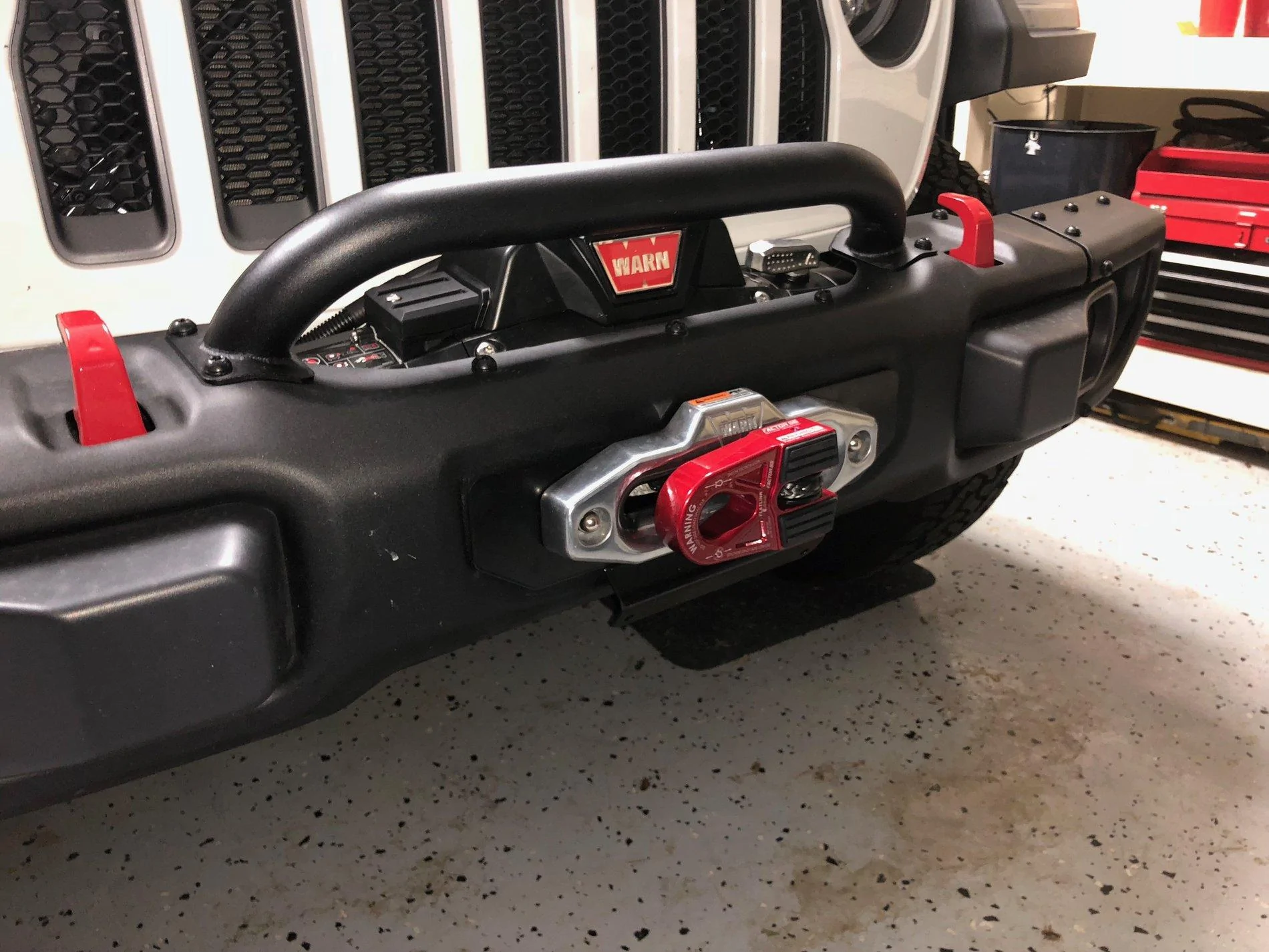

For the Mopar (Warn) winch designed for the Rubicon anyone know the difference between these model numbers for the winch: P5160095AB and P5160095AC. I see the AC version is the latest but know what the difference is.

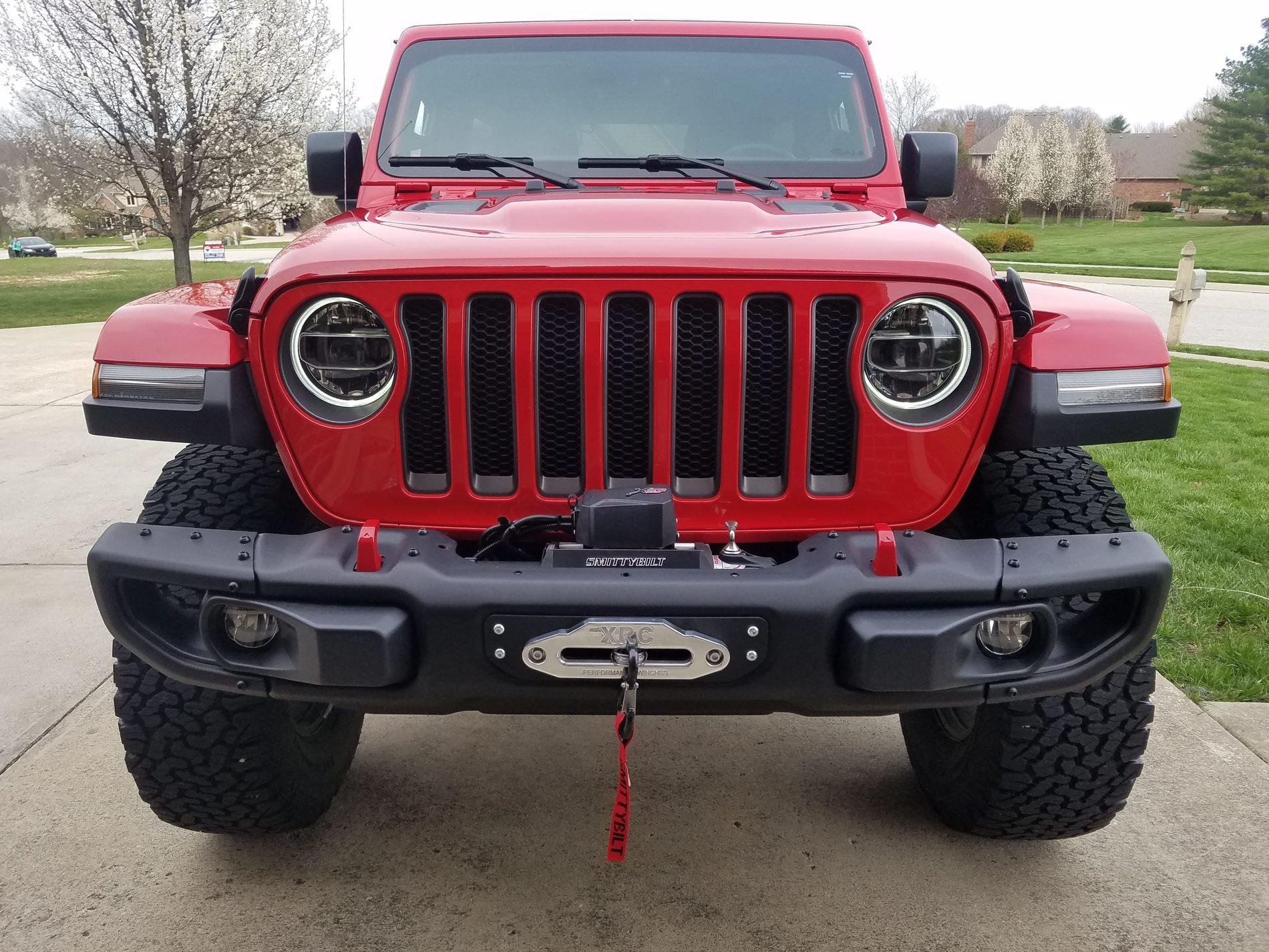

According to JCR, whose winch plate kit I have, yes. I'll confirm that once I get it installed.
It took a little english to line the driver side bolt holes up, but overall, it wasn't a super hard job. The Smittybilt XRC9500 fit with room to spare, though. It only weighs 46lbs, with the rope, which is why I went with it. It was the lightest winch I could find in its pull class.
