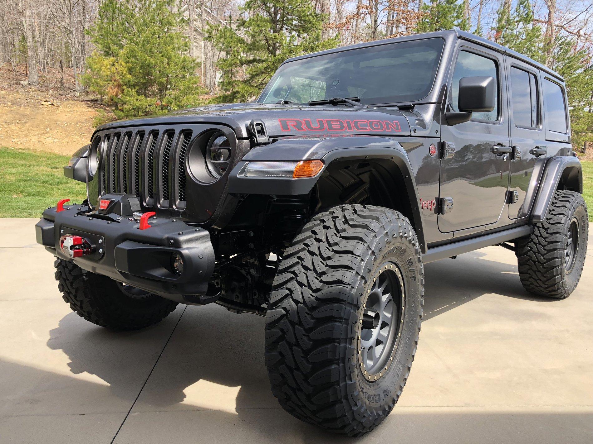

Same Set-up as PaulNY and am also very pleased with combinationWarn Zeon 10s with JCR plate. Couldn't be happier.
Hey Dave, Did you have any issues with the winch hitting the grill? I thought Rusty's plate mounted inside the JL bumper mounts and would push the zeon 10 into the grill or is this not a zeon 10s. Any other pics?Just installed this Warn 10s in only an hour with a Rusty's plate.
This is a VR 10s Warn. A lttle smaller than a Zeon.Hey Dave, Did you have any issues with the winch hitting the grill? I thought Rusty's plate mounted inside the JL bumper mounts and would push the zeon 10 into the grill or is this not a zeon 10s. Any other pics?
