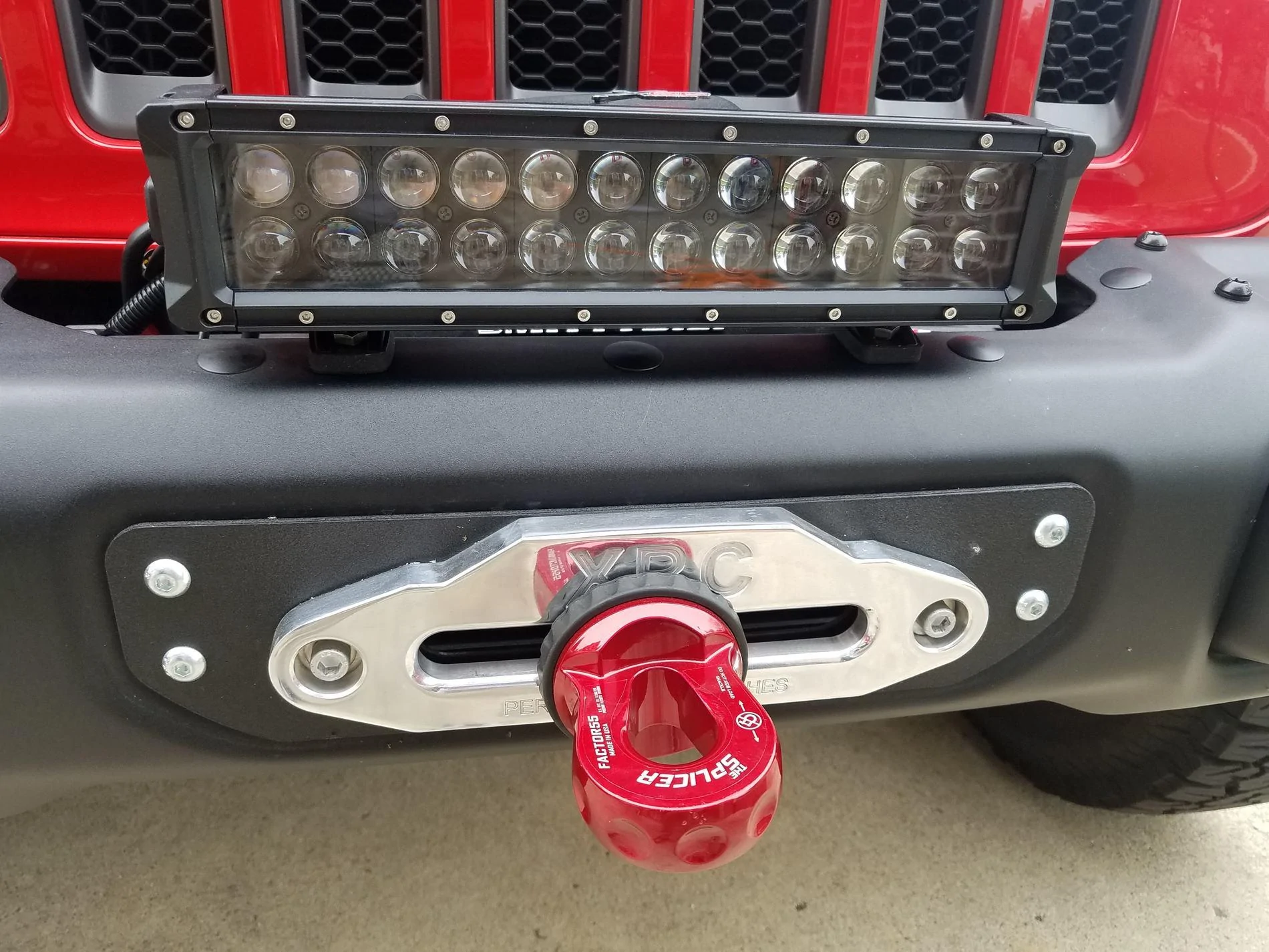

Did you have a way to cover this gap?
I don't have anything covering that.
Like what you did to hold the hook, i might try that. I just put in a baseplate (for towbar) and hooked to where the safety cables go, but i like your idea. I have a license plate holder so i don't know if that will also pull up the plate.
Great Job.

I bought a Factor 55 Splicer with a rubber pad on it to protect the fairlead. Here is a pic...

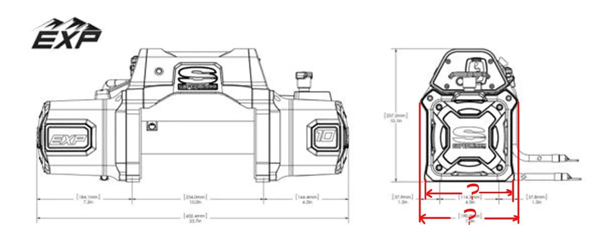

anyone who has a warnzeon 10s Can you give me 2 dimension of it.
Front to back at the bottom of the winch and front to back at the top of the unit that holds the drum?
