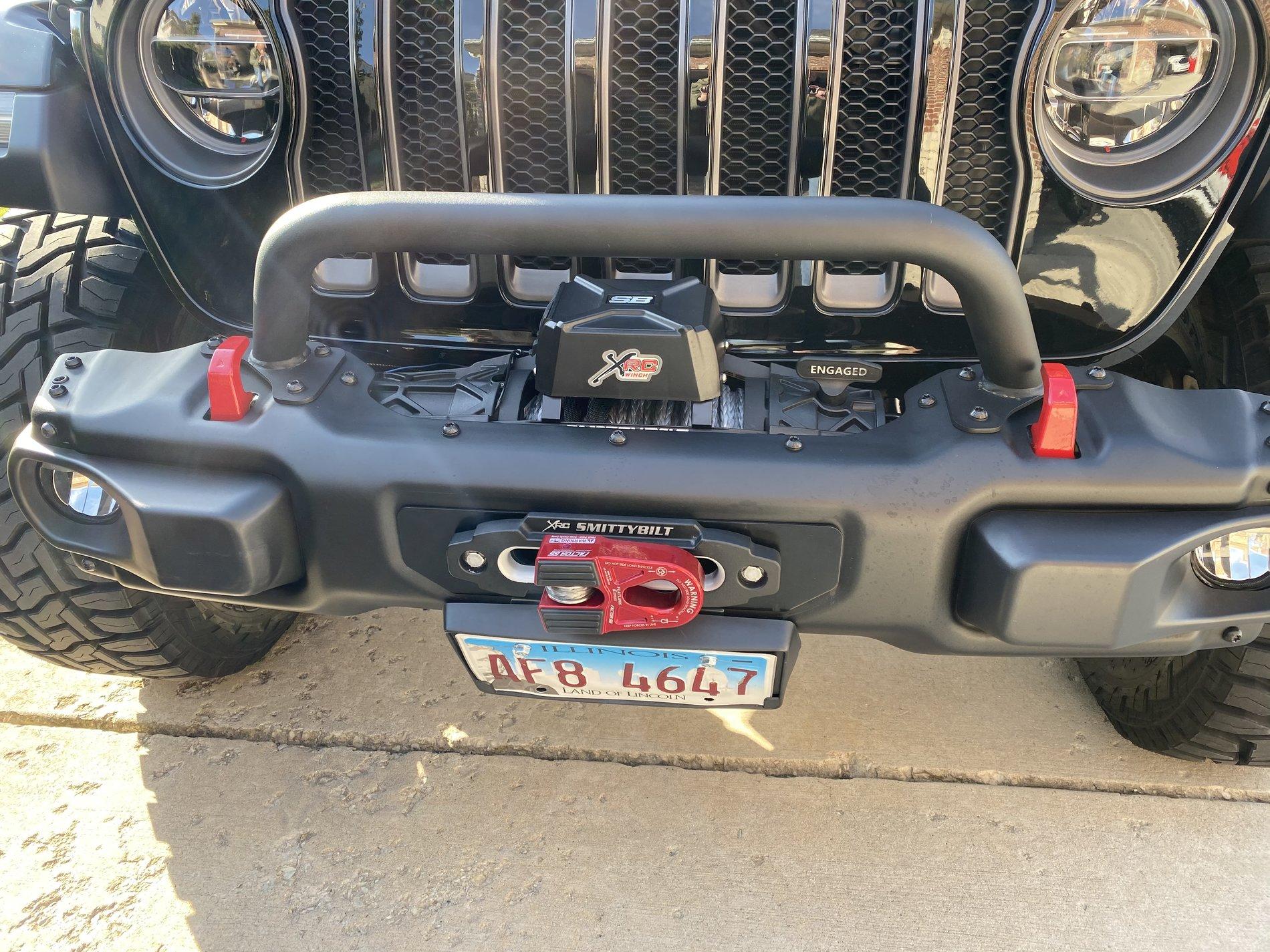

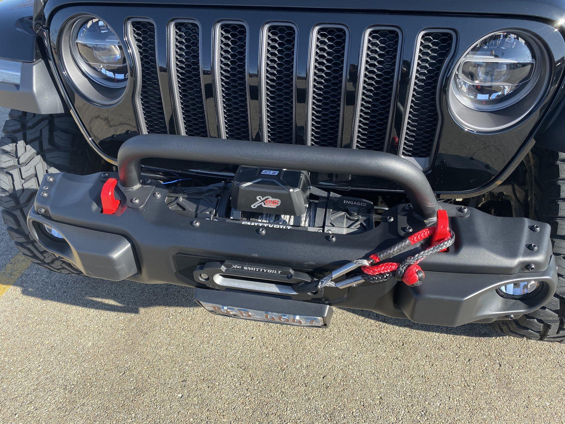

Just installed the SmittyBuilt XRC GEN 3 Fits nice! Seems very well made. Has nice features such as an auxiliary 12 volt post, Light Over the drum, flashlight on the controller, also the XRC emblem lights up.
The XRC Gen 3 is the exact one I'm looking at for our new Wrangler. Did you go with the 9.5K or 12k, and which plate did you choose? How do you like the Gen 3 so far?
I got the 9.5k after researching and listening to the guys in the know on here.
I went with the Warn Winch Plate that Mopar uses. If you need the item number I can look it up for you.
Everything is pretty straight forward.
I did have to elongate the two rear holes on the skid plate that a lot of people have to do as the winch plate moves everything back about 1/2” or so. It’s really easy with a dremel tool.
I mounted the Control Box on the top center of the winch. The cables coming out the back do hit the grill but I don’t think they are causing any issues to the grill. i think it looks really nice. The XRC lights up too which is pretty cool. Haven’t decided where to hook the one positive wire for the light yet. Anyone have any ideas let me know.
When you plug the remote in, the winch also has a light that is already wired and it lights up the spool which is nice. The controller also has a flashlight on it and magnets to place the controller on the bumper if you need free hands for something.
I’ve only used the winch to spoil the line tight. I had my son in a Tahoe applying some break pressure while in neutral and I pulled him toward the Jeep to spool the line.
The controller also has color coded lights that tell you if your overloading the Winch or if everything is good.
I’m no expert on winches. It looks great and worked perfect with spooling the line which isn’t really a great test.
Also, you can remove the two armor covers and paint them if you like.
Hope this helps!!!
