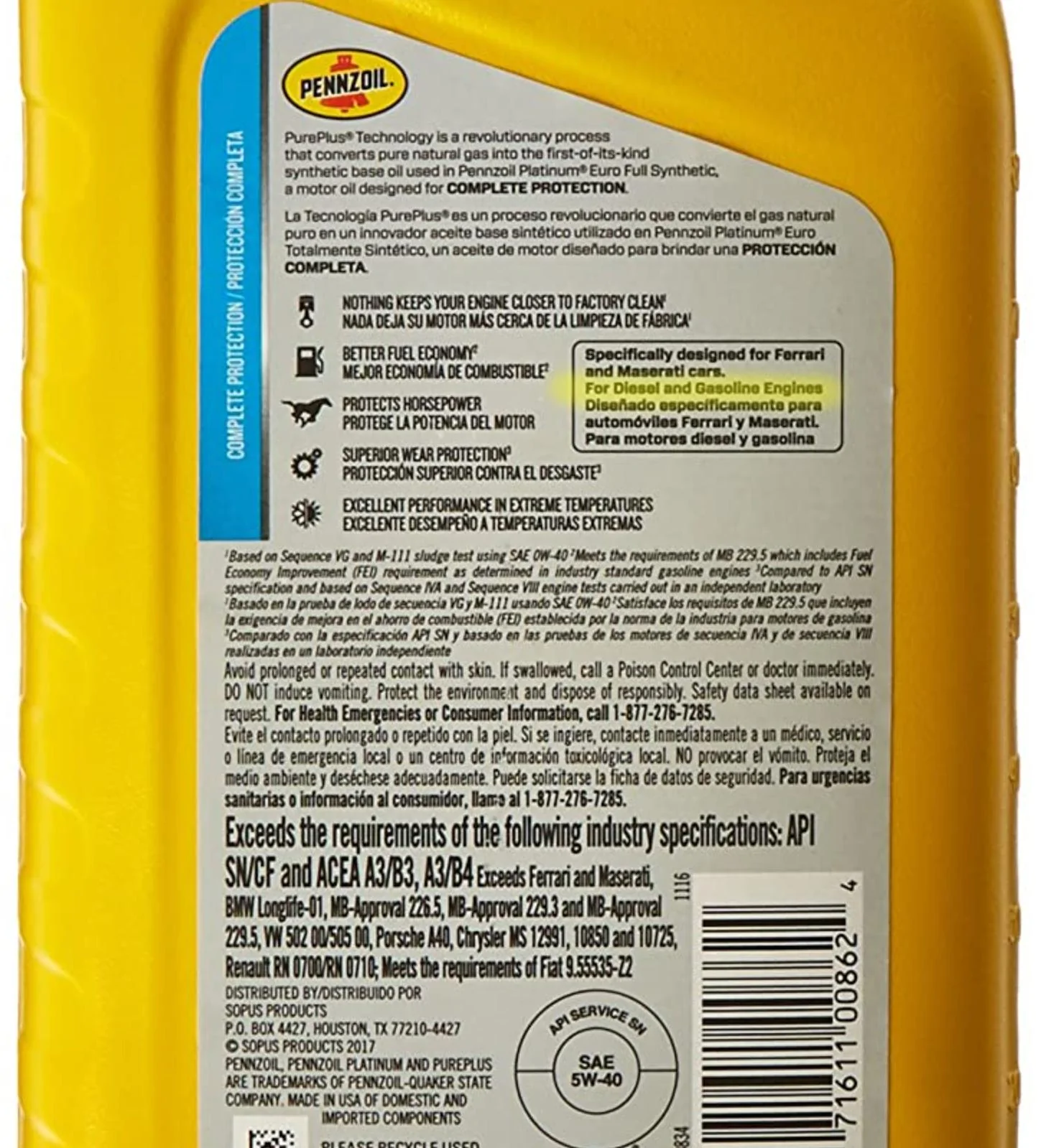

yes, and note that the label in the picture also specifies this oil is CF rated as well, which is a Diesel standard.
since the manual for the EcoDiesels requires an SN oil and this also meets the MS 12991 recommendation, this would appear to be an acceptable oil to use in that application.
You are correct. API SN certified oil can also be used in diesel engines requiring an API SN certified oil. See the back side label of the container below for Pennzoil Platinum Euro Full Synthetic 5w-40 motor oil.
