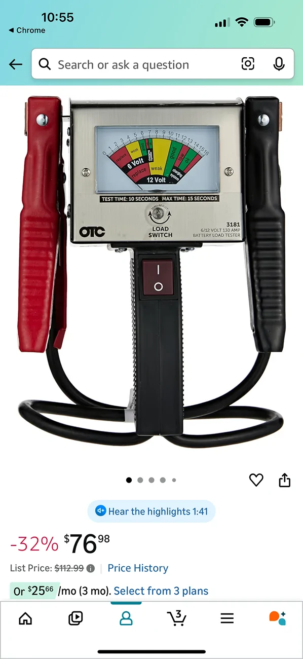

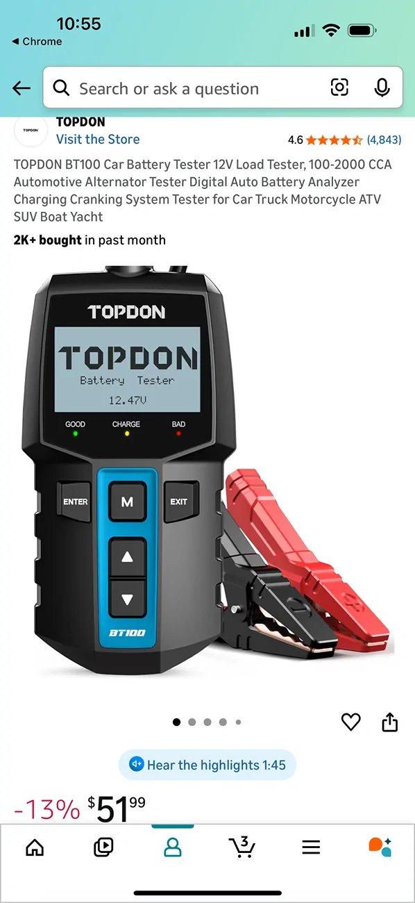

1) Is there something better than a load tester/is there something it misses that perhaps other (digital) testers might pick up on? I was always inclined that the converse was the case.
