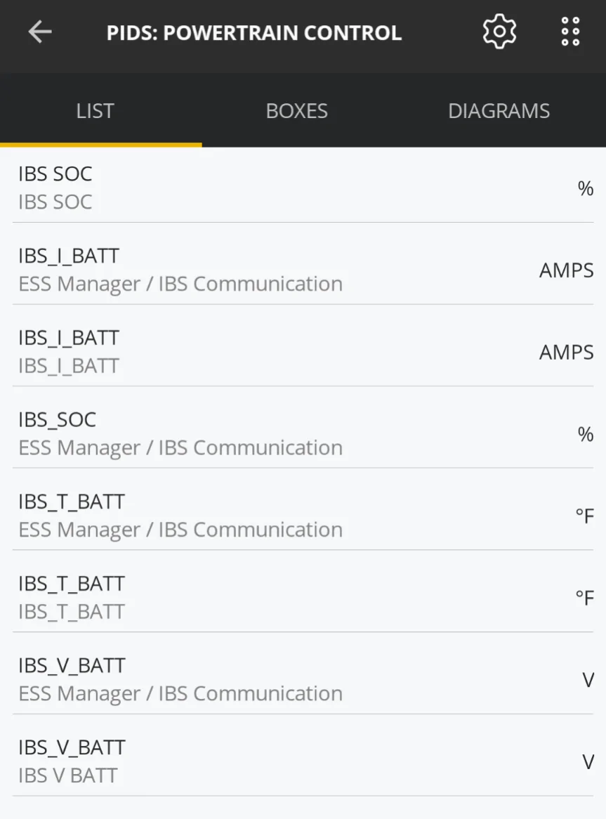

That statement might not mean what you think it means. It's very likely the IBS (when present) affects voltage/charging, such as for battery temperature compensation and lowering voltage when the battery is deemed charged.
I can tell you for certain the PCM collects IBS data, including SoC and current. In fact, it has a separate set of IBS PIDs specifically not labeled "ESS":
Jeep Wrangler JL Which Battery Tester? Screenshot_20251024-235141

What's your point? Yes, the IBS sends data on the CAN LIN Bus. And other modules clearly collect that data.
Do you have some other explanation for the JScan image I provided that clearly documents the PCM is aware of IBS data?

Just because the IBS sends data doesn't mean the JL makes actual use for the charging routine. I don't doubt that as a JScan promoter for reading IBS data you said "the PCM collects IBS data" to imply that the PCM uses that data for charging.
