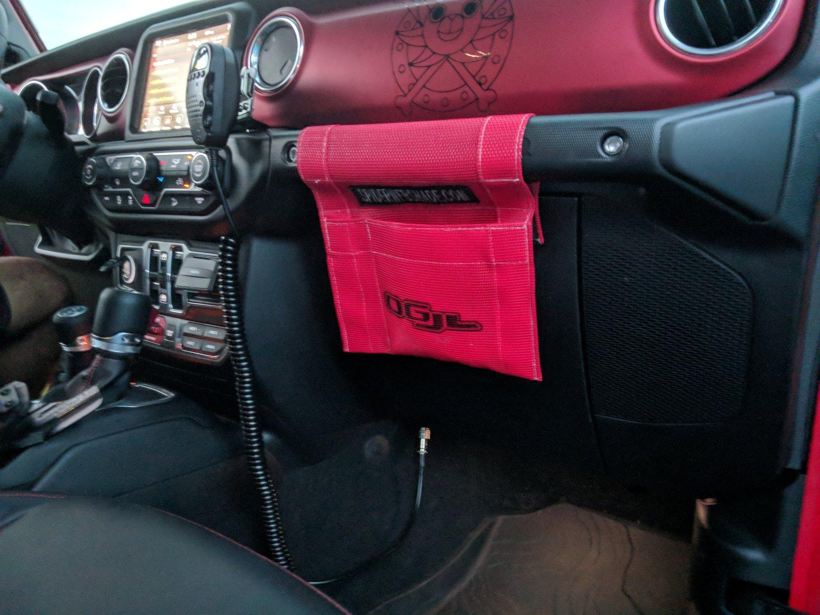

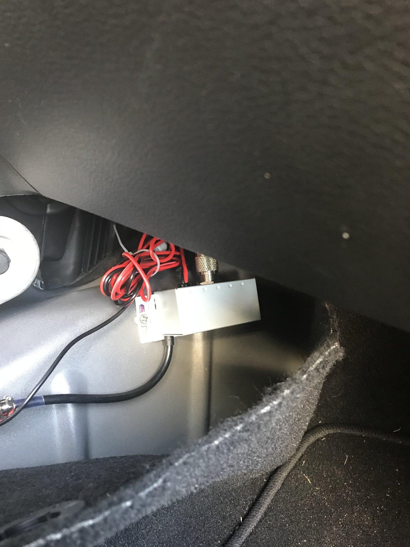

I insta;per my 75 last weekend with the cool tech kit. It was very easy to install. I ran the antenna cable under the trim pieces along the passenger side to the front passenger floor boards. A lot of patience and use of trip removal tools made it pretty seamless. There are even little clips that the wire clips into along the door sills. Up under the dash there is a 12V switched accessory wire that is terminated. This is what I used to power the radio. Tested the SWR yesterday and the meter barely even moved. It is a very well matched kit.

Nice setup! Did you just drill a hole in the transmission tunnel and mount the box with a metal screw?
DocJLU
Richard
Apr 28, 2018
92
40
Pinehurst, NC
2022 392XR
Yes, for now. Plenty of clearance in the tunnel (3/4” screw can’t be seen behind the insulation). Eventually will put in a machine screw.

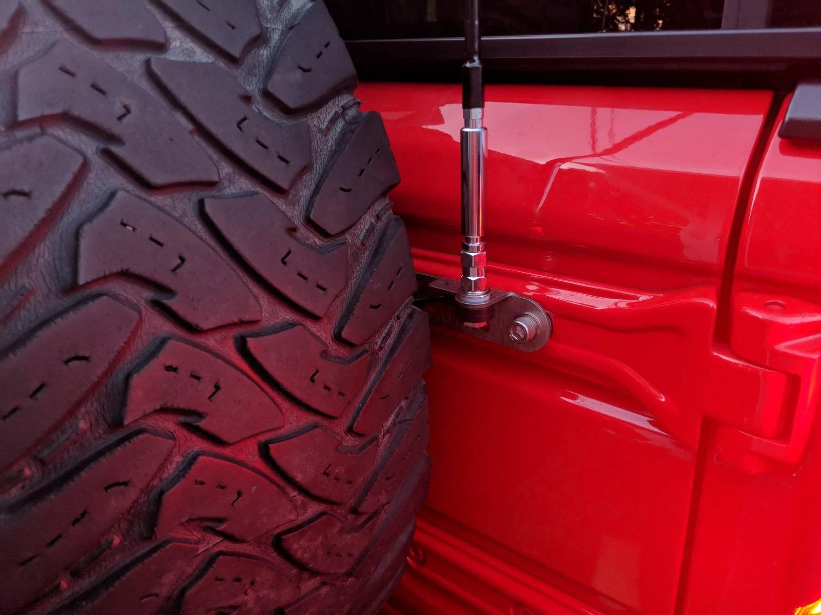

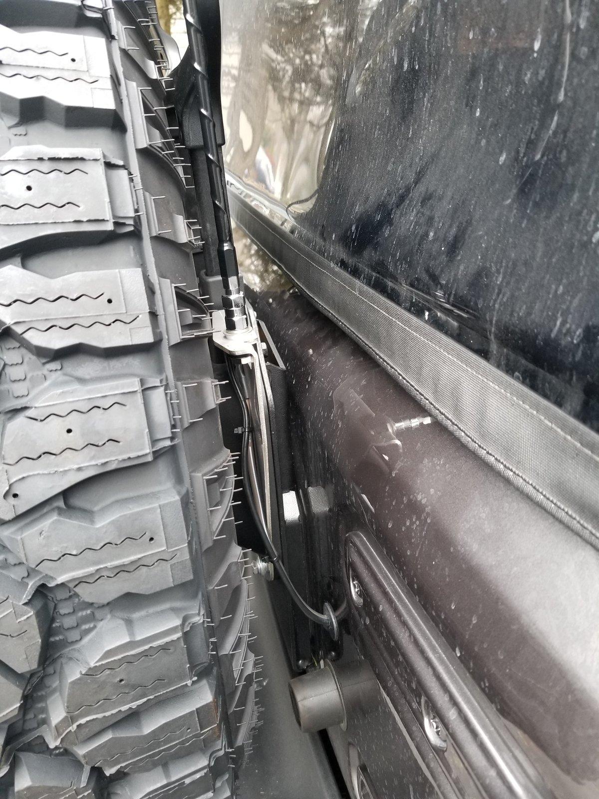

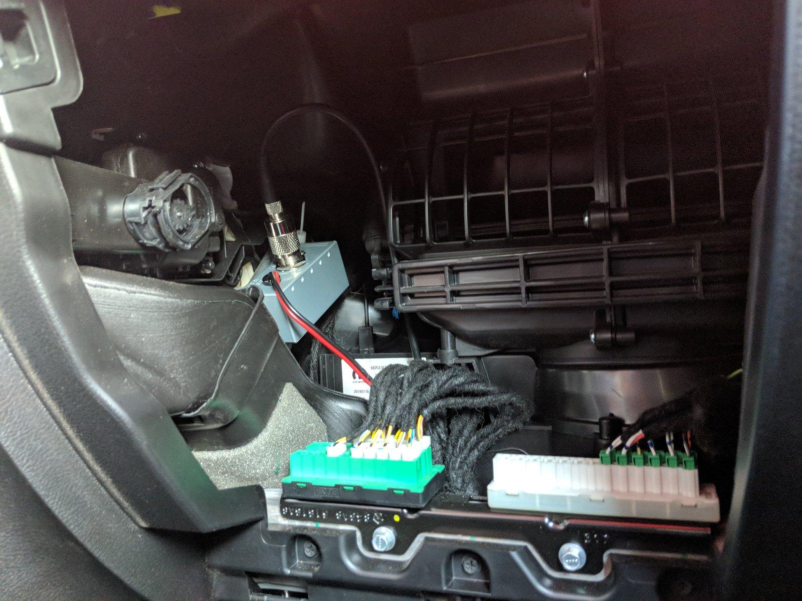

Got my cooltech antenna and Cobra installed. I put the brain behind the glove box and it worked awesomely, I have it hooked up to the accessory power from the aux switch and grounded it to the body. I got a swr of 1.5 and it's doing fantastic so far. The only issue I have is that the bolt on the tailgate is right up against the tire, but it's fine for now.

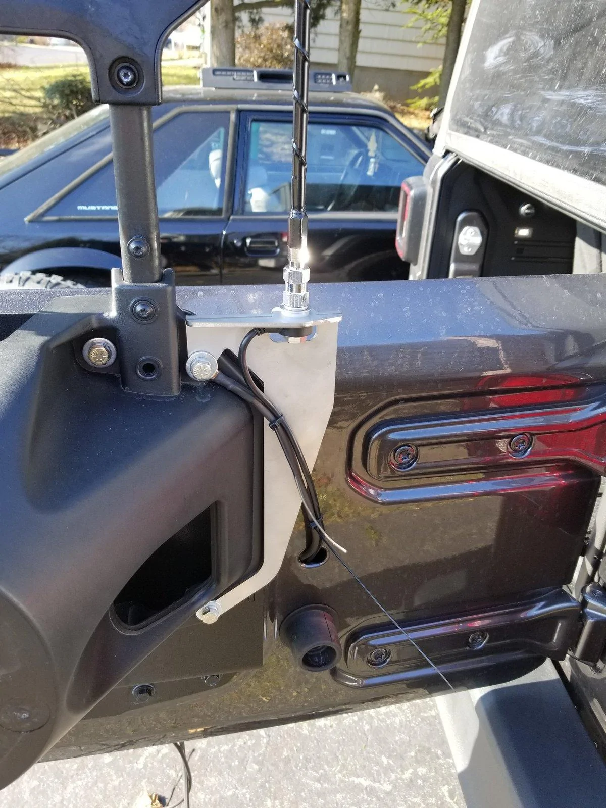

Had I better Hindsight, I would have put cb antenna in first on tailgate. I’ve already put tailgate table on and now have to disassemble all that to get to access hole for antenna. Oh well

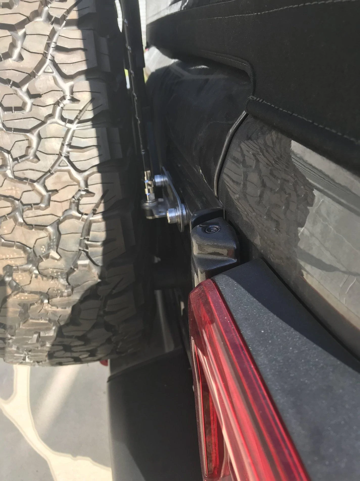

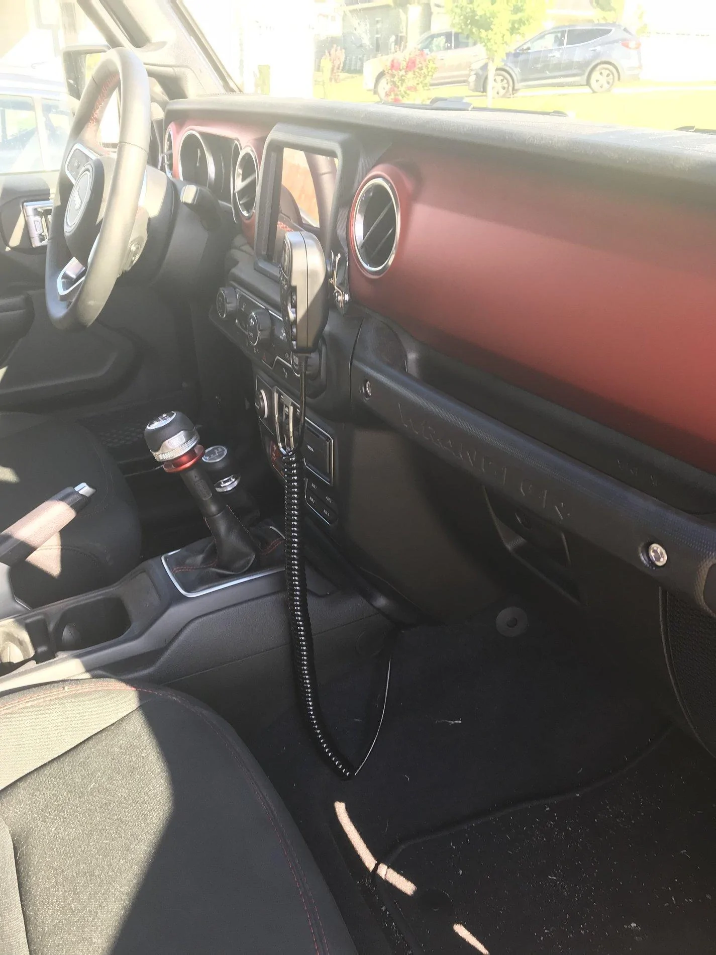

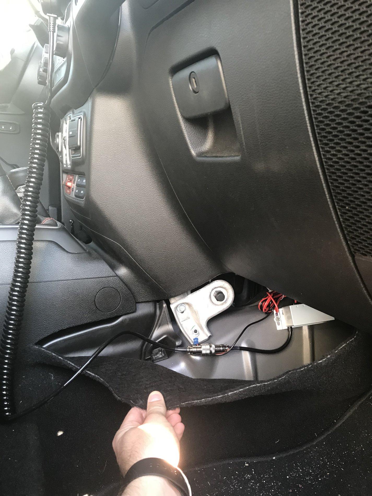

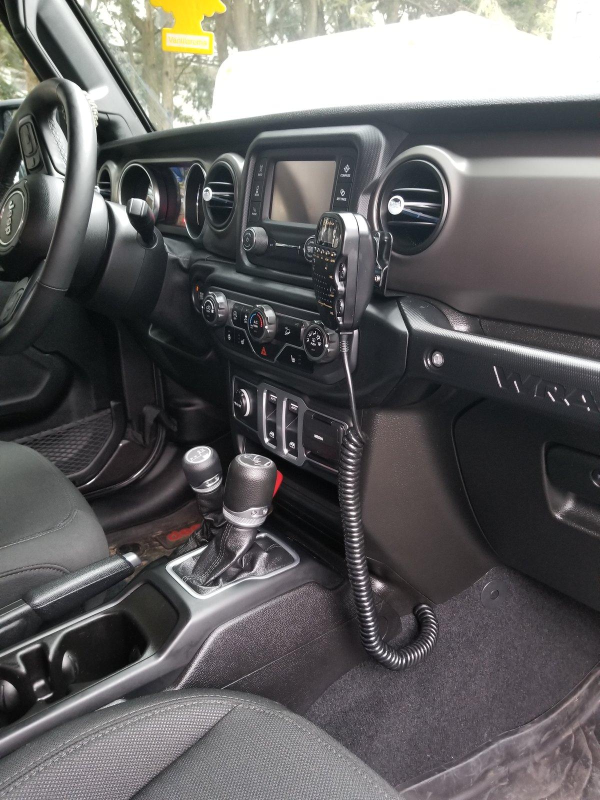

Typical Cobra CB install. Went with CB antenna kit on quadtratec. Very sturdy and easy to install.
