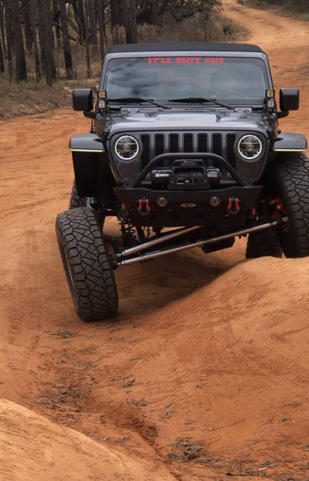

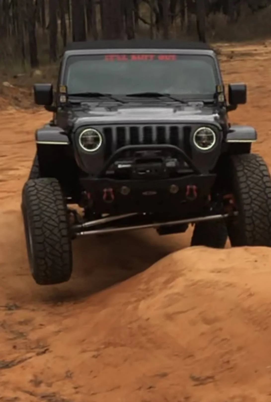

This is just a small sample size of connected and disconnected….. I think that the weight of the Jeep coming back down would be more of a stress on suspension than letting it roll with the terrain…..also if you’re running open diffs when that wheel comes up all the traction goes to the path of least resistance. Then you have to butter the throttle a bit to kick in the bld….If all four are on the floor, then you roll right through with all wheels pulling and not missing a beat… again these are just a couple reasons to run disconnected it doesn’t mean you won’t get through the obstacle…….and I’m not saying that little bit of off the ground is going to hurt anything, this is merely an example…….
