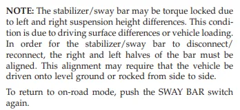

After my suspension was installed, I have to slightly (like barely) rock the Jeep side to side before the sway bar disconnects or connects back. I don't recall needing to do this before but then again, I didn't disconnect it often.
Is this pretty normal? (and yes, I'm on level ground - in my garage)

It's a set of gears that mesh and unmesh (when disconnected). Sometimes you get "gear clash", sometimes you don't. Very normal.
Just drive the Jeep a few feet and it will perform the lock or unlock as you change the mode.

Do you have adjustable sway bar links with the new suspension? If so, adjust the lengths so that the bolts fit through the holes in the sway bar without putting any torque on the sway bar. Do this with the sway bar locked. This should ensure the splines are aligned when the Jeep is on level ground.
I'll be honest, I don't know. I believe they might but I'll verify and adjust. Thanks for the idea here.
