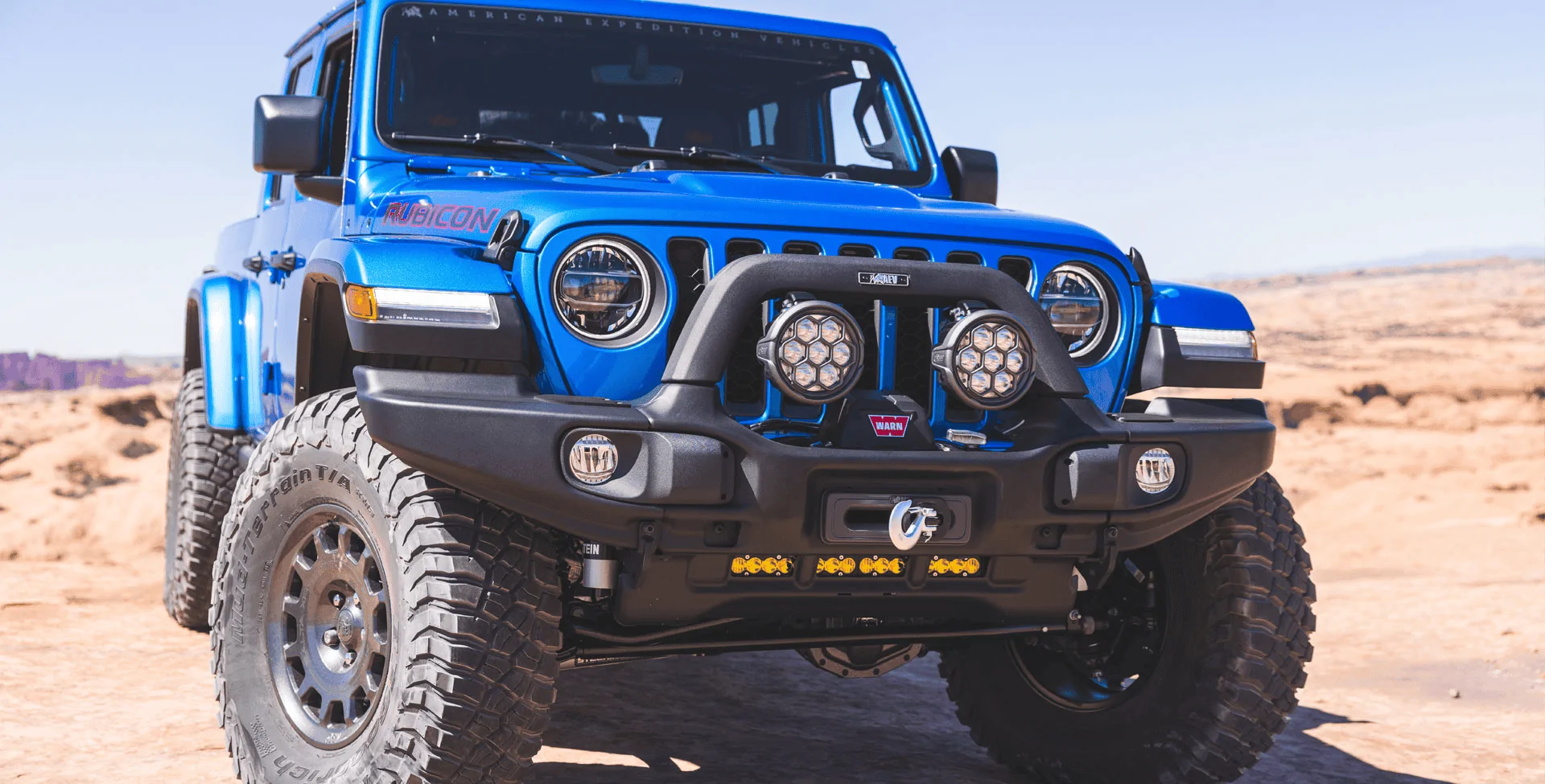

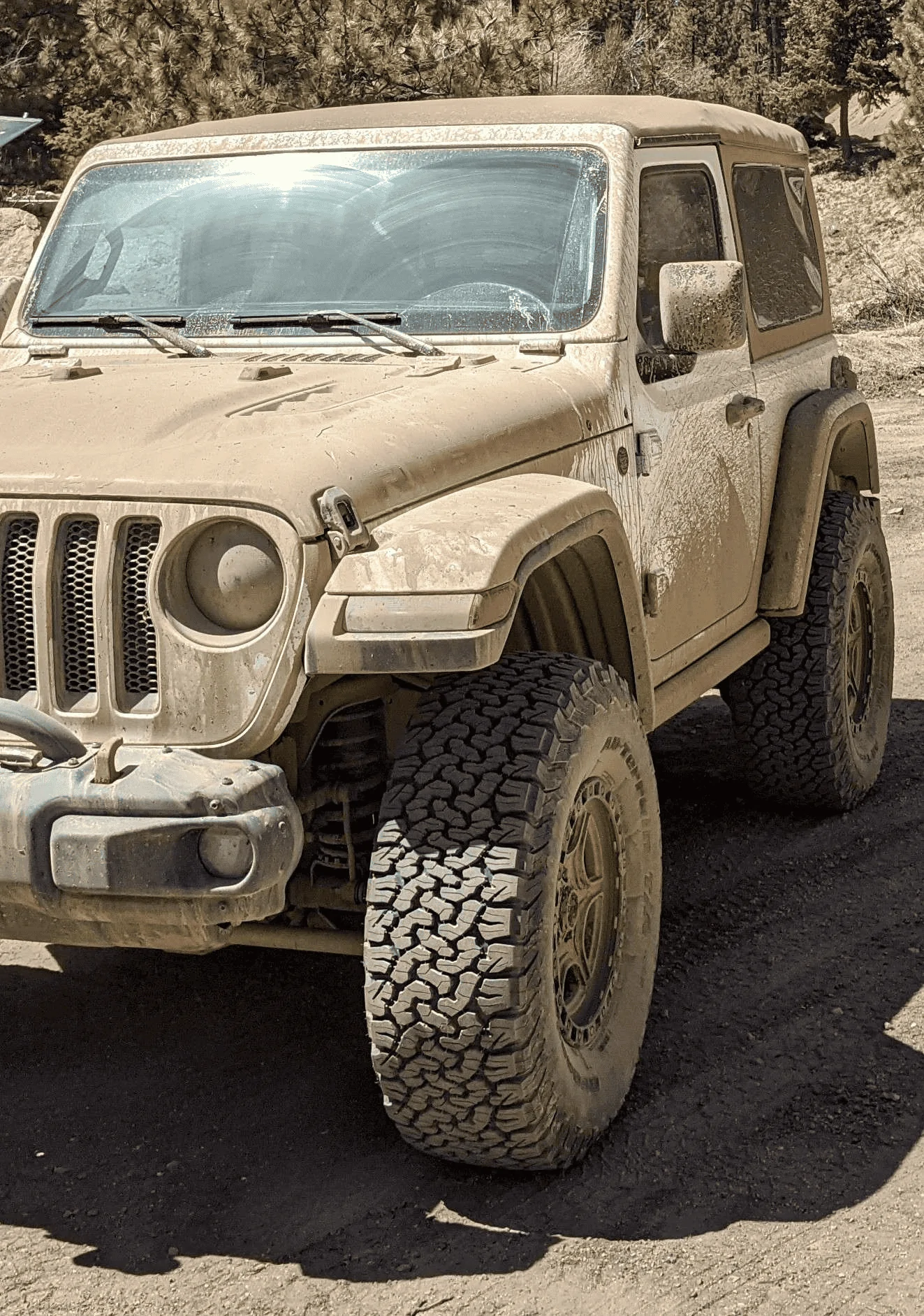

I did a lot of looking around when I purchased my wheels because I also wanted to keep my fenders mostly functional and keep my tires under the jeep. I went with wheels with a +18 offset and for the tightest fit I think, AEV's +25 offset is the best when going larger tires. I'm sure wheel spacers could be used with other wheels with more positive offset but that is something I did not want to do. The first picture is my jeep with XD Portal bronze 17x8.5 and the second picture is AEV SaltaXR 17x8.5, both with 37x12.5 tires.

Thank you very much. Great examples and I also appreciate the pictures. I have to say that I very much like the appearance of the AEV SaltaXR 17x8.5. I will definitely look into them. Congratulations on a beautiful jeep.
