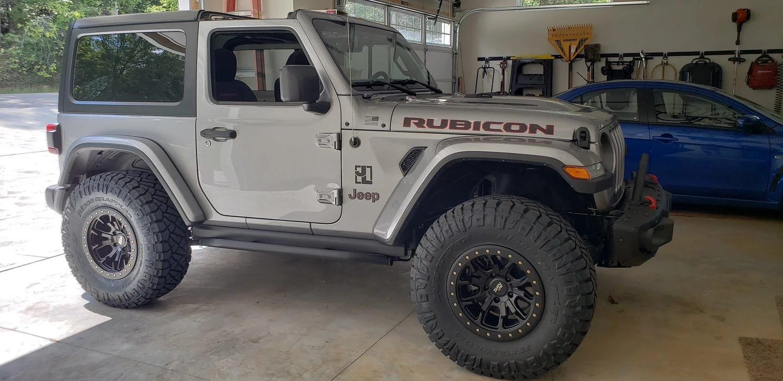

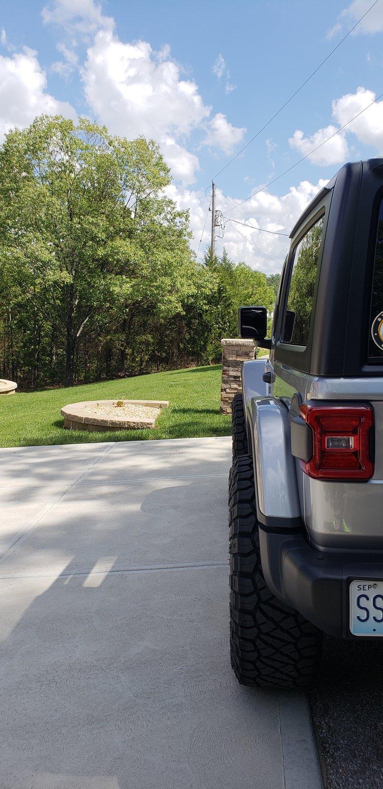

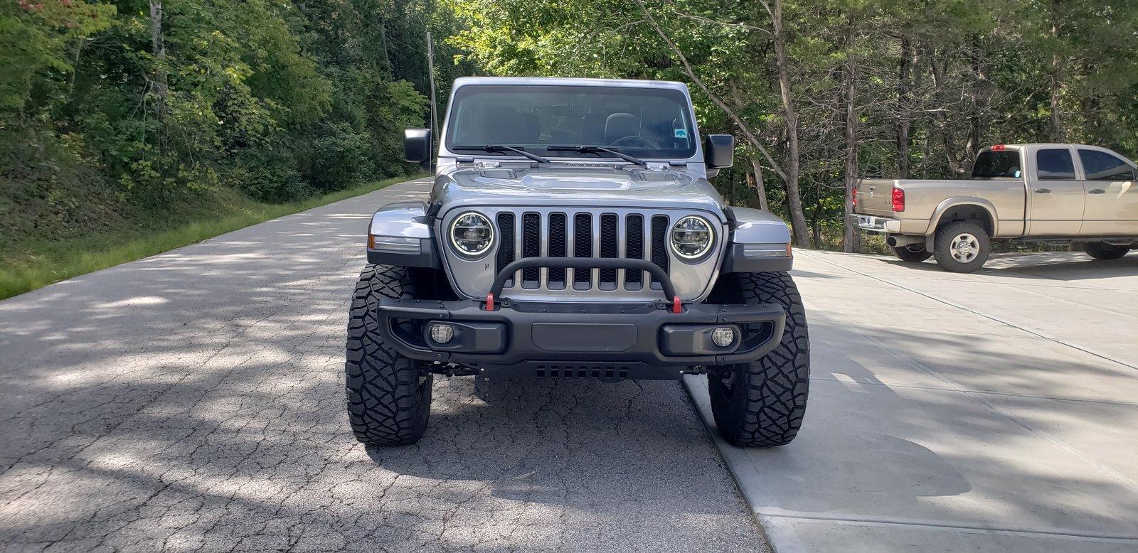

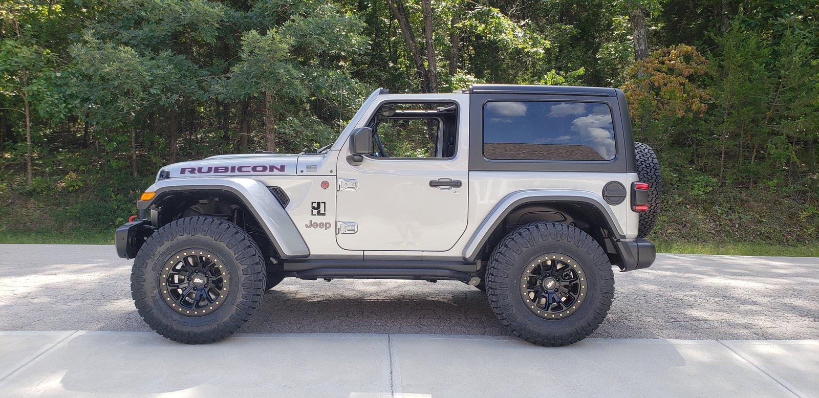

Here is a 17x9 wheel -12 et with 35x12.5 r17 tires.
