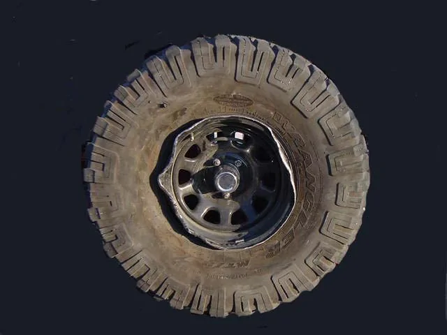

some of the best wheels for the money are from quadratech...OEM look but 8.5 wide with proper backspacing/offset....I know some think steel is great but try pounding this back in shape...I have never damaged a cast wheel bad enough to have to change it on the trail...
