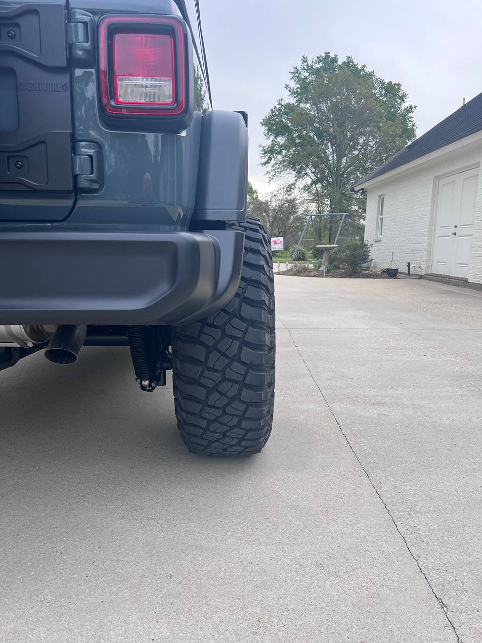

PetroChemicals
This is 35x12.5 on a 9" wheel with -12 offset
Jeep Wrangler JL Wheel Offset Advice for new Willys 41 IMG_2125
