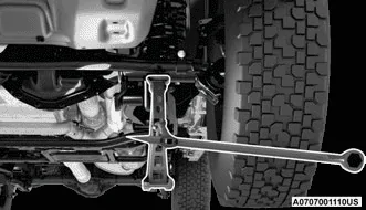

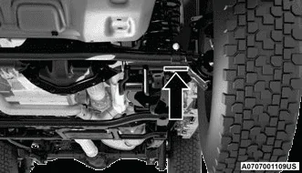

The manual indicates lifting from the axle on both the front and back:
Jeep Wrangler JL What's the jack point for front wheels? 1689605091503
Front lifting point
Jeep Wrangler JL What's the jack point for front wheels? 1689605124751
Front jacking location
Page 296 of the manual. Granted this is for changing tires, so by sliding inboard a bit with the jack you should have enough room to place your jack stand under the axle as far outboard as you can without interfering with the movement of other components.
