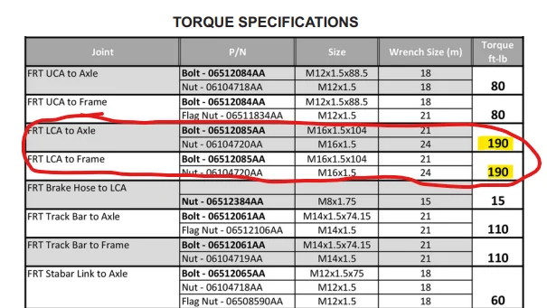

Is it acceptable to torque the Front LCA if the axle is sitting on 2 jack stands?
Is 190lbs the straight torques value most are using for the axle/frame ends of the LCA?

It depends on the joint of the CA. Best practice and for most CA joint designs, they should be torqued when the Jeeps is on the ground sitting in it's natural, level position. Imagine tightening suspenders for your pants while bent over and then trying to stand up. With the Jeep in the air you might tighten a bushing in a flex position and then twist or damage it when lowered to the natural ride weight/position. Torque value can also vary depending on the brand of CA. If you can't find the specific value for your brand of LCA, I think 190 ftlb is the factory torque for both ends of the LCA.

I am pretty sure that it is 190 ftlb on both ends, and you will want to torque them when the Jeep is sitting on the ground. Do you still have the kit instructions? There should be a torque chart included with it.

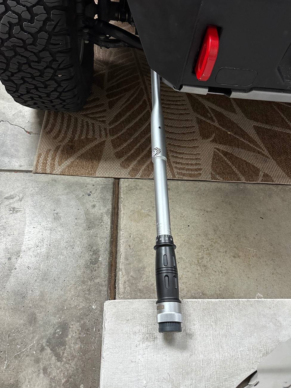

I doubt yiur vehicle’s joints are going to notice a couple degree difference. I pull up on ramps so i can use my long handled torq wrench

I use a jack under the torque wrench to get the 190# with the limited clearance of Jeep on the wheels.
