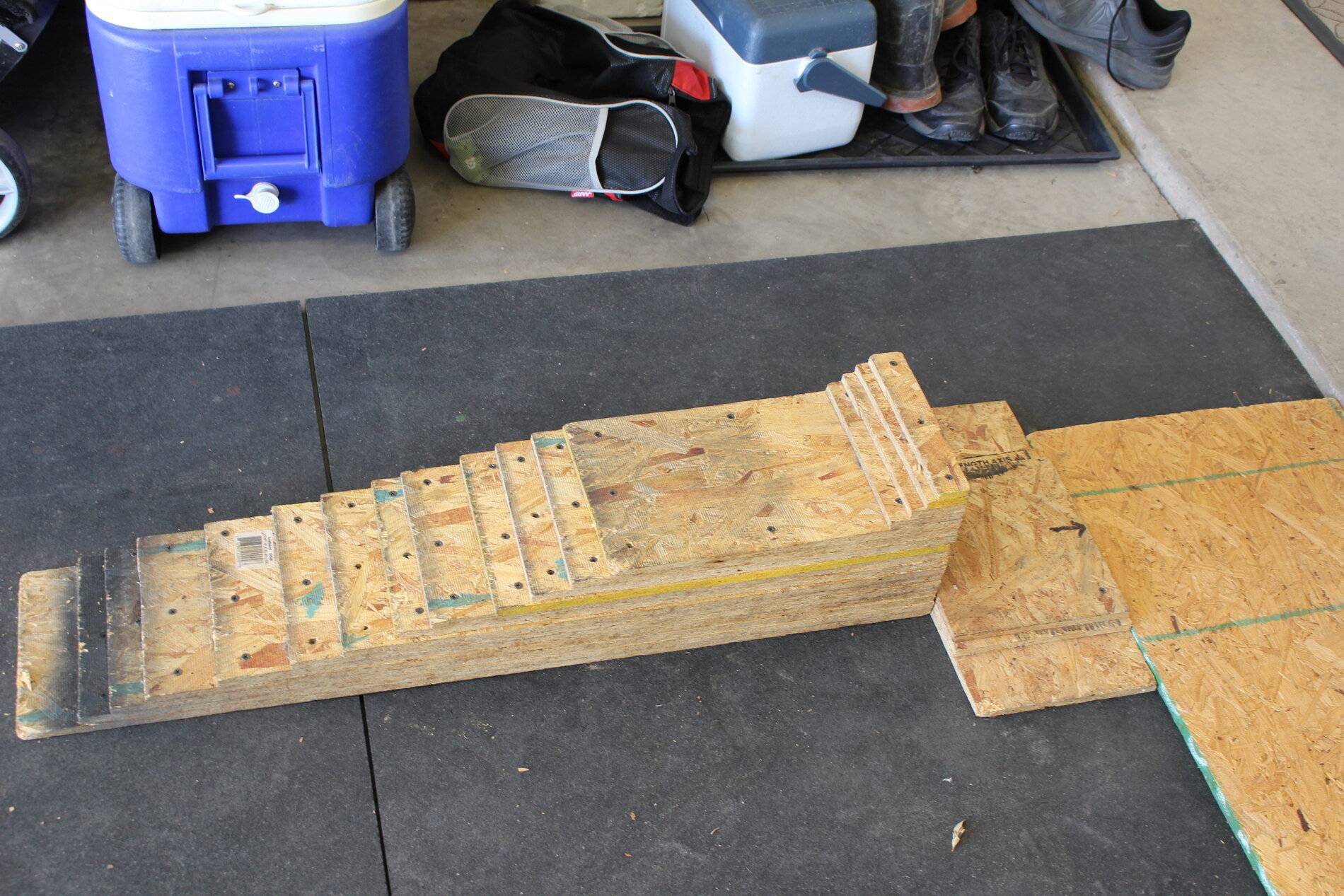

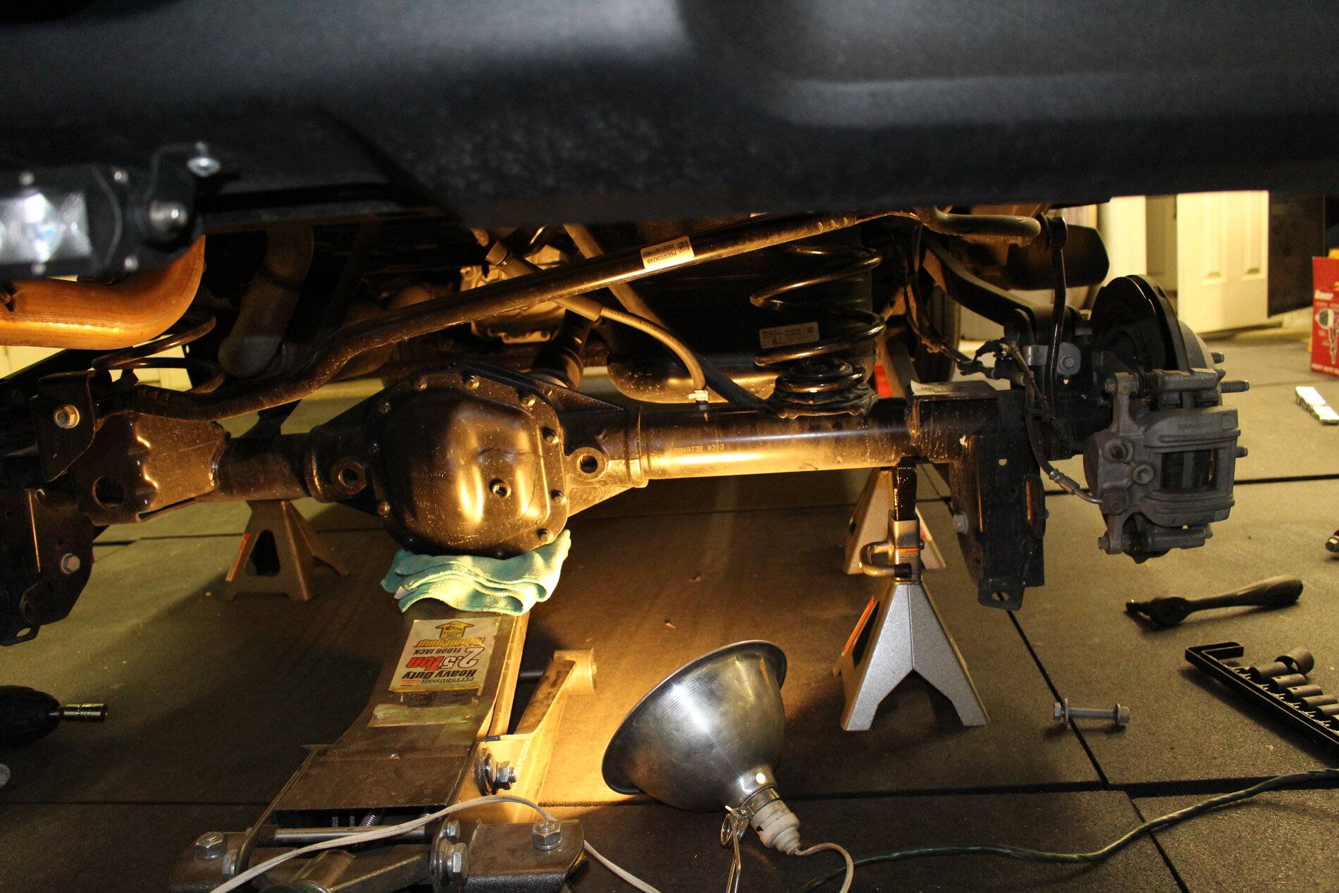

Something like this?
one of my co workers suggested cribbage. He’s a volunteer fireman and said they use it to support fire trucks.
And I use stacked OSB (when it was $40 cheaper per 4x8 sheet than it is now :( ) for my ramps, much stronger than the pressed steel garbage.

You could also put your jack on some stacked OSB if you need a couple inches more lift. but only if you still have some of that $7 OSB laying around lol.

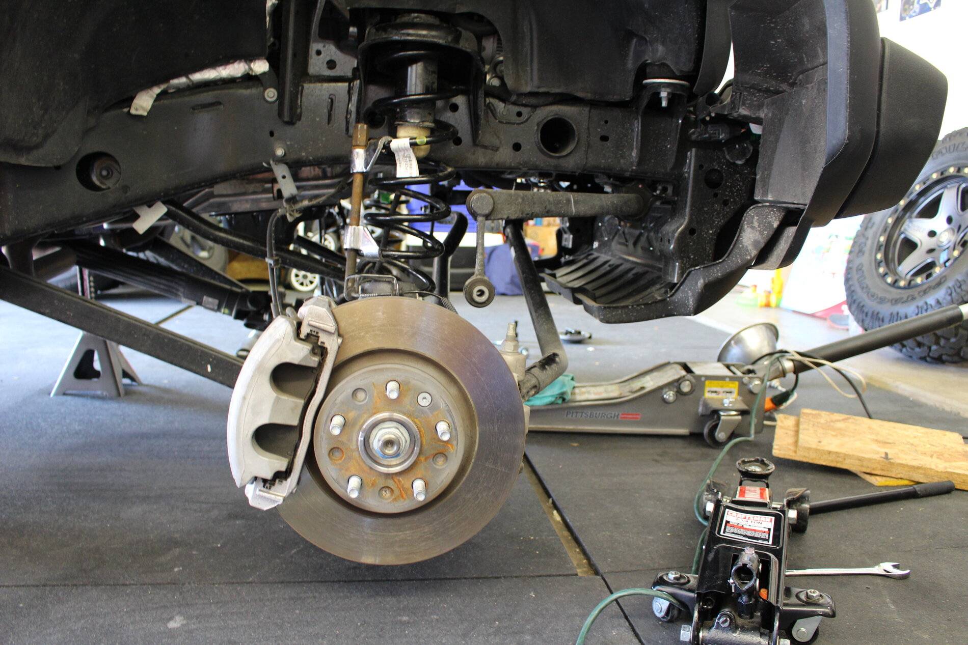

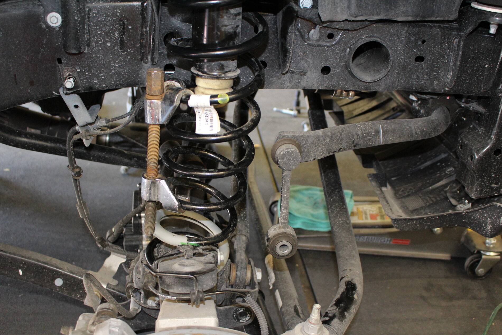

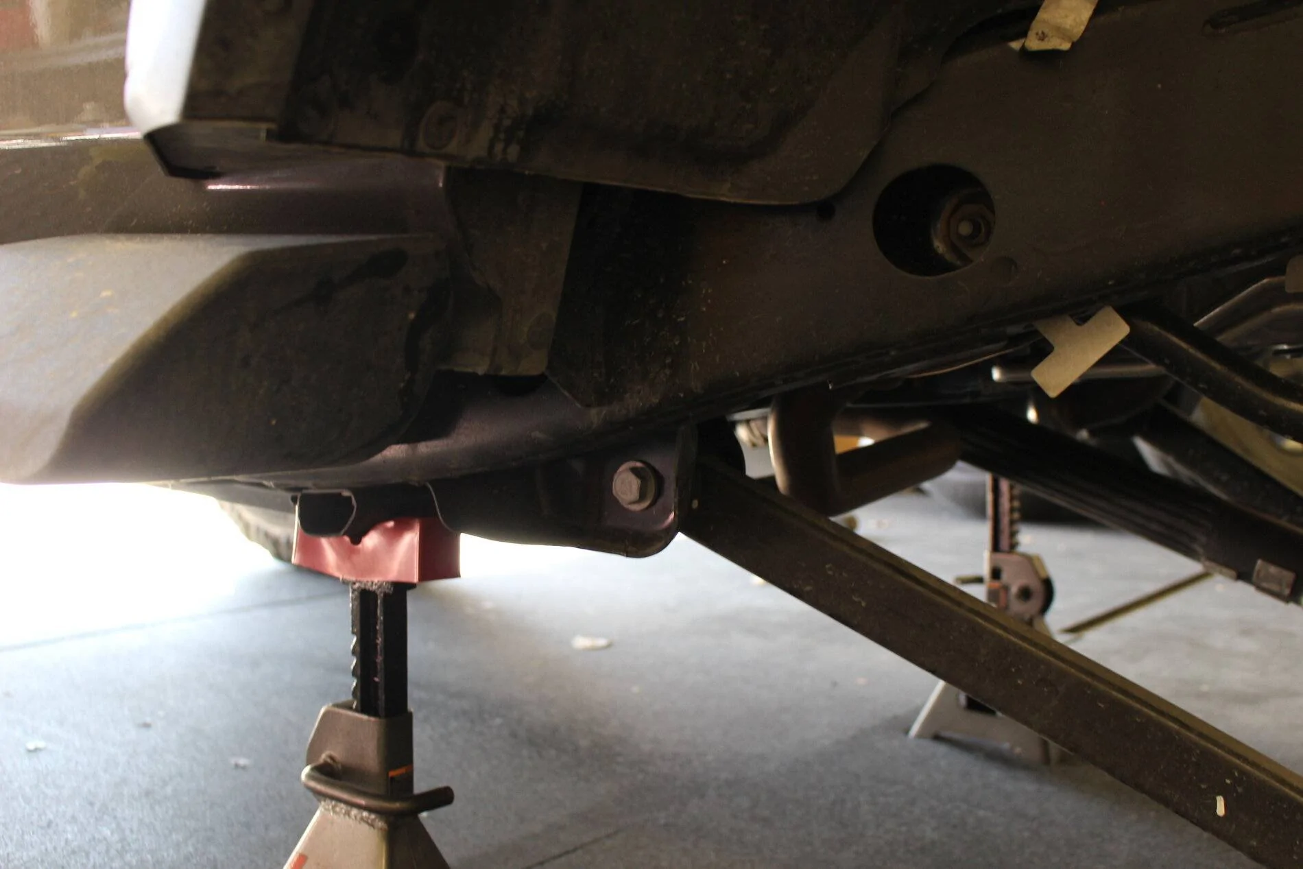

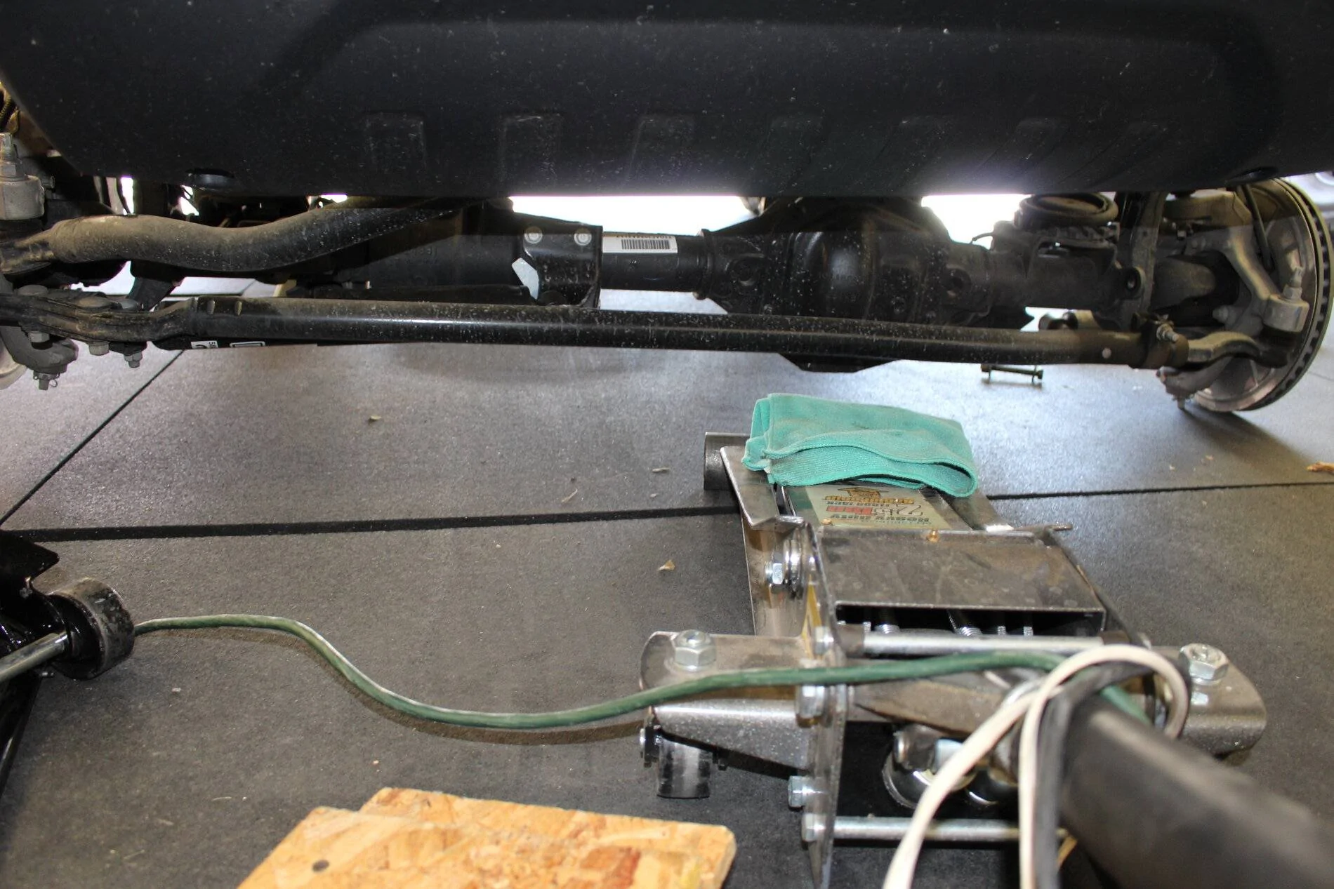

This isn’t the only way to do it, but this works best for me. And after dozens of lift installs on my garage floor over the past 3 years, and my age, I’m not gonna be looking for a better “mouse trap” now…….? .
Pretty much what I do too, although I haven't done it 100 times like you have @Roky lol

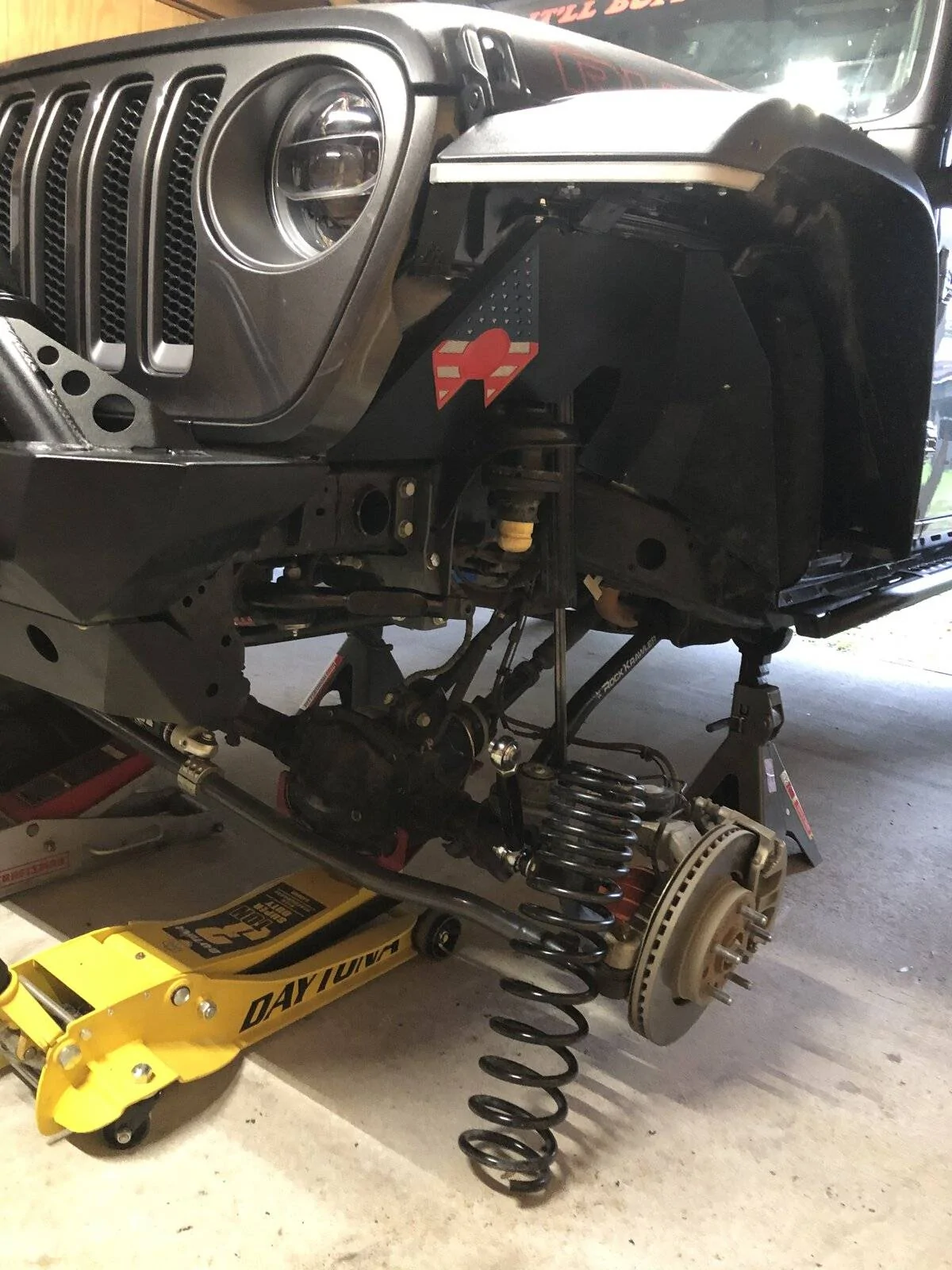

I just looked and took some measurements. The jack stands I used were 5 ton, and based on the notch I used (which is the notch that has the lithium grease from where it got stuck), I had just about exactly 18" from the bottom of the stand to the bottom of the U on the support.
This gave me more than enough room, and I moved the floor jack from position to position as I went around, in order to control the descent and ascent of the axle.
As far as jacking, I used an approximately 4" x 4" x 2" hunk of red oak between the jack and the pumpkin in the rear, to get extra lift, and reduce the chances of peeling the diff cover. I'm sure this isn't a recommended practice or a recommended jack point, but it's what I had to do to get the job done, and I didn't let any of the slippy juice out of the pumpkin.
The front was more tricky. I had to do one side at a time, and I lifted by the lower control arm bracket, which wasn't the most stable jack point. The lower the jack point, the more use you get out of whatever lift your jack has. I jacked up side one, put it up on a stand, lowered the jack, then repeated on the other side. It was a little sketchy with one side up on a stand and the other down, but it was the only way I could find to get it done.
Both of these operations would have been safer now that I have diff and control arm skids.
Also, my original plan was to use one of those dual lift point spreader bars from Harbor Freight up front, to jack both sides at once. The only problem was, it didn't fit my jack, and Harbor Freight had just taken their jacks off sale, so I really didn't want to buy a new, expensive jack just to use that thing. I made do without.
I guess in retrospect, I didn't take the smartest, safest approach to this job. I got it done, but I could have been safer.

Yes, I used them for my lift. Felt like I was testing the universe, but fortunately no accidents.
For more detail:
I was installing a 2.5" lift, which I did over MANY weekends, since I kept running into weird issues (mainly since I was installing solo, while posted abroad, and it was my first time installing a lift).
For the front, I used spring compressors several times to get the springs on and off, until I figured out how much droop the axle really had - once I figured that out, I realized that the springs could just be pulled off once you got the frame high enough.
For the rear, I really didn't want to disconnect the e-brake, so I used the spring compressors to get the new springs in. Getting the compressors configured in a way where I could still wrench them was a huge PITA, until I realized that once they were in place, I could just jack up the rear axle, which would compress the springs more, and release the compressors.
Also, for extra height, I used wood blocks on top of the floor jack. For stands, I used a pair of 6 ton double locking stands on the frame, and a pair of 3 ton stands to support the axle.
