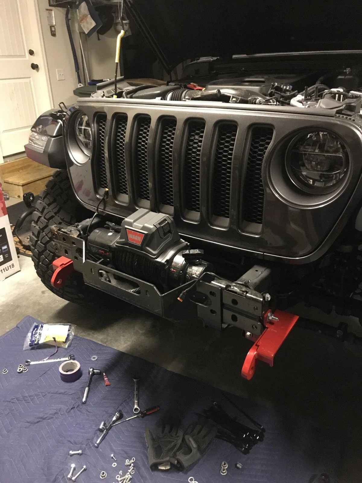

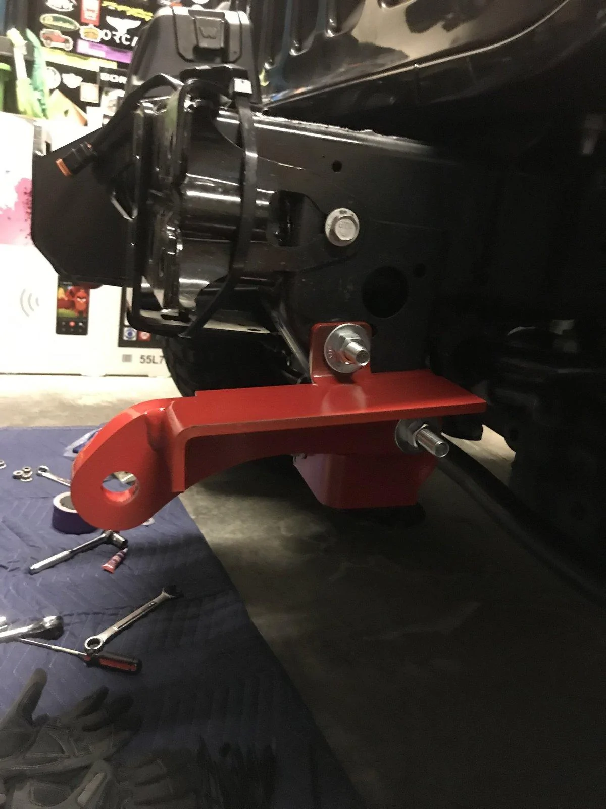

That is a warn winch plate and Warn Recover D-Ring Recovery and Hi-Lift Hack Points. You don’t need the winch plat to install the RPs but they do require cutting of the bumper
Can you attach a picture of the final cutout on your bumper:please:

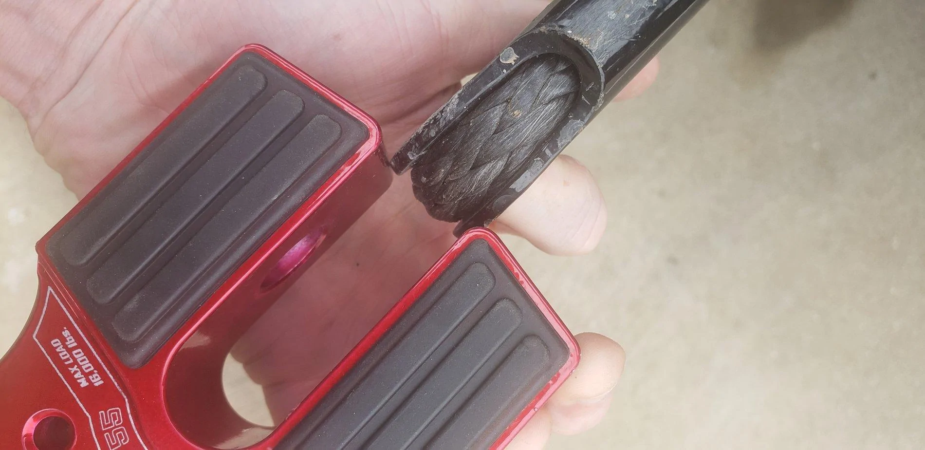

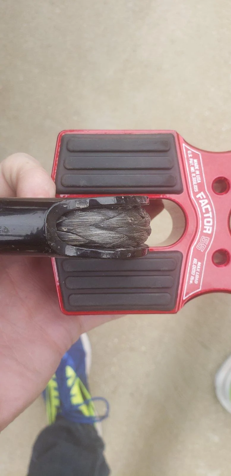

Good morning, folks. First time poster.
I've been perusing through this thread, and have noticed a number of you have a Warn VR-10S with a Factor 55 flatlink. I recently installed this onto my JL, as well, except the loop at the end did not seem to fit at all with the Flatlink. The only way it would fit was at an awkward (and seemingly unsafe) right angle, of sorts. Is there something I'm doing wrong, or did you have to make some kind of modification to make it fit?
A pic might help identify the problem

@runfellow
Looks like the ears on your thimble are splayed out a bit, not letting it fit in the flat link.
Stick it in a large vise and squeeze it or use a hammer and flatten those ears down just enough that it will fit the Flatlink. Doesn't look like it needs much at all.

Gotcha. As you can see, the eye of the rope is simply too thick for it, except if you put it in an awkward right angle.
Hmmm....didn’t have this proble with mine. I would second on using a vice or some other device to pinch the ends together to allow proper fit.
