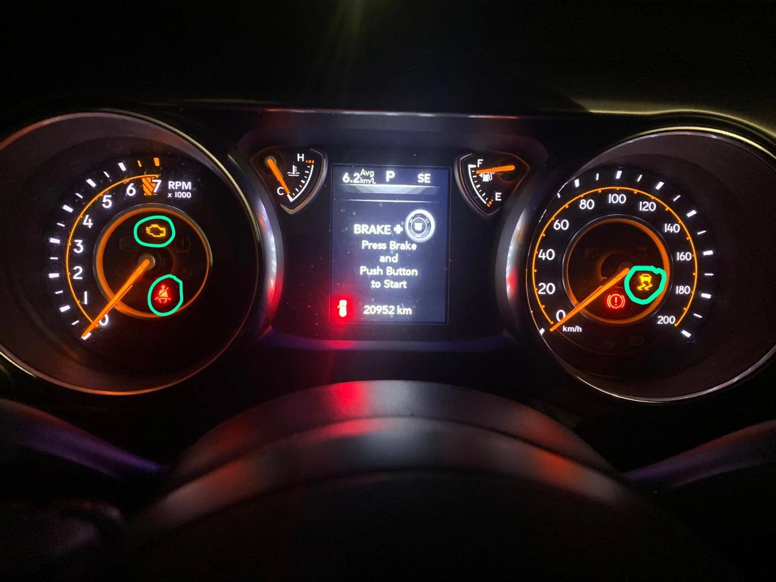

Hello dears,
please advice me regarding
1. My JL wrangler 2020 rollover in desert 4 times, after that, what are the precautions I need to take care
2. Can I drive the car since there are no indications are shown in instrument cluster
3. As of now only body damages are found
4. How I can make sure that no more mechanical issues in car (no unusual indication in cluster)
5. Some oil over flaws happened
need help to survive my wrangler from this incident

Bro, it happened from the top of the sand dunes(purely soft sands) , I am a lucky person to not having the injury. My wrangler stopped the rolling over after reaching the middle of the dune.
Did you get sideways on the dune? Dangerous. Glad you’re alright, if the Jeep still runs, it’s probably fine. Just take it to the shop and have them check it over.

Now, after the above, if he wants to continue to drive, there are lots to check.
For starters check all fluid levels and check for leaks. Consider changing all fluids. Pay special attention to fuel tank and fuel lines.
Inspect all wheels, suspension and seteering components engine/transmission/transfer case mounts.
Check alignment.
Check all seat belts, including pre-tensioner mechanisms. Check seat mounts.
If it drives well keep driving if you want, but why not just file a claim with insurance?

If your Jeep was resting on it's side or upside down for anything longer than a few minutes, some oil could have seeped into the upper cylinder (above the piston). If this has happened and you start the engine, you risk hydrolocking your engine. The result wil be a bent valve, connecting rod, etc. which will necessitate a rebuild at minimum.
To get any oil out of the upper cylinder(s), you'll need to remove each spark plug individually and then turn the engine over (without starting it.....which should be obvious) to ensure there's no oil in the upper cylinders. Have someone watch each spark plug hole to see if any oil is coming out (you can have them hold a white towel, napkin, etc. lightly over the hole and any oil will show up on it). Continue to bump engine over until no more oil is blown out. Re-install spark plug and then move on to the next cylinder. Continue with each cylinder until your are 100% positive all oil has been removed from the upper cylinders.
If you take all the spark plugs out at once, there might not be enough pressure in all of the cylinders to blow the oil out.
I'd recheck your oil level afterwards to ensure you didn't lose too much so you can drive home.
I've rolled a Jeep before and did this same procedure. Never had any engine issues.
Um, I’d agree, however I’d take ALL plugs out before cranking the engine. Oil in one cylinder that you try to “compress” can cost you and engine..

Not sure I’m quite understanding this train of thought. You’re saying if there’s oil in the upper cylinders there’s potential to hydrolock and bend a rod or something. That part I understand. But when you say to pull one spark plug at a time and turn the engine over each time, that part I don’t get. If you had oil in multiple upper cylinders and only pulled one plug at a time, you have successfully emptied one cylinder, but now every other one with oil in them has potentially bent a rod. I think you’d have to do all plugs at once to avoid that. And the pressure from having one plug out vs all of them out won’t change the pressure in the cylinders while cranking the engine over.
@Qjoh5510 and @Oldbear
I stand corrected. My memory isn't what it used to be and when I typed it out, it didn't really sound right. It was 13 years ago, so I called my buddy who was there (and a lot younger than I) to confirm what I did. The correct procedure is to take all the plugs out as you both pointed out. Not sure why I was thinking one at a time.....maybe I was confused with checking for TDC??
