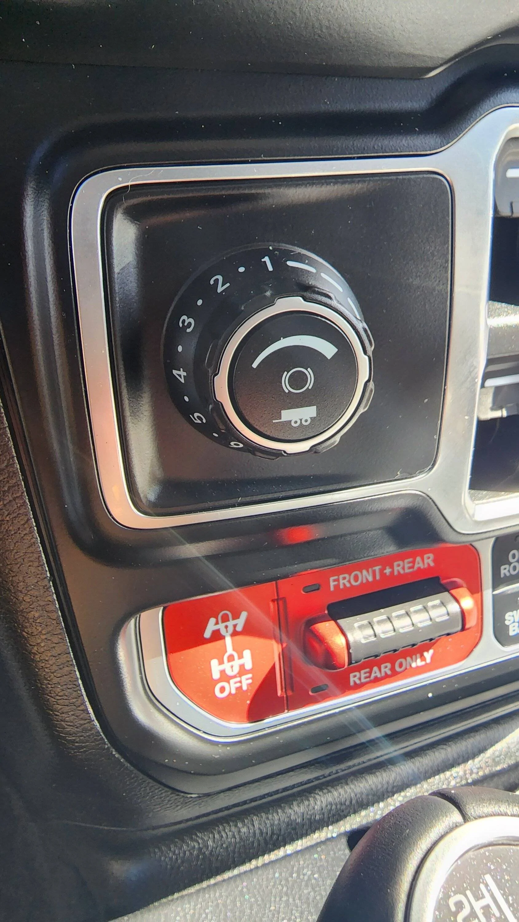

Mine came with trailer brakes, but I don't tow.
Anyone know how to remove it? Would rather have a USB port or 12v.

Attached are the install directions for the MOPAR Trailer Brake Controller. I assume that the instructions could assist you in reversing the installation process. Of course, you'll need to pick up whatever you plan on installing there. Hope this helps!

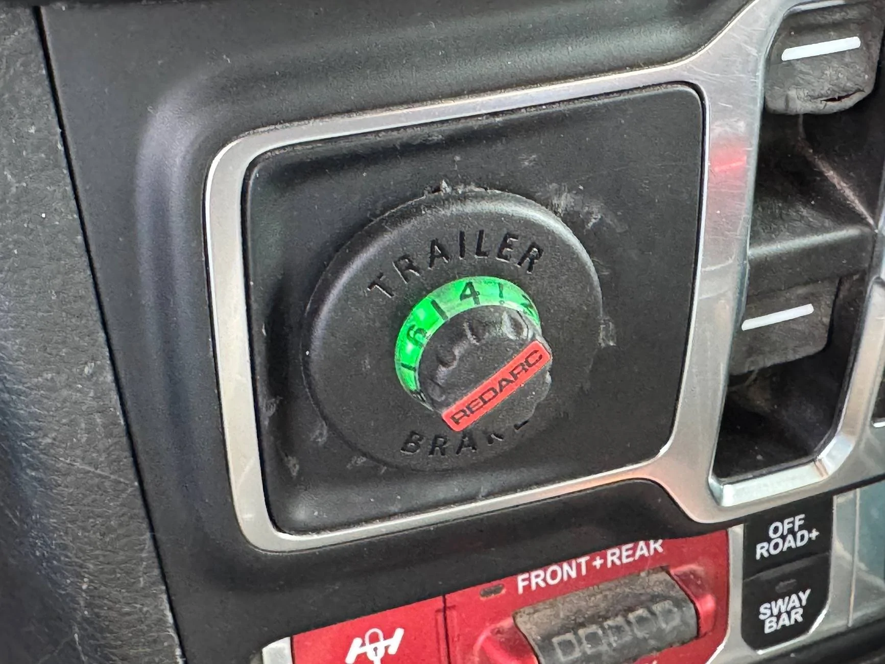

Just found this thread. I have a 2021 JLUR with the towing package. I didn't know about brake controllers until I noticed all my camping trailer towing friends have one installed. I went with Redarc since it's the one most of my friends use. The one I bought is specifically designed for Rubicons and Gladiators.
Install took about an hour, mostly due to the contortionist moves required to fish under the dash for the tow package wiring harness for to plug the brake controller in to. Once I found it, I plugged one cable to it and the left side of the Redarc device, and a second cable to the Redarc control dial (which I installed in place of the accessory port [cigarette lighter]) to the eight side of the Redarc device.
Once that was done, I drove for about 10 miles so it could calibrate. Then I attached the trailer (T@b 320S) and drove a few miles on and off road. I set the dial to 5 for on road (blue) and 4 for off road (green). It's quite a comfort having a brake controller. Never knew I needed it until I got one.
