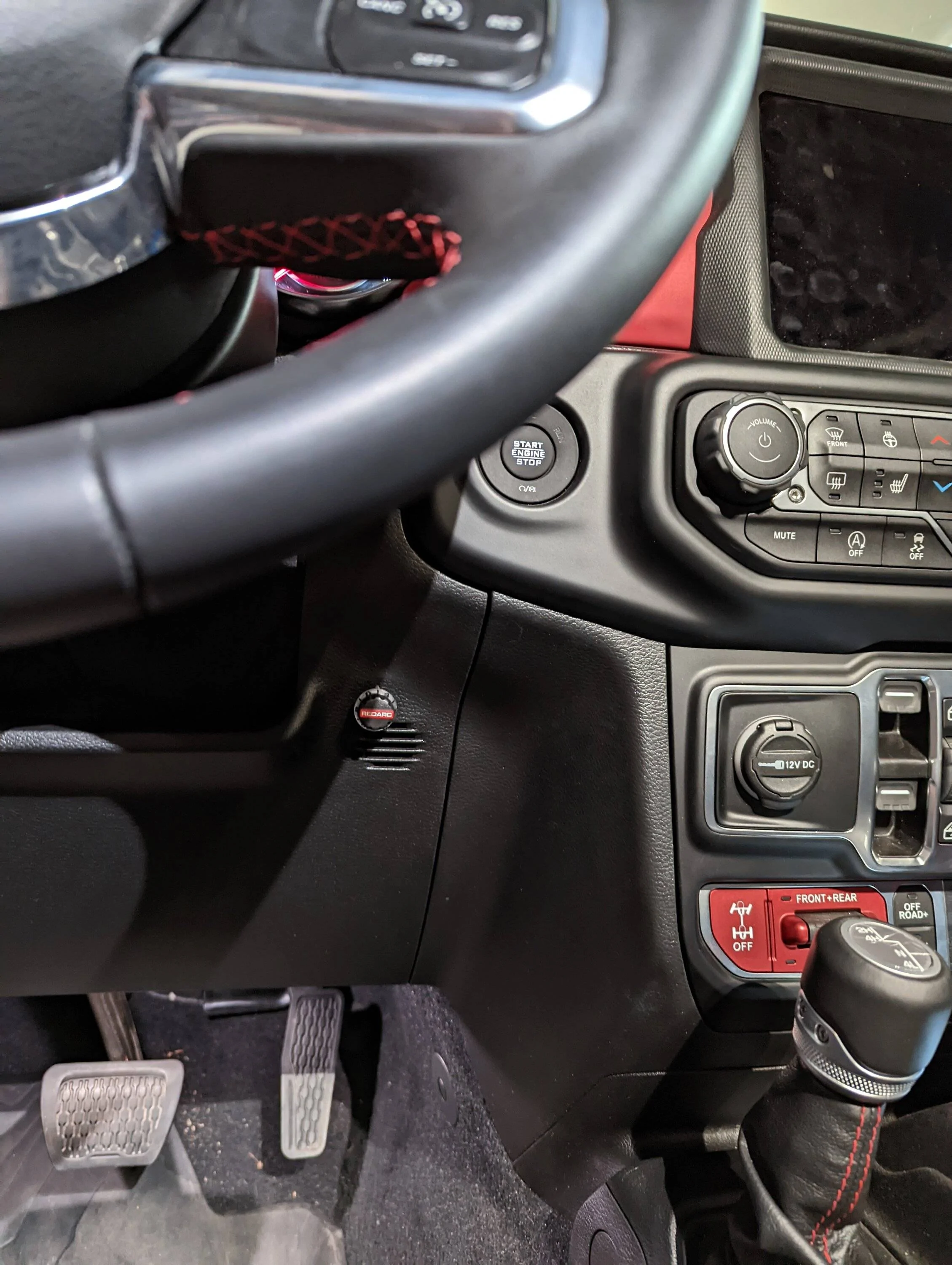

You need the brake controller to actually send power to the trailer's electric brakes, and the Jeep doesn't have it by default. I got the Redarc that you mentioned (https://www.amazon.com/gp/product/B08TPS46BX/ref=ppx_yo_dt_b_asin_title_o00_s00?ie=UTF8&psc=1) with the Tekonsha cable (https://www.amazon.com/gp/product/B08288R363/ref=ppx_yo_dt_b_asin_title_o00_s02?ie=UTF8&psc=1) and it was a two-hour install, with 1.5 hours of that due me being very picky about the button location and mocking its location up several times.
