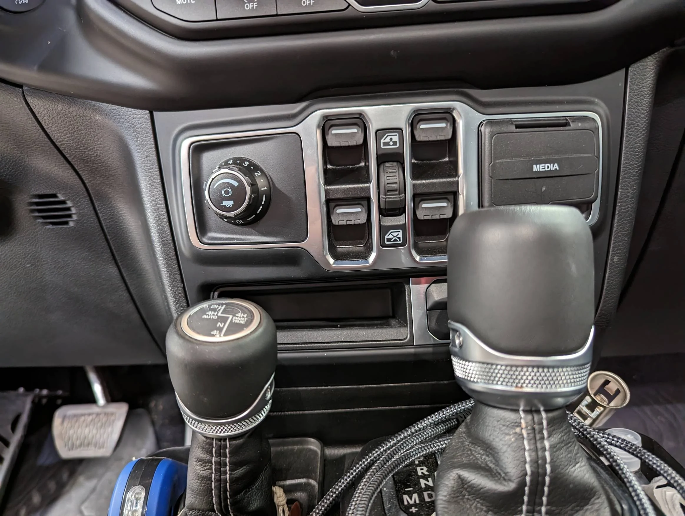

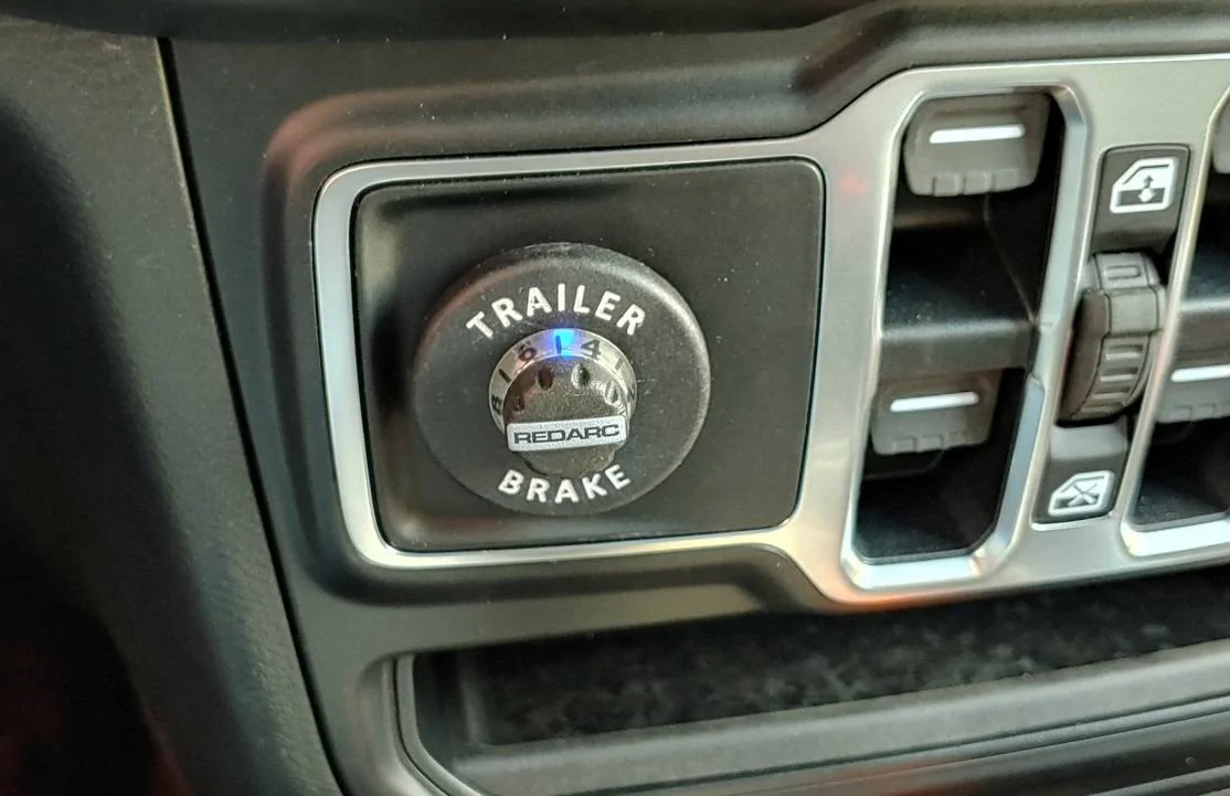

I've used REDARC and the MOPAR unit. I like the MOPAR for the looks, but the REDARC has a better, more beefy dial and control.
This is the MOPAR trailer brake controller in my 2022 -
Jeep Wrangler JL What is a brake controller and why do I need it? PXL_20230414_135129368
Don't try this with a 2023 or older Wrangler, please - a bit over 5,000 pounds...........
Jeep Wrangler JL What is a brake controller and why do I need it? 20210910_063711_HDR

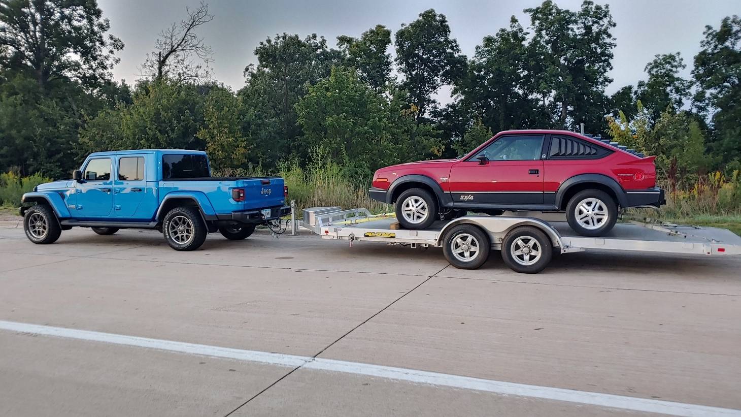

REDARC I had in my 2020 -
Jeep Wrangler JL What is a brake controller and why do I need it? 18-20200915_144204_HDR
