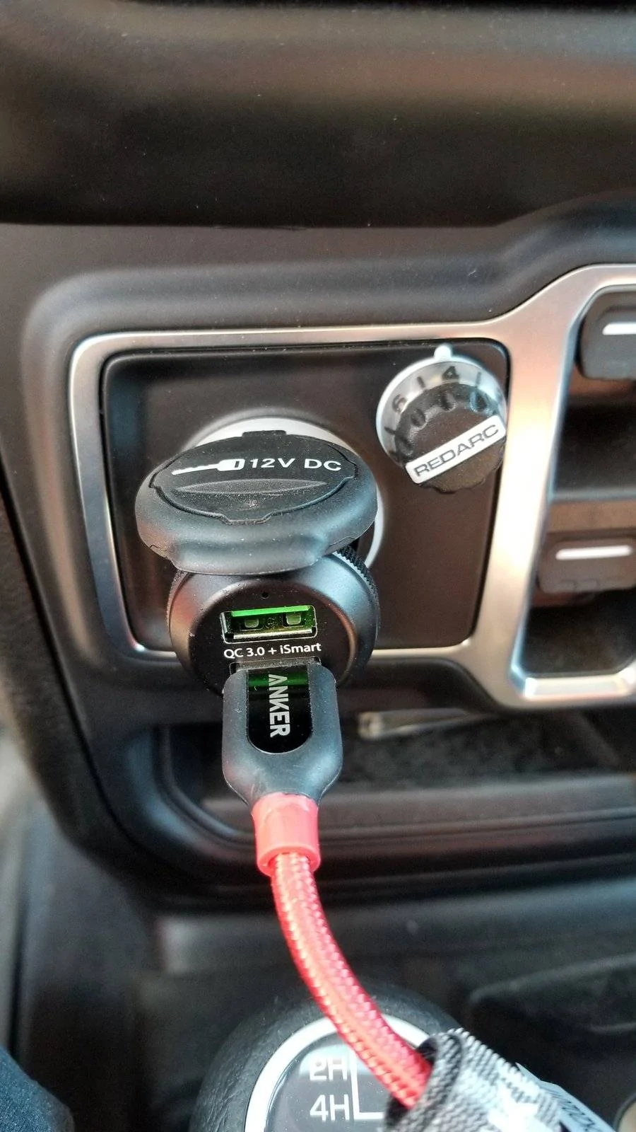

THe mopar brake controller is pretty nice, but it isn't anything special from what else is out there. After going thru the surprisingly difficult install of the mopar brake controller and seeing this photo I would do the redarc controller. I used the redarc on my JK and it worked well, and being able to fit the adjustment knob here is very nice. I do know that this install location isn't easy because there are lots of features behind the dash there that might make this a challenge, but it is my current recommendation for a brake controller - Redarc Elite Proportional

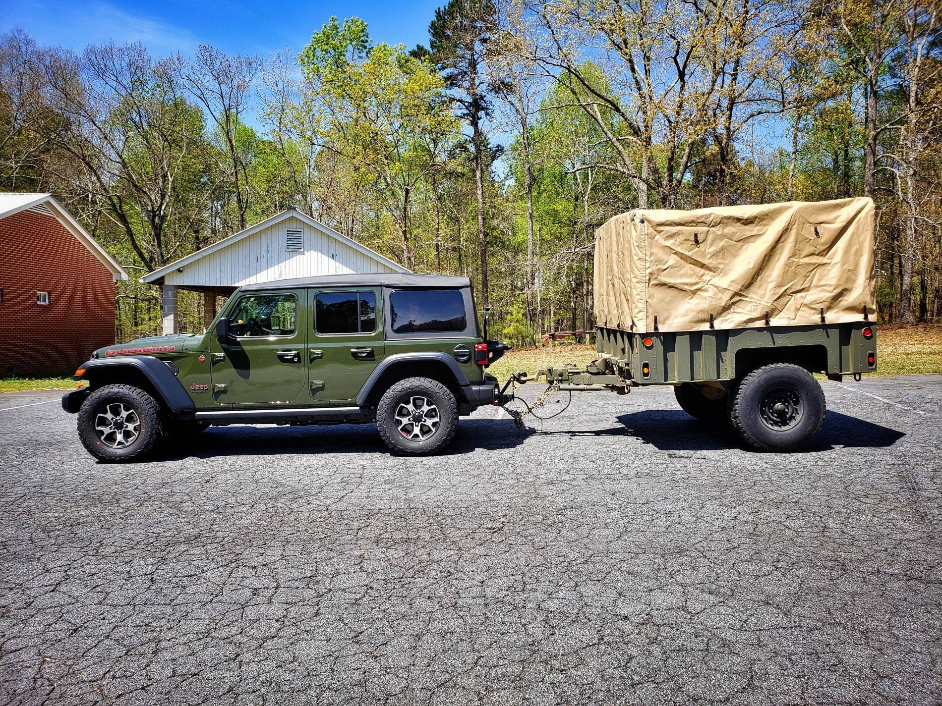

Going to electric convert the hydraulics on this m1102 and was debating the redarc vs mopar actually. I just don't want to deal with dash lights or any nonsense so thats why I was looking to mopar.
