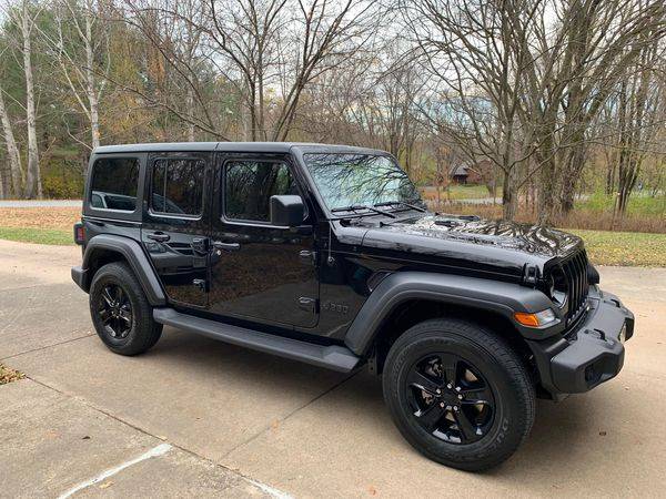

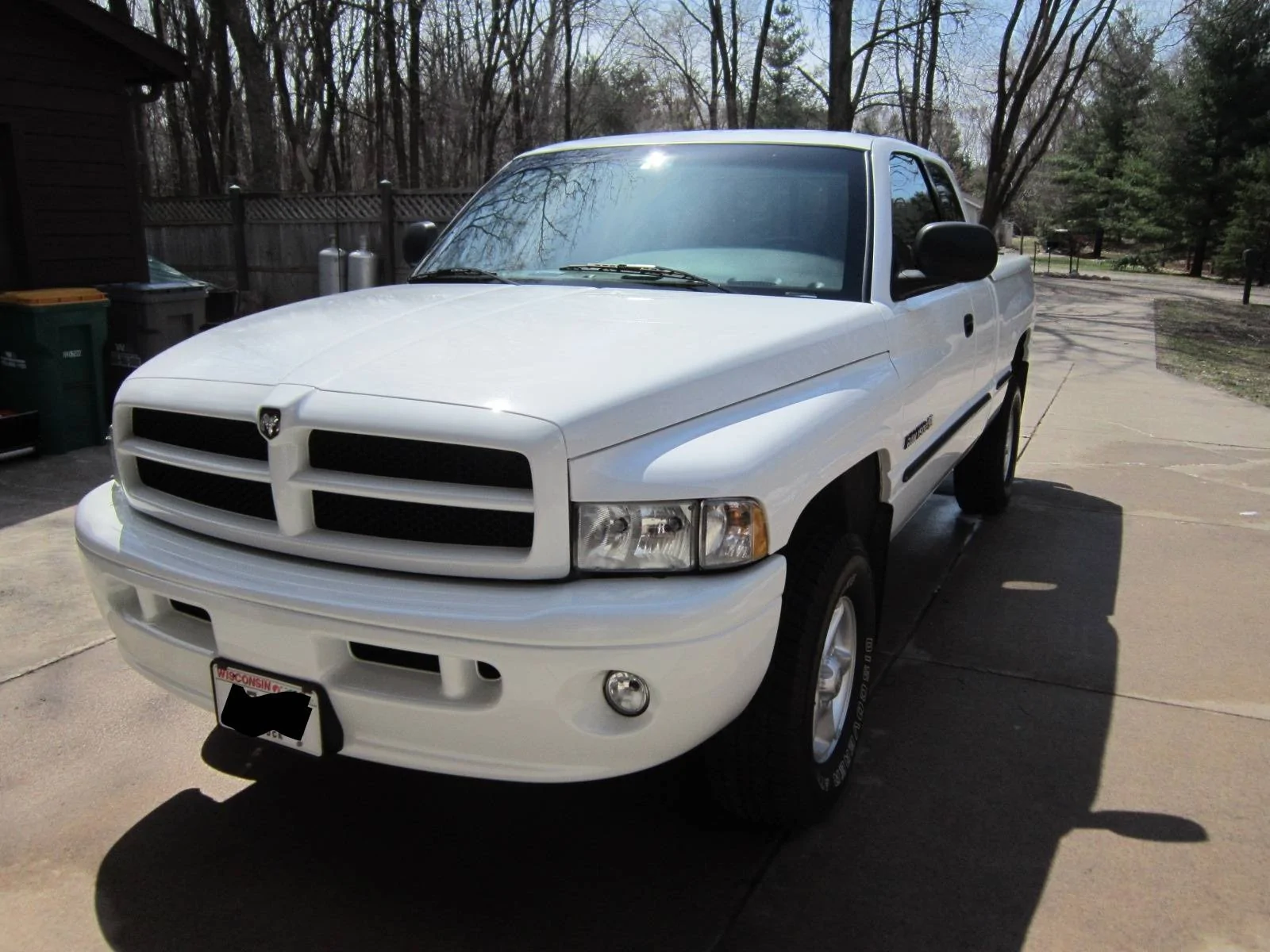

Sold my beloved mint condition 2001 Dodge Ram 1500 I have had since new, to purchase our 2023 Sport Altitude. We didn't order the LED Light Package thinking I could simply replace the stock halogen headlight bulbs with a brighter halogen bulb. Changing bulbs was very easy to do on my truck after I bought it. After perusing the Wrangler's owner's manual, I see it is lengthy task to replace the existing halogen headlight bulbs. Are there even brighter halogen bulbs available to improve the brightness like there used to be? Not really interested in going the LED route at this time. And on the other hand, Jeep made it extremely easy to replace the rear taillight bulbs. Go figure.
