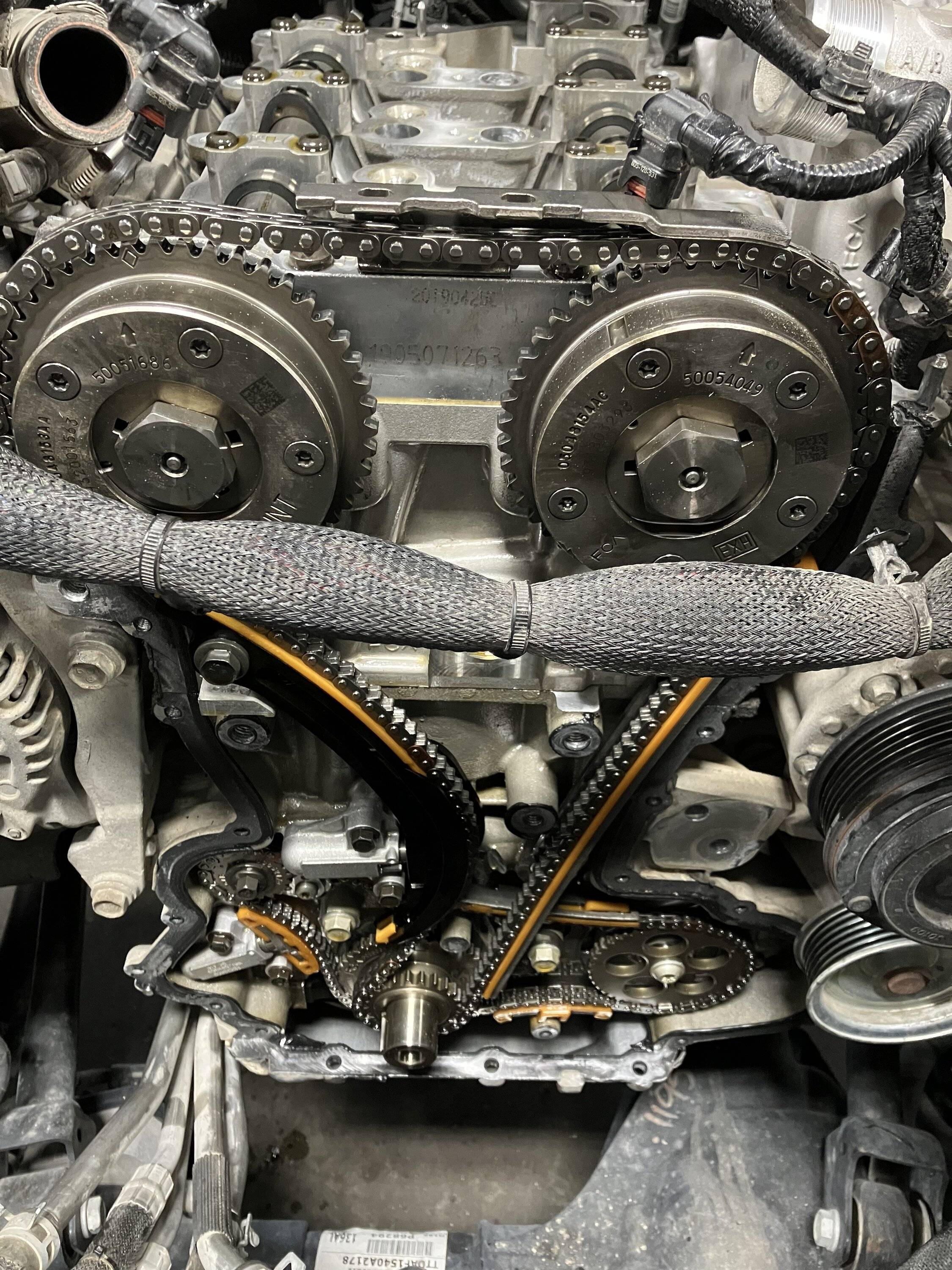

At 50k my timing chain failed, the tapping sound the engine has normally was progressively getting louder, and as the chain developed slack it was slapping the guide that sits just above the driver side Cam sprocket. It was evident I lost tension when I was driving. I don’t think that is the sound you quite have but if that sound gets louder especially around 1,800 rpm (light throttle) I’d get it checked out.
