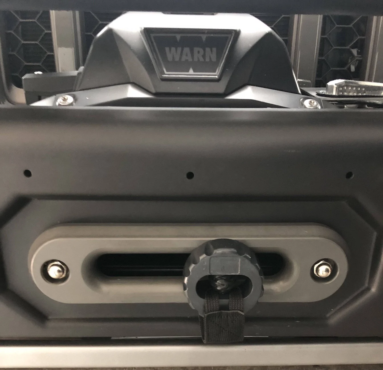

I’ve tried to eliminate any metal other than aluminum pulleys. The MasterPull ABS winch puck is just to keep the synthetic line tensioned and is removed with a pin when the line is in use. I modified the end of the Warn winch line to be a 6” soft eye for attaching soft shackles.

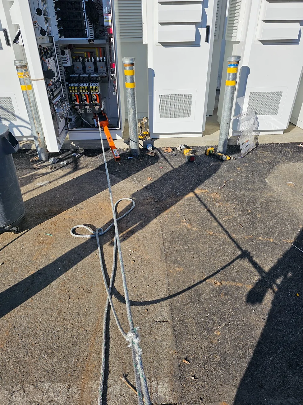

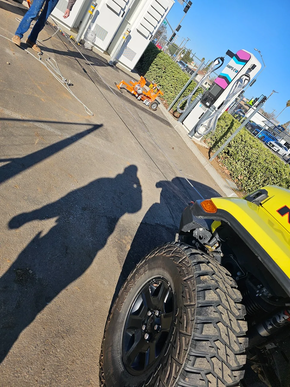

I usually just throw a hoodie or jacket over the line about 10' from the end. The failures I've witnessed are usually the anchor point or the 1st few feet of line that take the most wear and tear. The few lines I've broken fall straight to the ground. Pulling a stuck wire pull that already burnt up the 6k pound tugger I used the same method. Glad I did a the 10k pound pull rope broke a couple times and even the winch hook just hit the ground and slid under the truck. Pulls were hard enough that the truck was sliding forward on asphalt with the brakes on.

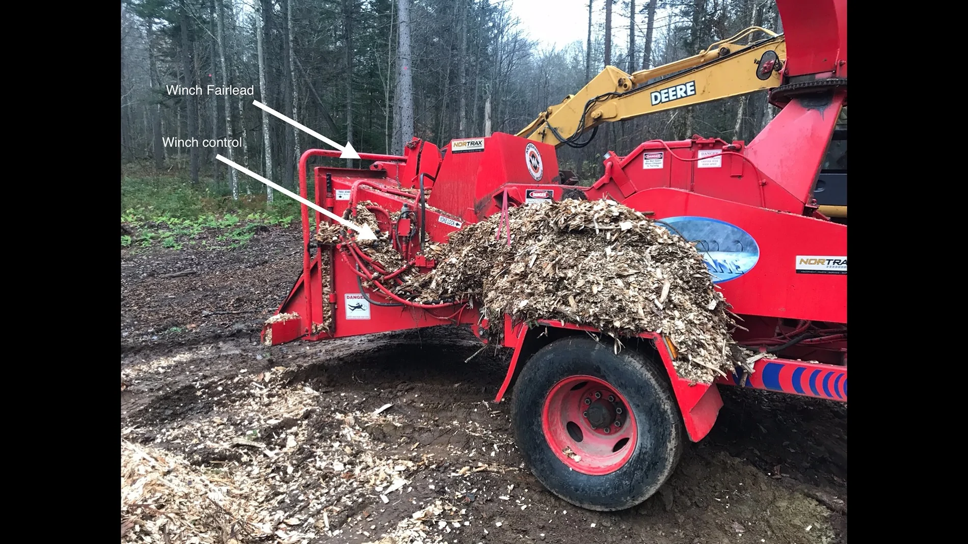

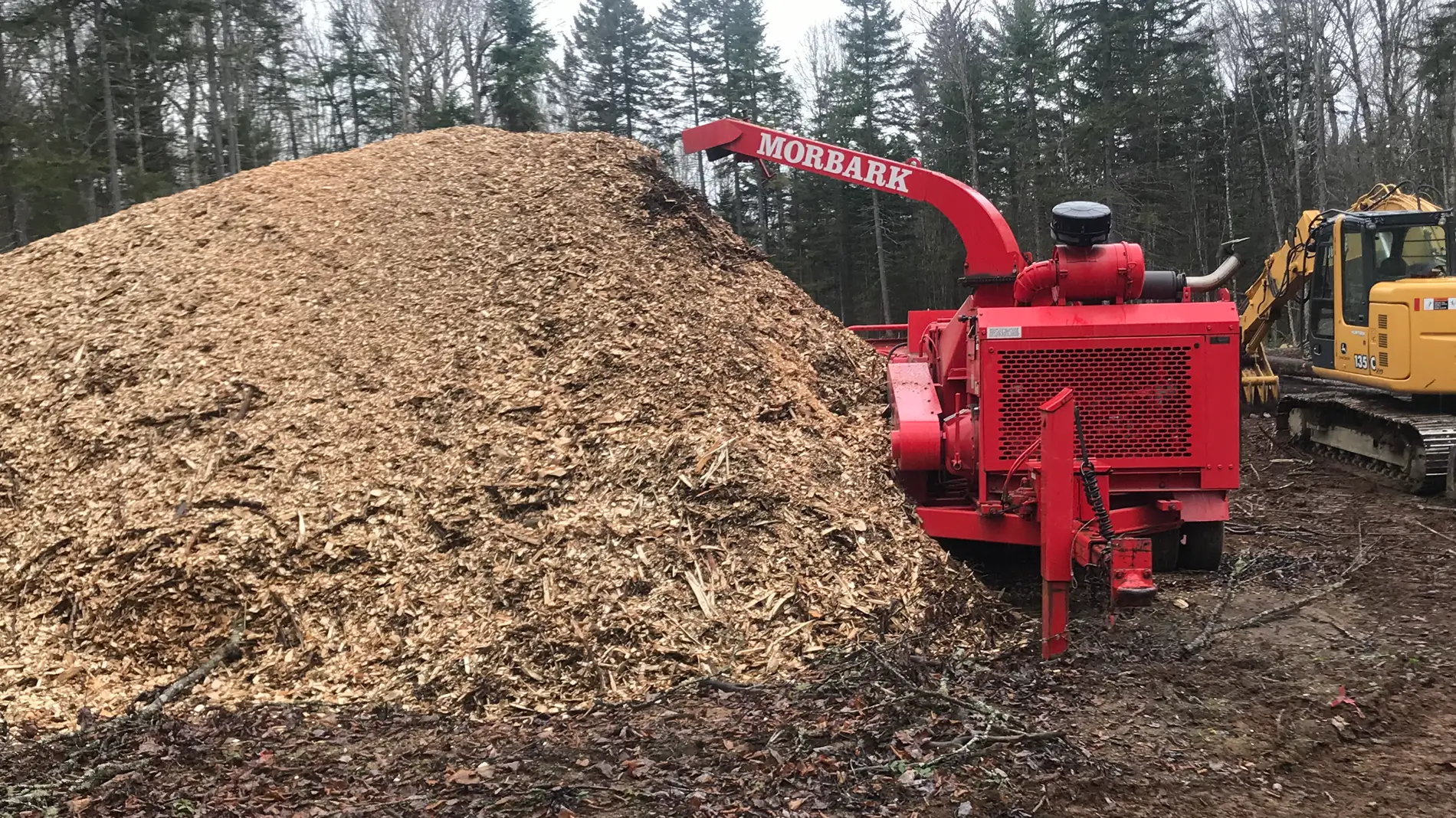

I have a Morbark 2400XL wood chipper that can chip whole trees with an 18 inch stump end. It has a 15k lb hydraulic winch above the infeed. It uses the same size line that comes on most electric winches, 3/8. The line takes more abuse in one day than most average Jeep winch lines will see in their lifetime. The line is used as a choker to pull trees to the chipper so it is constantly be pulled through rocks, dirt, stumps and brush. In order to do its job the chipper needs to be hooked to a piece heavy equipment otherwise the winch will pull the chipper not the trees.
I have broke the line a few dozen times. Usually the line doesn’t just completely snap, it will snap a few strands and it is very noticeable. There is a brief release in tension and usually a shudder in the line, giving a warning to stop pulling. The few times it did completely snap the line sprung back a foot or two before falling to the ground like a wet noodle. The hydraulic controls are maybe 2 feet from the winch fairlead so the operator is in the danger zone for whiplash if it did happen.
I can say I’m completely confident standing near the chipper when a line breaks. Would I stand next to a Jeep during a winching operation? No, because it’s not necessary. I don’t have any steel on my winch lines except for an aluminum snatch ring as a last resort. I wouldn’t fault someone for using a weight blanket on a synthetic winch line, to each their own. I just don’t see it necessary from my personal experience.
