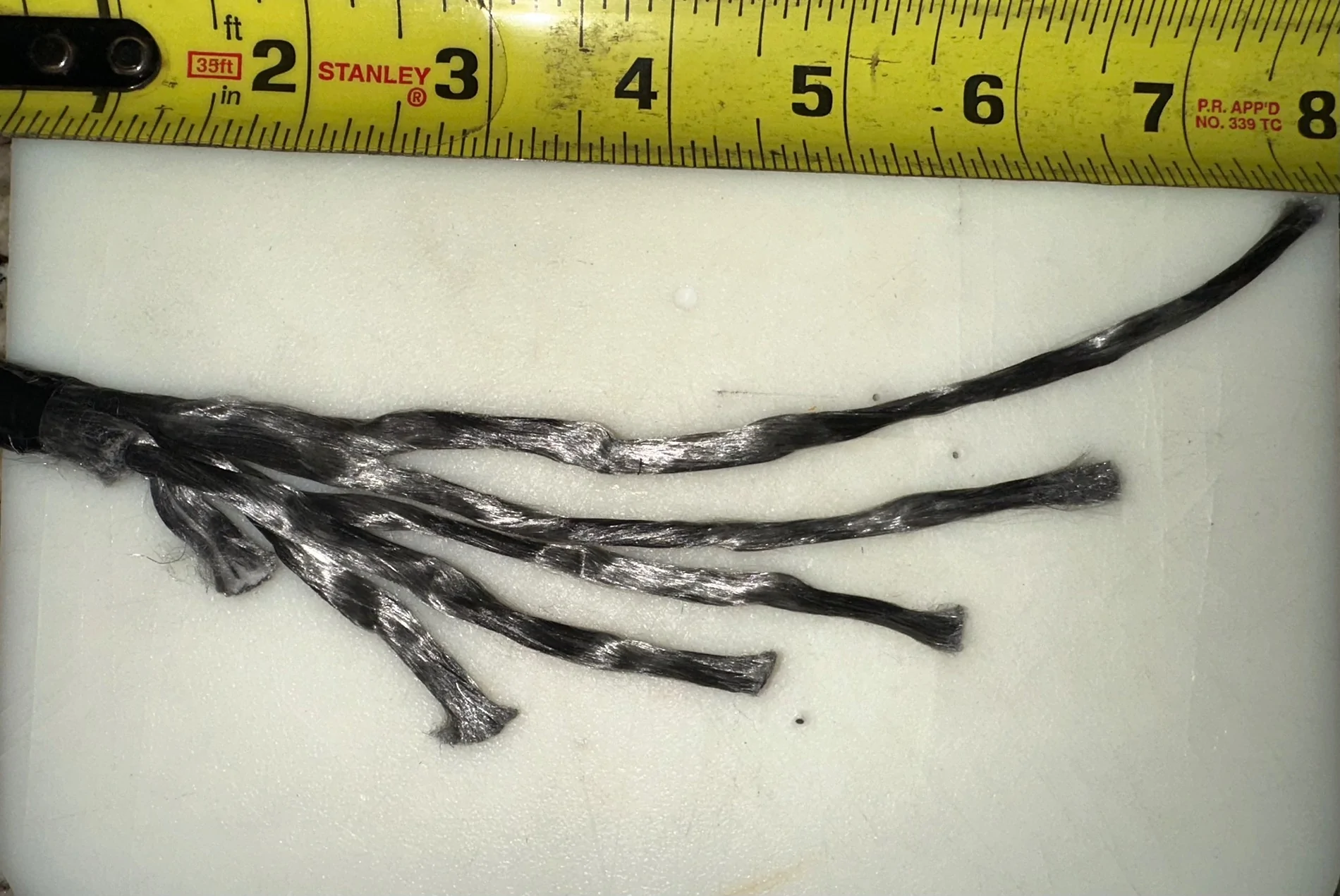

Ignore all the obvious promotional elements in this video. When I unburied my warn winch line I took a pic of how it was tapered.
