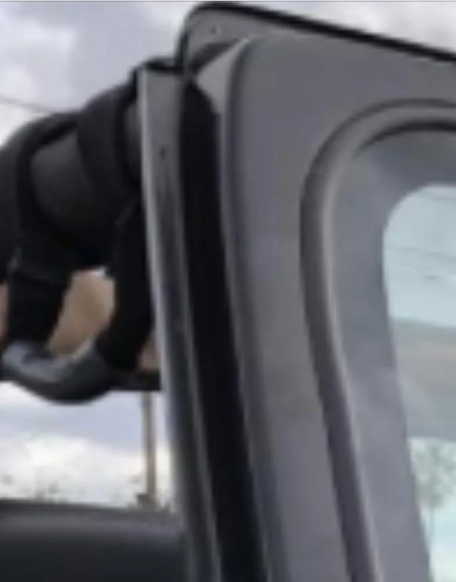

- hot glue gun with the glue sticks
- filled in each end at the front
- drilled a tiny hole in the channel at the rear on each side
- No Drips or water streaming
Applied to HT/ST/Bestop Sunrider

Sorry to bring up an old thread, but, my brand new JL 2 door with soft top does this stream (Not drip or drips - but a steady & constant FLOW of water) into the cabin or on me when it’s rained or raining and the door is open/opened.
None of my JK’s did this - not my ‘12 JK Sport 2 door and not the 18 JKU - with either soft top or hard top. Completely different design with the JL’s. And, we get significant rain here in northern Florida - so I need to make this better.
@jrohan07 - I like your idea the best but for clarification, did you drill your tiny hole in the side of the channel, or, did you come in from the top or bottom to drill your hole? And is this solution still working well?

The tiny hole gets drilled from the bottom of the channel on each corner.
- 1 front left and 1 front right
-1 rear left and 1 rear right
The 4 holes seem to help drain with suction before the channel fills with water and the JEEP's raked front end seems to make the water drain when you open the door.
You should adjust your soft top latches up front as well as re tighten all ST bolts
