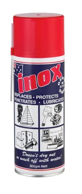

By the way, an excellent product to keep handy is Inox. This product is exceptional and for your hinges, the hoot.
  • Terrific for control cables (example motorcycle, aircraft, etc.)
  • Natural product ..comes only from Australia and actually is gleaned, from would you believe, sheep.
  • Pricey, but you aren't going to beat it!
  • No odor
  • Never drys up
  • Never gums up
  • After application, not visible
  • Never latches onto/ attracts dust dirt
  • Resists water
  • Anti-corrosive
  • Harmless to your vehicles paint job
  • Non-toxic/food based so will not harm crittters such as dogs, etc.
  • Does not wash off with water
  • Displaces water
  • Is a penetrate
Anyway. for me and many I know it is a must have in the shop and on the road. Google Inox..
No, I do not own stock in the company that brings us Inox.

I don't even want to about the extraction process...... :cwl:
Inox is a lanolin derived product.
Lanolin (from Latin lāna 'wool', and oleum 'oil'), also called wool wax or wool grease, is a wax secreted by the sebaceous glands of wool-bearing animals. Lanolin used by humans comes from domestic sheep breeds that are raised specifically for their wool.
