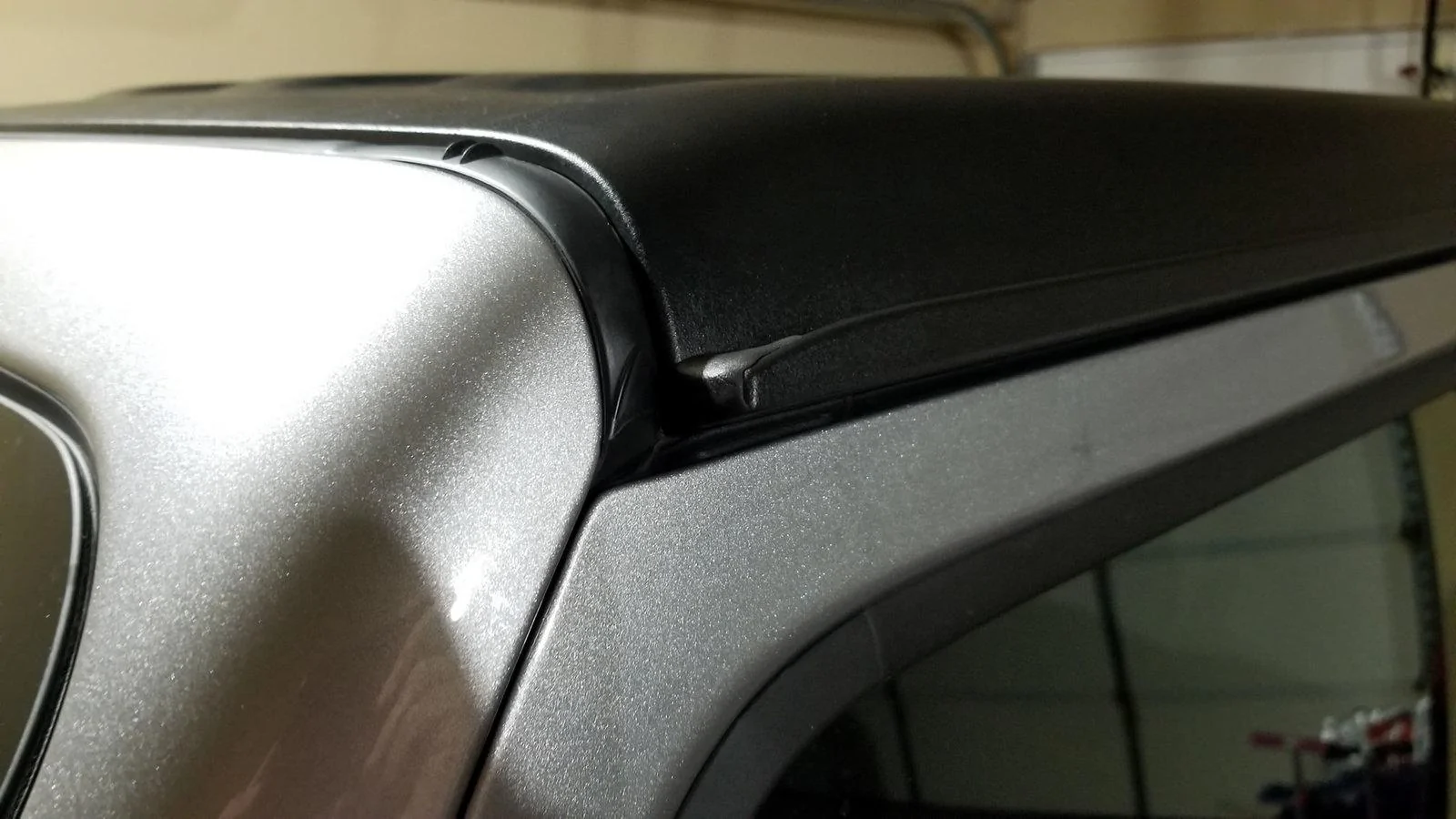

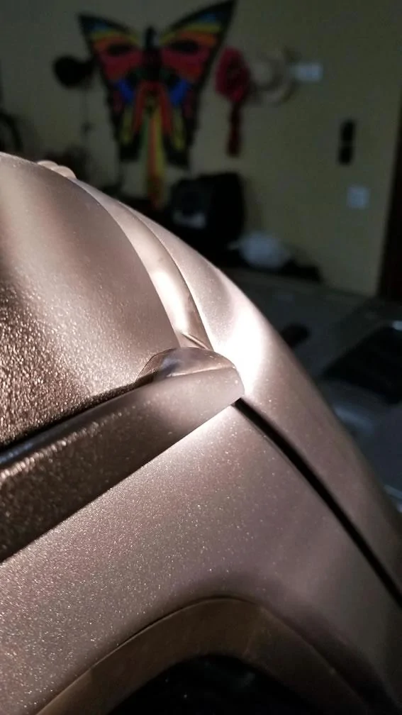

I used a product called "sugru" as some other JLWF member suggested, and it completely solved the issue.
Also, your problem will depend on how inclined your front gutter is, I have seen some JL have more leveled gutters than others.
Jeep Wrangler JL Water streaming into cabin when opening door 20181223_171936
Jeep Wrangler JL Water streaming into cabin when opening door 20181223_175247
Jeep Wrangler JL Water streaming into cabin when opening door 20181223_175401
