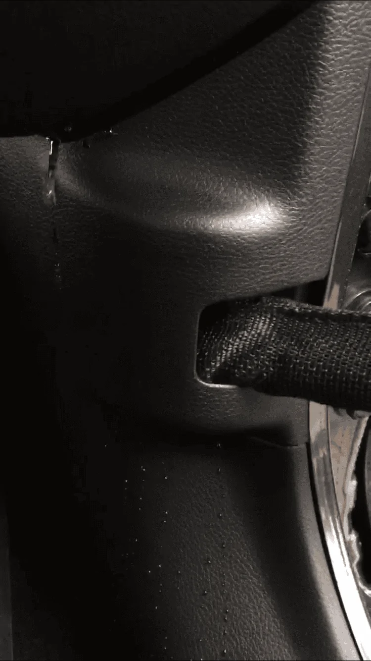

Awesome idea and much easier than a class action lawsuit!!- hot glue gun with the glue sticks
- filled in each end at the front
- drilled a tiny hole in the channel at the rear on each side
- No Drips or water streaming
Applied to HT/ST/Bestop Sunrider
